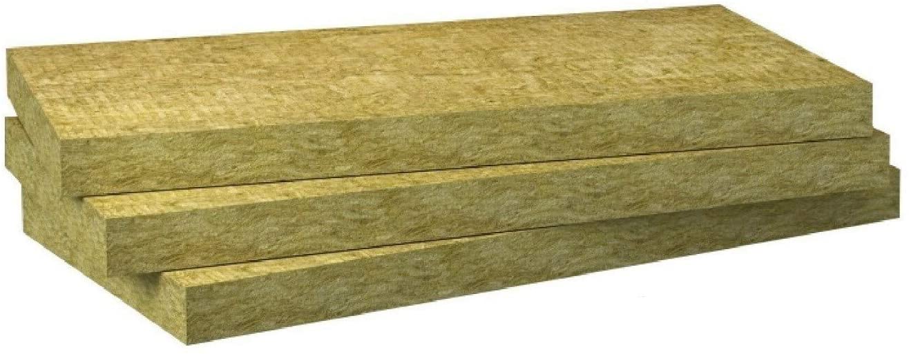

Hi All.
I am just in the middle of a loft extension, the engineer specified Kingspan K103 for insulating the floor beneath the loft room.
I was wondering if there are any other alternatives out that that can be used, can Rockwool RWA45 100mm be used for example ?
Or does it have to be any PIR board ?
Thanks in advance.

Is the loft room going to be habitable or storage?
If habitable then some loft roll or acoustic batts to reduce noise would be good, K103 is for floors with a cold side (ground floor usually)
The insulation is partly for sound insulation and partly to enhance fire resistance of the floor.
Fibreglass or mineral wool quilt usually suffices (not rigid board insulation).
If using the fibreglass for improving fire resistance, it should be supported off steel netting stapled to the joist sides, not just supported off
the ceiling.
I am using Rockwool RW3 for floor sound / thermal insulation on the first floor and the loft floor.

If it is habitable, it will need thermal insulation at roof level i.e. a warm roof, and acoustic insulation at loft floor level.
If it is storage, insulation at loft floor level is thermal. (unless you want to create a warm roof )
First floor insulation is acoustic.
