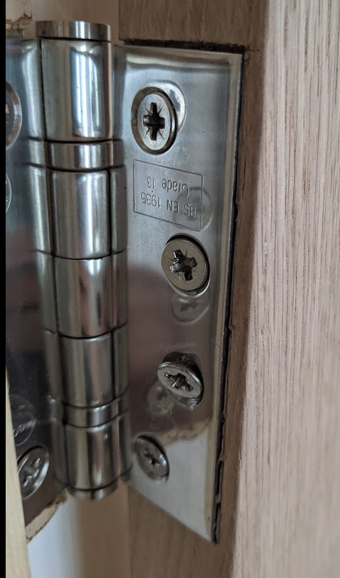

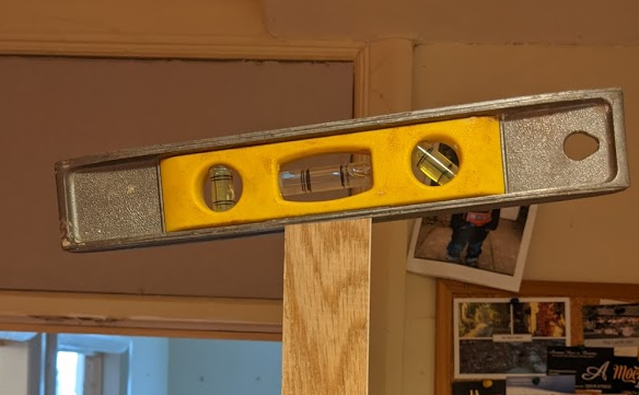

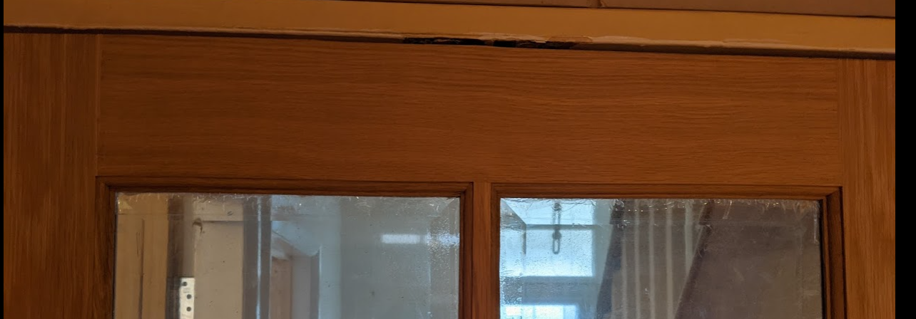

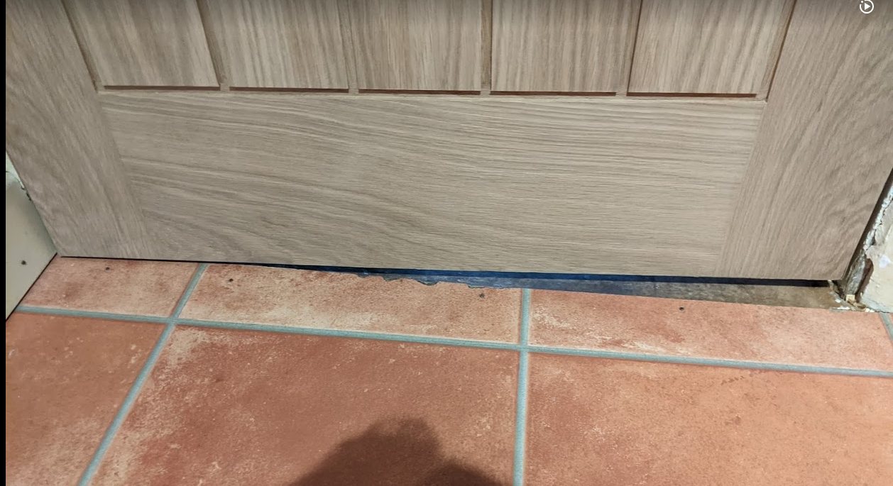

As you can see the but this this one in partic is a prob, the gap and the way it doesn’t follow he line of laminate – I think he’s got a circular saw to it with a straight cut to the top, which has left the top rail visibly wonk, A 10 mm diff from right to left and in my eyes sort of robbed Peter to pay Paul by trimming the top now having a large gap at the bottom. Would it not have been better to plane the bottom incrementally? My wife wants a new door, can’t say I disagree, if so thats 120 quid down.

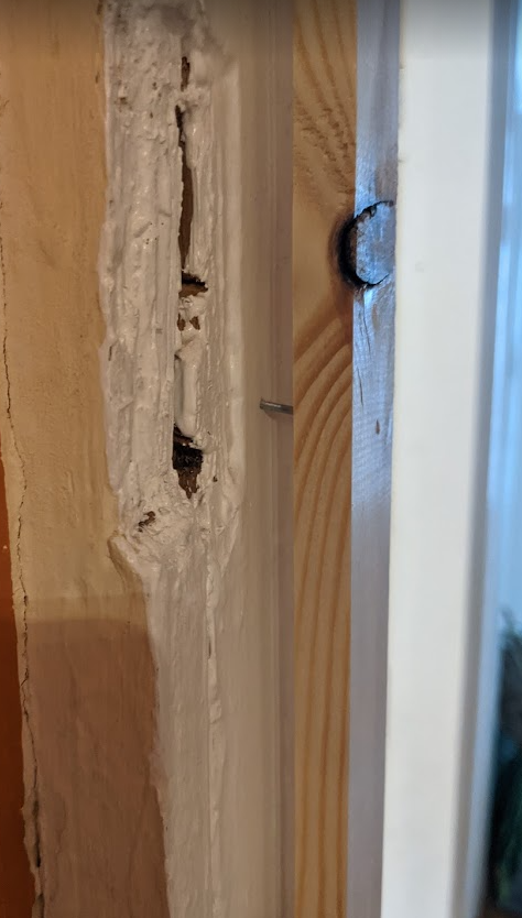

Door linings seem pretty flimsy too. And some screws in wonky.

Fittings veneered oak doors to existing liners is tricky.
Virtually every carpenter these days would do it with a festool track saw.
I would say it's not terrible, but doesn't have the finess of a carpenter that does this all the time and has the skill.
I say it's not terrible as I can't see awful breakout of the veneer, so that's a plus.
tbh there's no excuse for the angle of the top cut unless it's required to fit into an angled top section of the frame. If not required, that's shoddy. As are the screws into the hinge.

You should have run a 2p coin between the door and frame (edge ways not sideways) and if the gap is any bigger, give the clown the coin as payment.
Thanks chaps. At least I got a laugh from your comments :D. ....Yeah, I'll let you know how it goes with sorting them. The chap doing it is a canny lad in fairness, but as you've said I just don't think he's got the skills/insight if frame not plumb that a carpenter or specialist fitter would have for this particular job. (and its a 1930s house - so the frames are challenging for sure) However, generosity aside - that's now a problem for me! So just a case of now negotiating where we go from here.... ! Appreciate the feedback!
