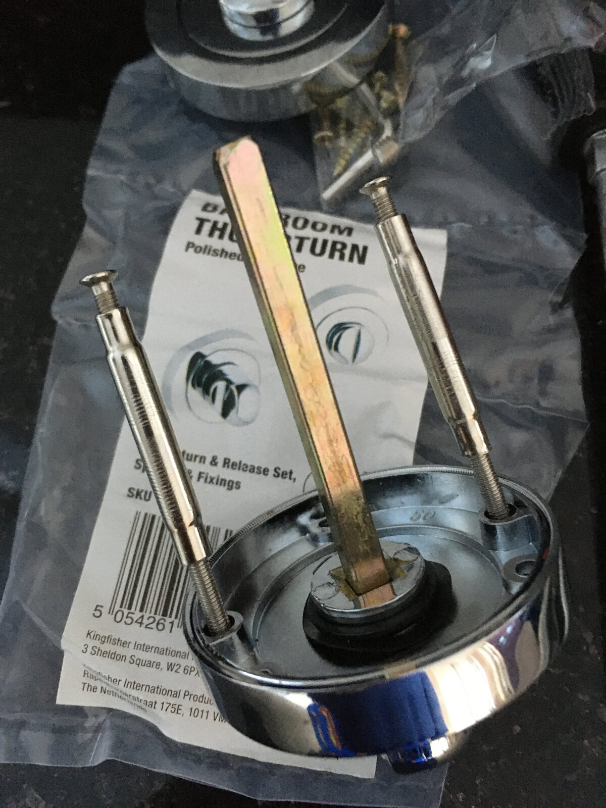

Hello,
I’ve got a new lever on rose door handle as I’m replacing all the old gold backplate handles.
The lever on rose handle is bolt through and comes with 2 screws 1 long and 1 short.
Do I put the short screw in first and get that snug then go from the other side and put the longer screw in or doesn’t it really matter?
Also for the bathroom lever on rose lock the spindle is just a bit too long, what’s the best way to shorten this? I guess a good hack saw?
thanks
Does not matter along as you ensure that the holes through the door are aligned vertically & horizontally so the handles don't jam up on the spindle.
Yes. that's normal. I carry a junior hack saw and a pair of pliers to do the job and a small file to take the burrs off (although the side of an oilstone or even the back kitchen step in some cases can do the same). Take care not to cut it too short - it's easily done

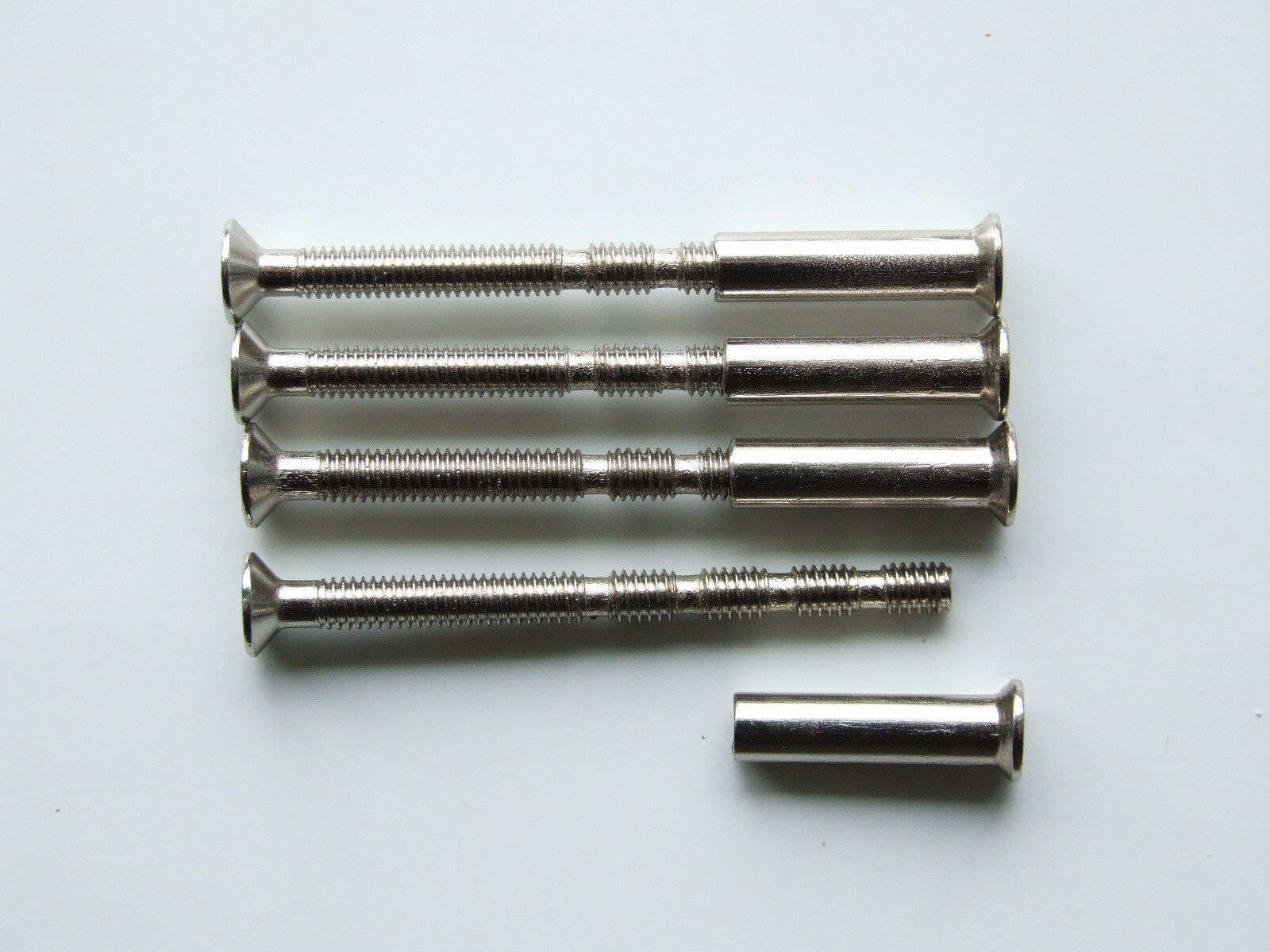

sleeve nuts with matching screws are better than woodscrews.
It’s very similar what comes in the packet.
I’ve added them on the handle whilst the old holes are filled and painted so I don’t lose them

You don’t shorten a few mm , you cut at unthreaded area, the sleeve nut is long enough to accommodate this.
