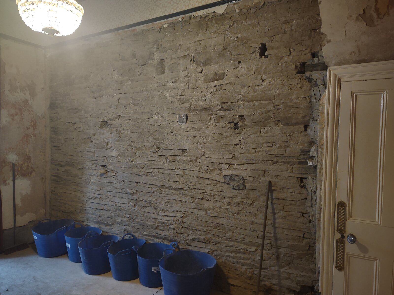

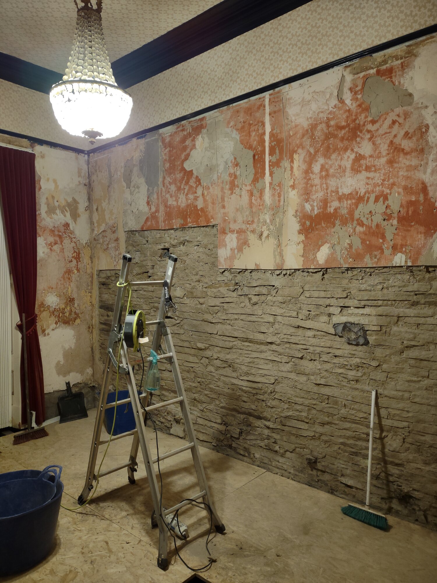

Sorry if I was not clear on my original post. The walls in question are the internal partition walls between rooms, not the internal face of the external walls.
The internal partition walls (pictured) in this house are all solid stone, and are all dry. It is these walls that I am seeking advice on how to best finish them.
The external walls are the ones that are damp, and I know what I will be doing with them once they have been repointed and the roof and gutters made water tight. I will be framing and insulating with breathable insulation, then drylining them.
Exposed stone walls would not be appropriate for this property.

i’d be tempted to leave the internals exposed but brushed repointed and lacquered.
just because they are ‘internal’ won’t stop them suffering rising damp if you do the wrong thing.
Fine. Then why not use the mix I suggested above?
Do you have to hack off all the historic render or could you simply make good to the blown areas?
And, FWIW, why not post pics of the damp affected areas on the external walls?

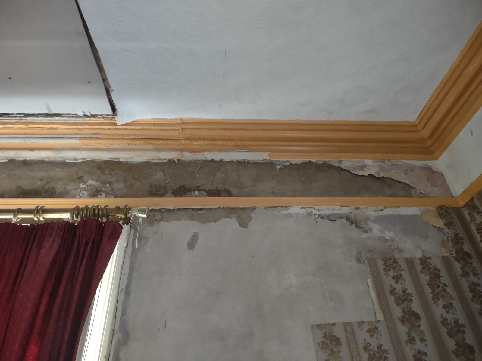

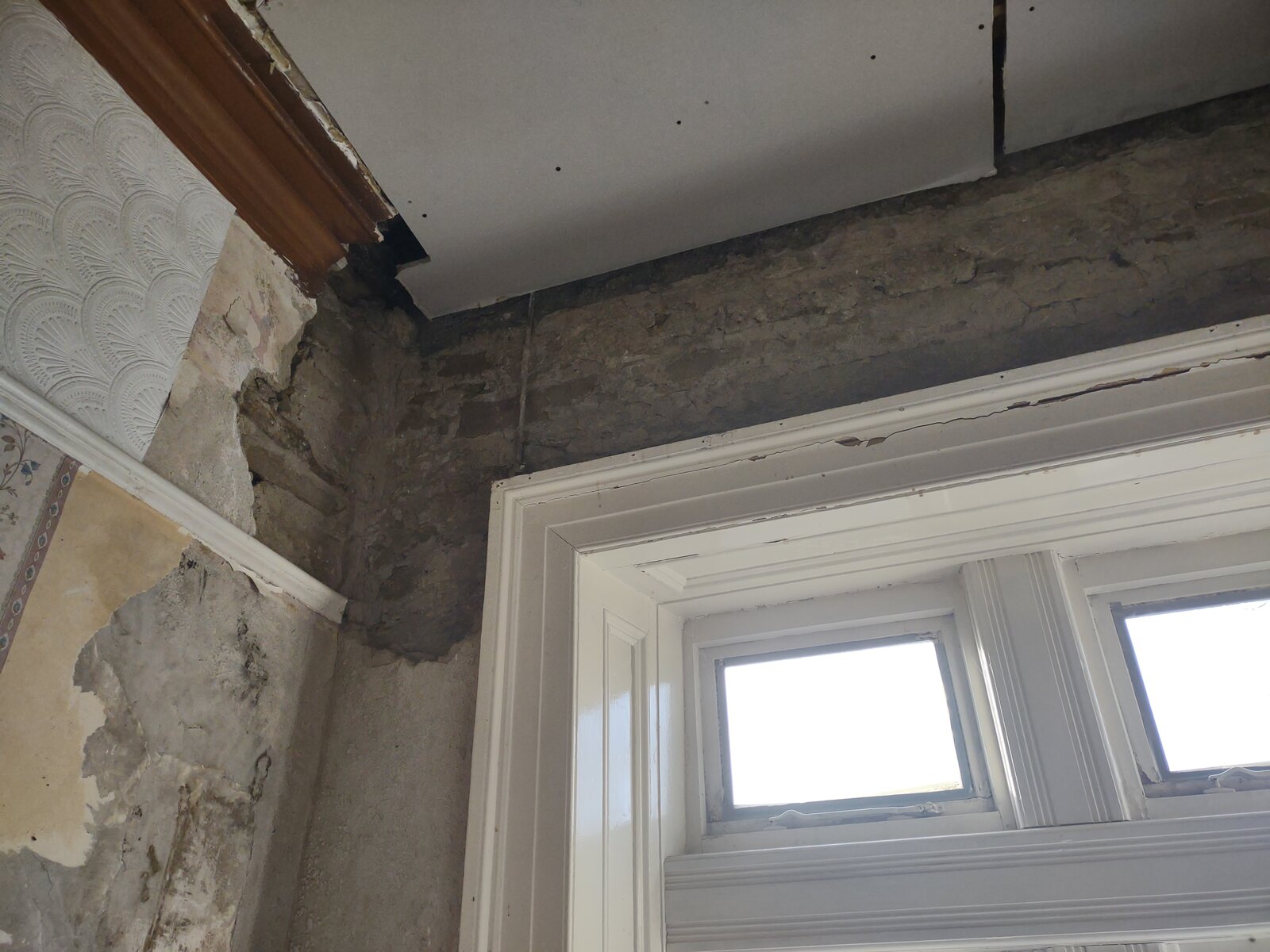

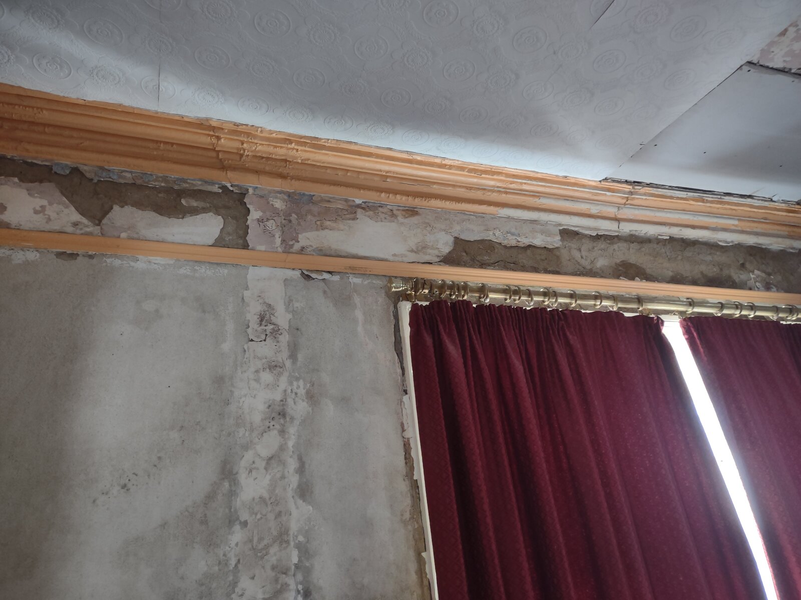

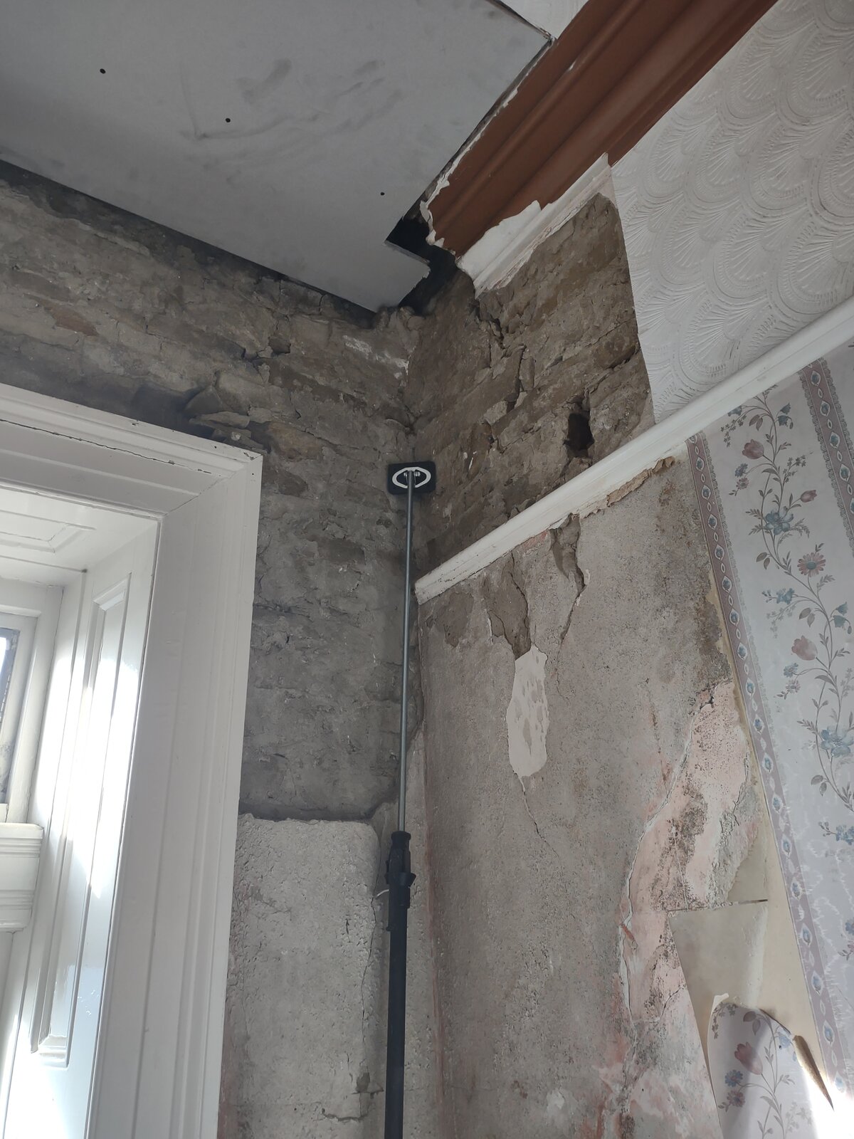

It does seem to pretty shot in most places, and is coming off on large chunks.
If it were solid I'd happily skim over it, but it does seem like most of it will come off.
It's also throwing up some surprises like random concrete, in places, lots of holes, and a few bits of newish plaster.

I wonder if the holes used to have wooden grounds in the for studwork to support L&P or panelling?
I have a neighbour with a flint and lime house, with L&P spaced off the inside. When a wall was repaired, the mason propped that side and left the original L&P in place while working, and tied it back in when rebuilding.
@JohnD That could be. There are quite a few bits of wood scattered through the walls. I just assumed it was later additions that was done when the house was split into two properties by the council in the 60s. They are also pretty randomly scattered.

Take down the recent, badly fixed, ceiling plasterboard - you need to expose whats happening in the ceiling, not to cover it up.
All modern wallpaper esp "plastic" type paper must be stripped.
I assume that the exterior pointing needs raking out to about 30mm, and be re-pointed with a 3:1 mix of sand and lime.
You need to get into the loft and inspect for leaks.
Much of what you show at coving level needs eyes on site to determine if it can be saved in-situ or does it have to be removed and made good?
@tell80 The plasterboard was a temporary fix to get the Mrs off my back after I opened the ceiling up to see what was going on up there.
The roof is coming off in a couple of months and the parapet gutters (which are completely shot) are getting replaced.
Yes, the external walls are also going to get raked and repointed.
The coving looks ok once you scrape the paint off, however, whether I will be able to save it when I take the ceilings down is an other story. A lot of the lathe is rotted around the edges, so it is going to be tricky. Also, the paint used is very thick.
