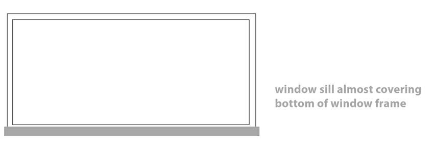

I have a newly plastered window sill (and new window).
The sill is just a bare plastered recess.
I've looked at plastic covered mdf rounded edge board which is 25mm thick and I like it. The problem is that if I use this type of cover, the 25mm thickness will cover most the the bottom of the actual window upvc frame making it look wrong (see attached).
I've also looked at the 9mm upvc sill cover but this has a rounded edge that is suppose to cover an existing wooded sill and if I used this, i'd have a side view of the sill looking right through the curved edge. I don't think it comes with end caps.
Is the 1st option the normal way to fit the sill?
Any advice would be very helpful.
Thank you
Andy
9mm capping board does come with end caps
Yes you can get both round or square edge board and end caps for both.
If you go for wood-grain effect you may not be able to get matching wood-grain endcaps though. Just flat plastic in a similar colour and fitting them neatly is a skilled art.
