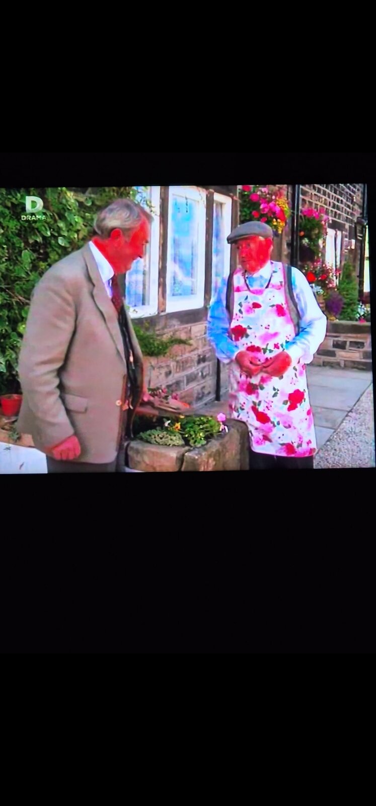

I did some work for a good friend recently.
His Samsung TV, randomly, makes everyone look red but only when watching terrestrial TV. He can be watching HMDI sources and switch to terrestrial and all of a sudden, every on the TV looks like a very, very angry umpa lumpa.
The above is a whatsApp image that he sent he sent me.
The TV is a Samsung QE43Q60RATXXU
He said that it happened first happened whilst under warranty. An engineer turned up and fixed it by swapping out a component.
The TV is no longer under warranty.
As I said, it only happens on terrestrial. He says that if he turns it off for a while it sorts itself out.
He is happy to open it up and replace parts as required. I suggested that it may, possibly, be down to the RF modulator, but I added that it is beyond my ken and told him that I would defer to the sages that occupy this tiny corner of the web.
He has one other TV that uses the same aerial. It is fine.
Help will be greatly appreciated. Thanks.

It has nothing to do with reception, the aerial etc. and it will not have a modulator in it, rather it will be a fault around the demodulator, if other inputs work fine. Modern TV's use a single PCB usually, so it will be a case of swapping that out, unless you can trace it down to component level.
As the red areas are specifically targeting skin tone areas, it looks as if it is an automatic function and the process may be playing up.
Has he got/adjusted the 'Flesh Tone' function?

The random part and only affecting skin tones, is why I suspect it is a software/hardware glitch - but I will definitely defer to @Lucid for this one! :)

Most TVs nowadays apply settings on a per input basis. So worth a check.
Check if it happens on both SD channels 1,2,3,4 (MPEG coding) and HD channels 101, 102, 103, 104 H.264). Drama is a SD only channel on Freeview.
It appears to have satellite tuners as well as terrestrial (Freeview) - are they the same? (Assuming a suitable sat dish connection is available to check).
If the TV has another spare hdmi input, then a Freeview Play PVR or Freeview set top box tuner would get round the "faulty" tuner-demodulator-decoder-RGB/YUV circuitry for that 'input' on the set. (The TV and Sat tuner modules are all in one 'can' on a spare parts website I found.)
Do check the set's firmware is up to date https://www.samsung.com/uk/support/model/QE43Q60RATXXU/ - especially if not routinely connected to the internet.
May be worth calling Samsung support as they can do some remote fault diagnosis if there is an internet connection to the TV.

You/he, could try spraying the freezer spray around the components, to see what makes a difference - you said it seems to be temperature related, clear after being off for a while.
Reply from my cousin .
We used to get this effect when the tcon gamma correction chip failed on the early LCD tvs , but not seen it on modern type . I will check with Samsung of any known issues.
Can u ask him to look in customer menu and see which version of software is running ?
