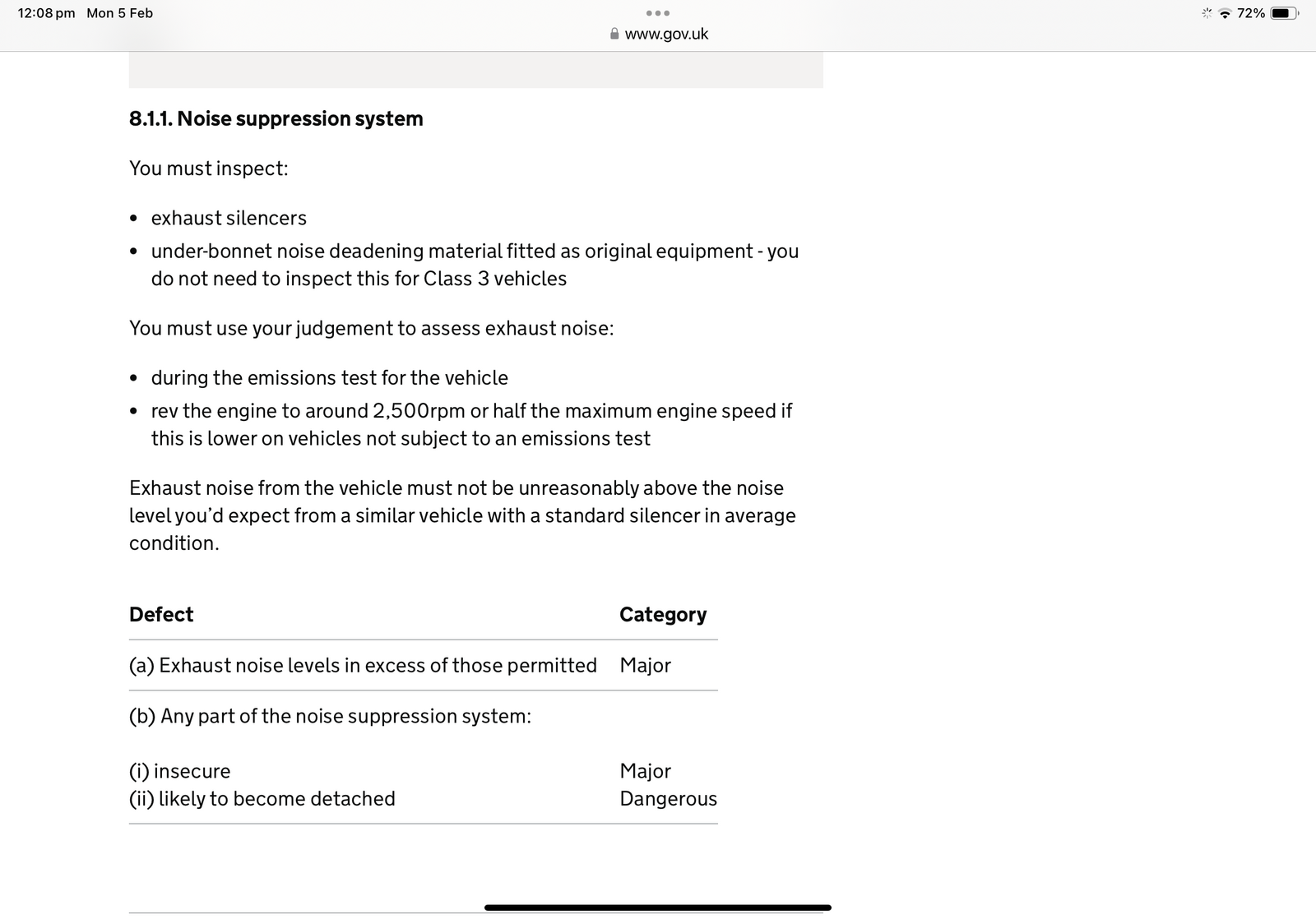

Essential if you have a keen-eyed mot tester as they are part of the mot these days. If it’s missing, it’s a fail.
You can remove it, if you're not bothered by a bit of extra mechanical noise outside the car.
You can't. Not without the possibility of a fail, come the next mot.

Blimey! Really? They make very little difference and a car with one removed, would still be well within minimum noise requirements under UK legislation!
Reading that then, if I took the mat off and stuck it in the boot, that would not be a fail because:
- it was available to be inspected, and
- it was not insecure
Probably. Unless the tester can say that it is standard on that vehicle. You can do that with lights, windscreens and seats. Then the screen, wipers, washers, seat belts, lights cannot be tested - or failed!
That's really surprised me! Ordinarily, most things on the MOT are a pretty low bar. Brakes have to be well below par to fail. Emissions too. Silencers can be pretty noisy before they fail the subjective noise test. The idea that I could fit a cherry bomb silencer in place of my back box, and (probably) still pass the subjective noise test, but if it even looked like my underbonnet sound deadening pad might fall off, it should fail, is nuts! In reality, he'd never be able to hear the difference if I DID take the sound deadening off, but would definitely hear if I took one silencer out.
And then the icing on the cake, is that "insecure" and "likely to become detached" are "major" and "dangerous", respectively?! I am genuinely gobsmacked....
However, it doesn't say:
"insecure,
likely to become detached,
missing altogether"... ;)
