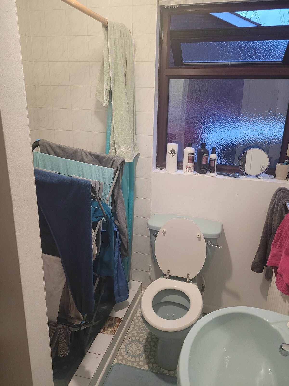

Is it okay to dry clothes in a small confined space with window open or will it still cause damp/condensation?
Yes, it's a bathroom. It gets full of moisture daily. It's more to do with the time of the year, ventilation/insulation and ambient temperatures.
You could dry clothes indoors in the middle of the summer, in any room - no dramas. Do the same thing in the dead of winter on a freezing day however...
As long as there's ventilation, I can’t see it being a problem. Is This any good for you?
Do you mean health wise or practicality wise? We just got a new shed and are waiting to get electricity out there. Health wise I don't know. Curiosity got the better of me so this is why I asked
You need at least two windows, at opposite ends of the room. You'll still get damp and mould with one window open.
If you're also heating the room then it will be expensive.
A heat pump tumble dryer is the best option in the winter.
If you have a gap under your bathroom door, this is absolutely fine.
We dry our walking boots and jackets in the bathroom. Rather than have the fan running, we open the window and shut the door. I can feel the suction of air under the door as the moisture is pulled from the room. Don't get a spec of mould in there, and the room is 50% external solid brick.
If you're passively ventilating then you have no control over whether the air blows in or out of the door. The damp air is as likely to be blowing into the rest of the house as it is to blow out of the window.
Either way, you will be continually losing heat.
It's much more efficient to keep the house warm and dry and pay 20p a load to tumble dry it, safely pumping all the condensed water down the drain instead of dispersing it all over the house.
