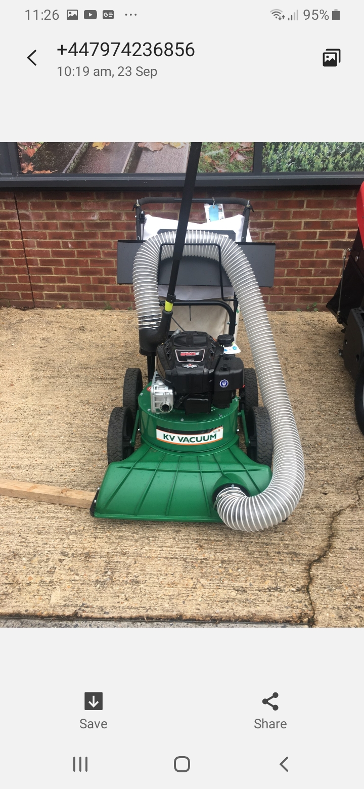

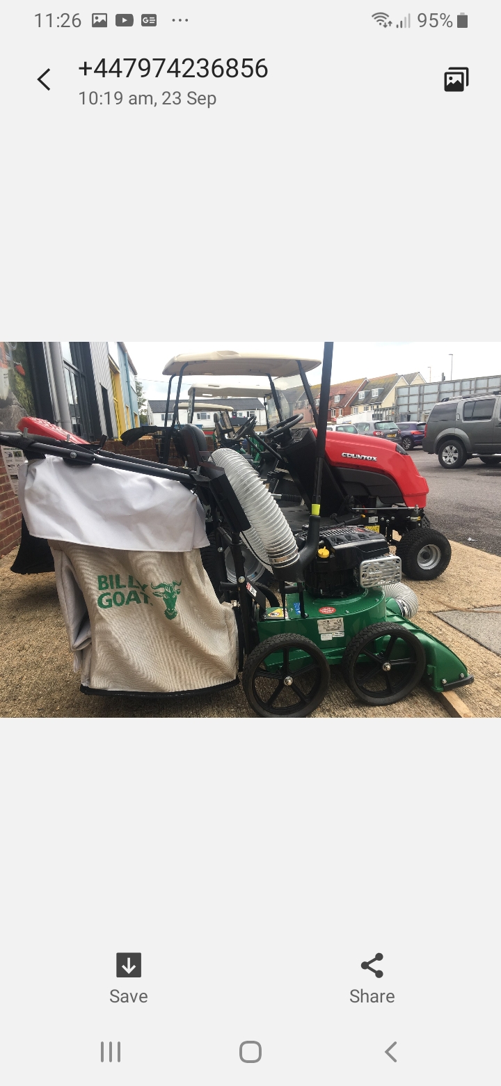

If I buy a Billy goat vac, can i use it on concrete block paving and beds and grass? I checked them out. They're £1000 minimum
Maybe I could hire one to test it out. This could be a game changer for my breathing dust and leaf clearing
Yeah emptying dust! Hold your breath I guess

That Billygoat is a newer version of mine - basically you can use the flexible hose for cleaning or the front scoop for broader sweeps....there's a plate on the bottom that is fixed for the former, removed for the latter. The front scoop can be lowered or lifted. The bag is huge and has a nylon zip which allows emptying.
It will pick up cans and bottles as well as twigs and they'll all be pulverised by the impeller below the engine.
It's a very effective machine but takes up a lot of storage space - if it can be justified then go for it! Mine hires well in the autumn but is generally a garage ornament for most of the year :(
The machine can tend to wander courtesy of its own inertia when using the flexy hose so I bought some wheelchair brakes from ebay and fixed them on.
