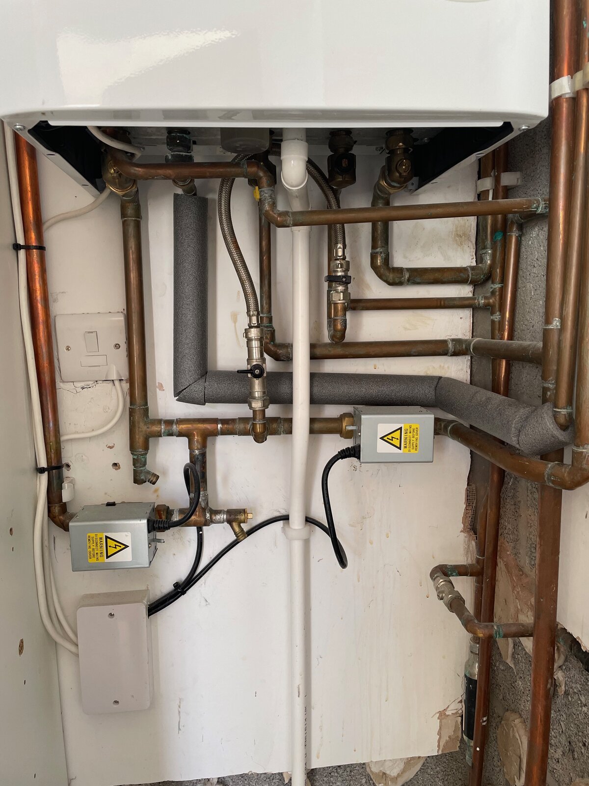

I have a combi boiler that has no mag filter and the heat exchanger is getting full of crap from the system, which is costing me money (about £130) to get cleaned every year. I had a couple of plumbers round, one said he could fit mag filter for £300, which I assume would be on the flow, since the return pipe is tucked up in the corner and is not accessible to fit a filter. Another plumber quoted me about £850 to remove the boiler off the wall, and move the pipework so a filter can be put on the return (plus a new flue and flush). I'm not sure if its worth spending that much to get the filter on the return ("optimal" according to magnaclean) rather than the flow ("acceptable" according to magnaclean, but not my plumber!) ? Thoughts?

Certainly don’t need to remove the boiler off the wall to get it on the return, but some piping will need rearranging.
easy to fit on the flow and it will collect some dirt .
I fitted my magna clean on the flow, which is acceptable according to magna clean instructions, because I couldn't get it on the return. Obviously the return is better because it gets the crap before it hits the boiler but mine picks up a lot of rubbish where it is on my old CH system so thats all good as far as I am concerned. I give it a clean every few months or so, mainly when I remember.
It looks do-able to fit it on the return, with a bit of effort, but I would ask why you are needing to have it cleaned every year at all? Are they not adding inhibitor and cleaning it? Are they not cleaning it adequately?

2 plumbers have told me its not possible to fit a filter on the return (top right in the pic) without alot of moving of pipework
