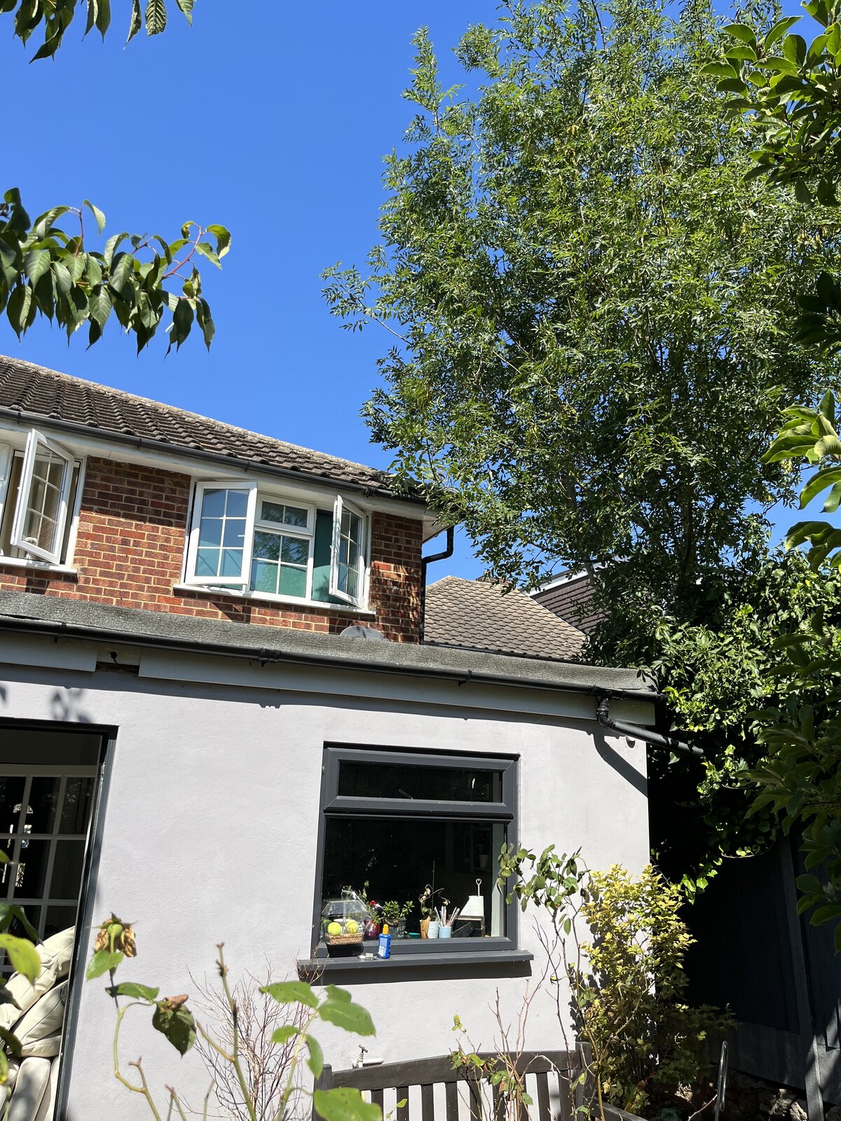

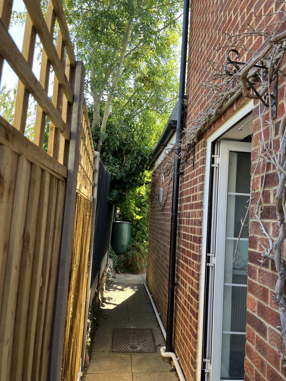

Here you go HERTS

Definitely quite a young tree - if younger than the extension get rid of it if possible. Hope you get on well with your neighbours ;)
Tell your neighbour that the tree is affecting your foundation and will in time affect theirs. Ask them to have it removed and offer to pay half.

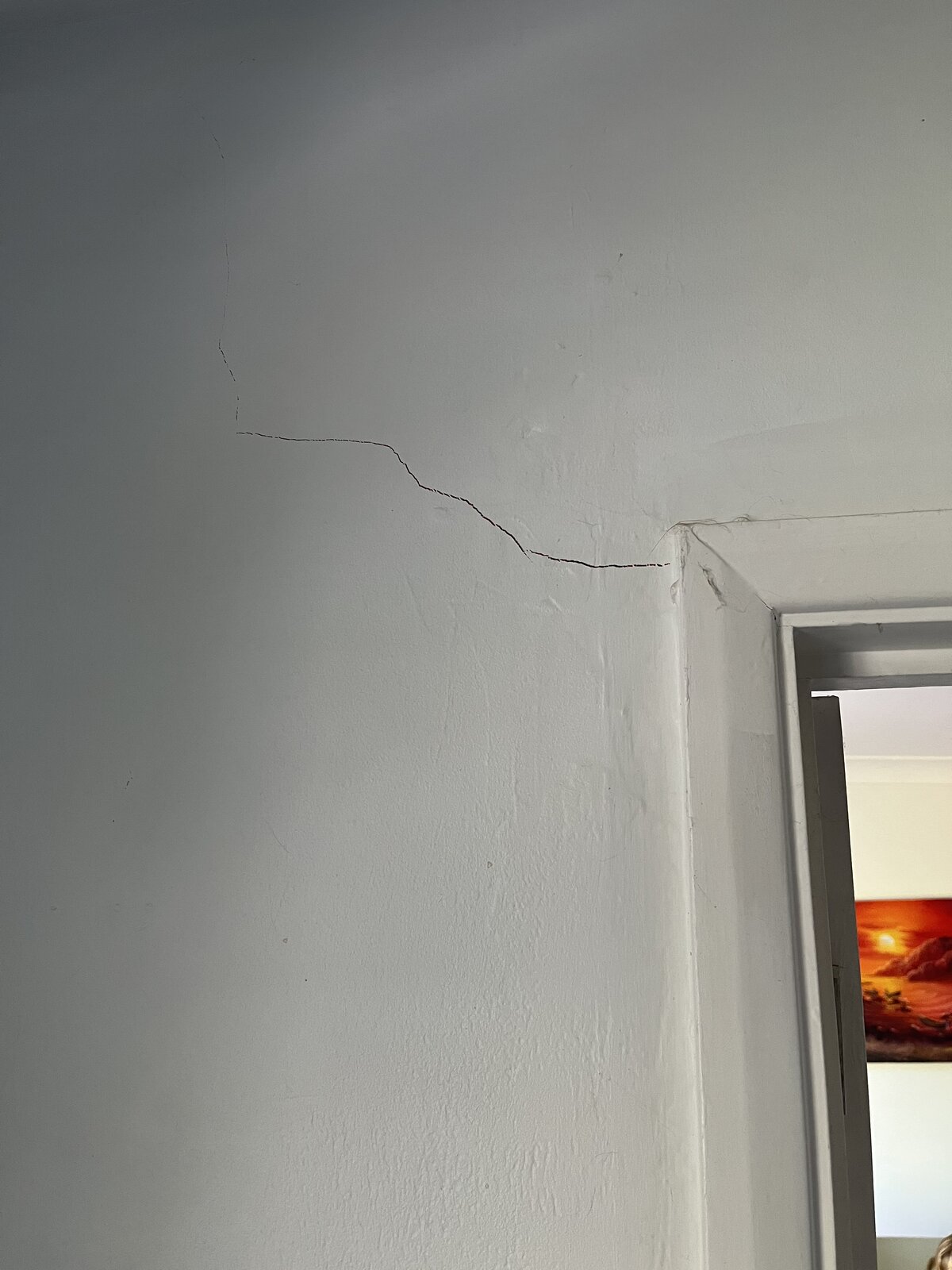

Any cracking inside the house. Some minor cracking like that could be shrinkage of the clay but the extension is not going to fall down. Rake out the joints, re point and report back in 5 years

Thank you- yes a crack has appeared in the doorframe that splits the extension in two.
Here is the picture.
