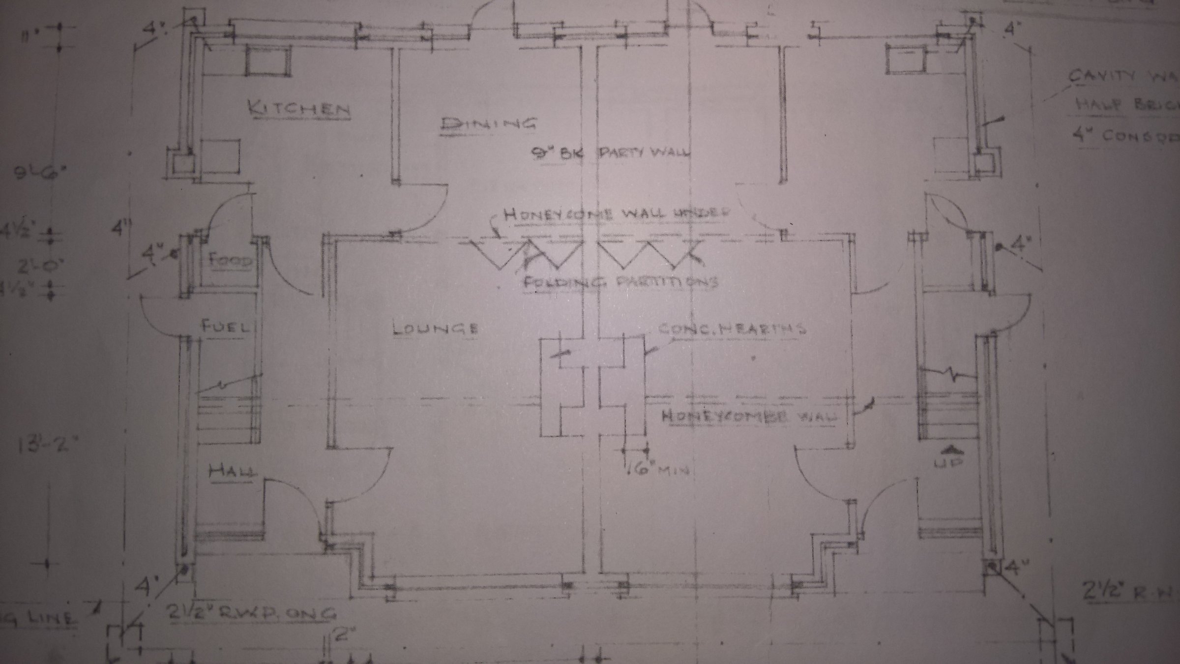

Hi All,
I have manged to get the plans of my 1950's semi detached. Can anyone tell me if they think the kitchen wall between the dining room is a load bearing wall - the one on the far left? It is offset to the main hallway wall.

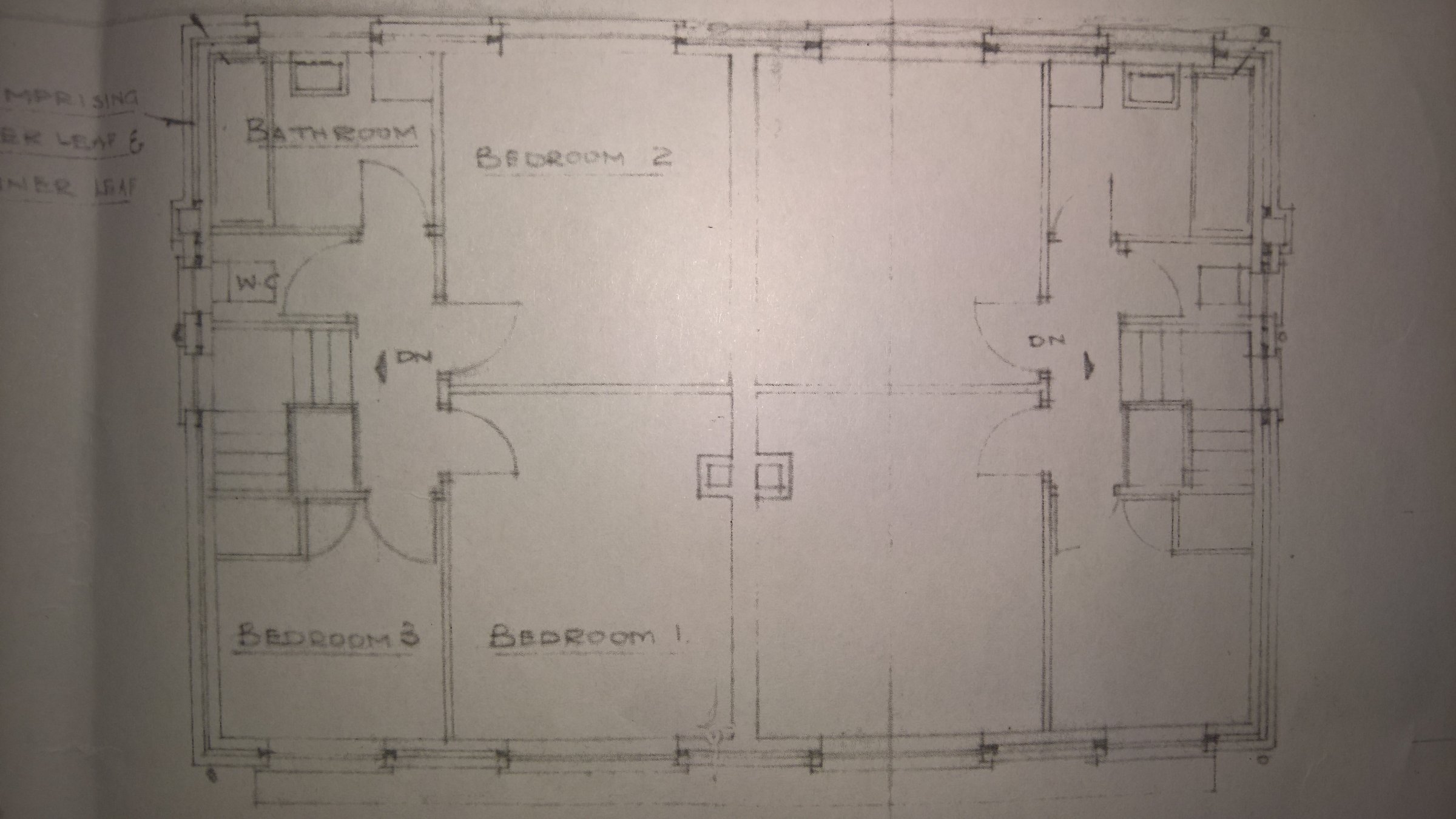

Got the upstairs drawings:
Not sure if it helps but the bathroom wall is 220cm away from the side of the house, the dinining room / kitchen wall is 280cm away from the side of the house so they are not on top of each other:
Regardless of where the dividing wall is upstairs, if the floor joists are running onto the wall, it will be load-bearing.
Check the floorboards in either your bathroom(under the bath?) or bedroom 2. The joists will be at right angles to them, if they are parallel with that wall then you could be in luck.
Frank
You muppets, drill a boomin hole in the ceiling, stick your hand in, have a grope around, jobs a goodun. If he's gonna be ripping the wall down then a hole in the ceiling next to the wall can just be patched when the rest is done.
