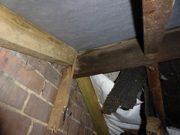

I had a rotten rafter on a small outhouse roof. The rafter was the closest to the house wall, and water had come in through the cement which was in place rather than lead flashing.
The repair was to replace the rafter, install lead flashing, re-felt and fix a new ceiling.
I was a bit sceptical of the man doing the work but we took him on because he was a known roofer and would do the job for cheaper as he is a neighbour of a relative.

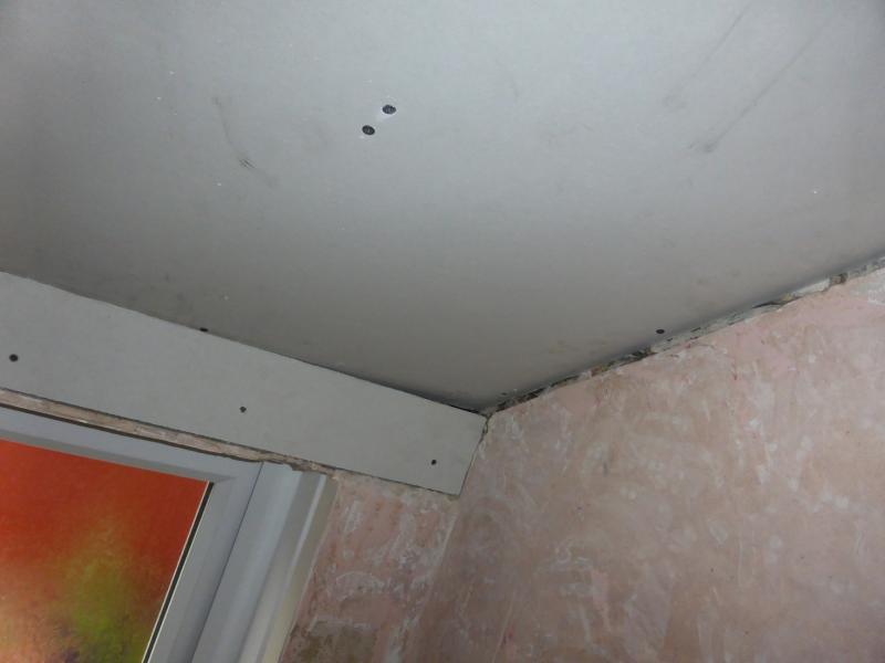

The result is a wonky ceiling. I challenged this and he said that it must have always been this way (it always looked ok to me). The roof has settled and now its not even, the ceiling could be packaged out. I can't see how this is the case. The only uneven bit of the ceiling is where it attaches to the new rafter. You can see in the photograph where the wall was plastered up to the old ceiling. This leads me to think that the rafter is at the wrong angle.

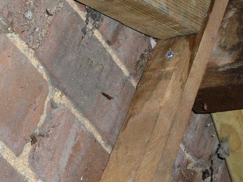

I had a look through a vent hole in a ceiling which lets me see in to the roof space. I am not sure the way that he has joined the rafter to the ridge beam is particularly sturdy. There are no nails through the rafter in to the beam and the rafter is not attached to the wall. I am worried that it is not actually supporting anything. If the roof becomes covered in snow the weight may push it out of place.
