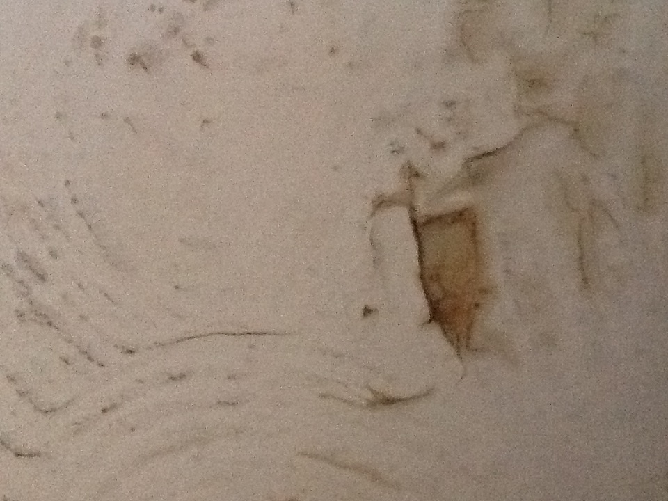

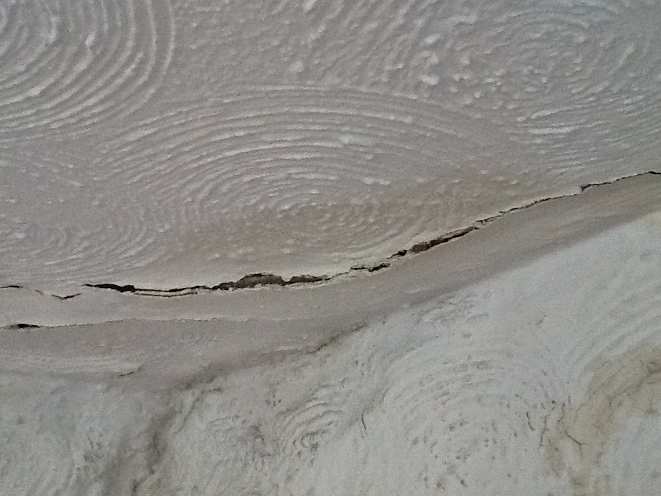

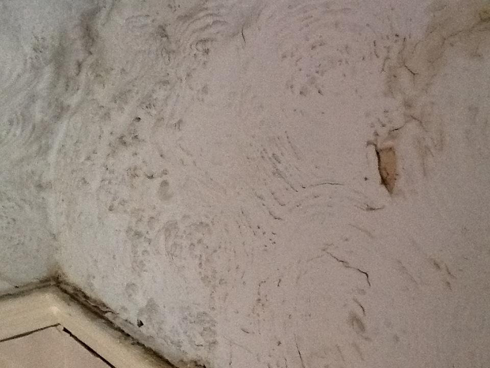

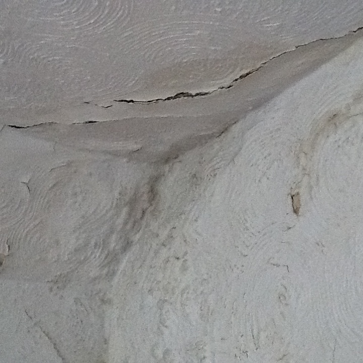

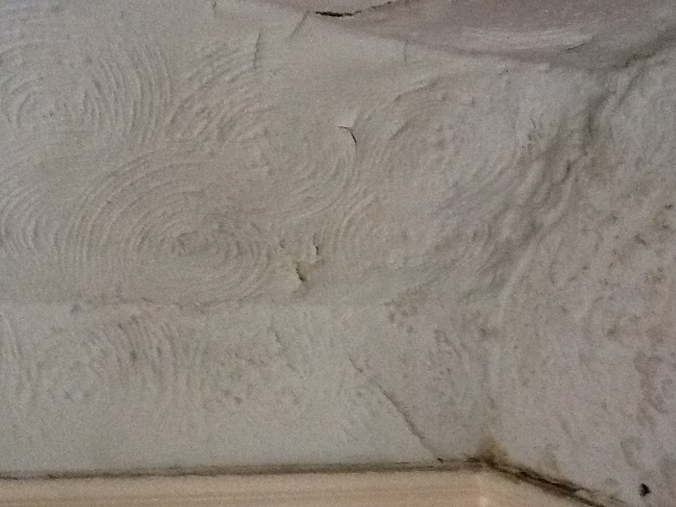

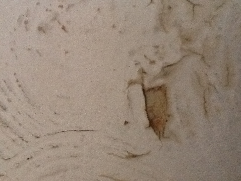

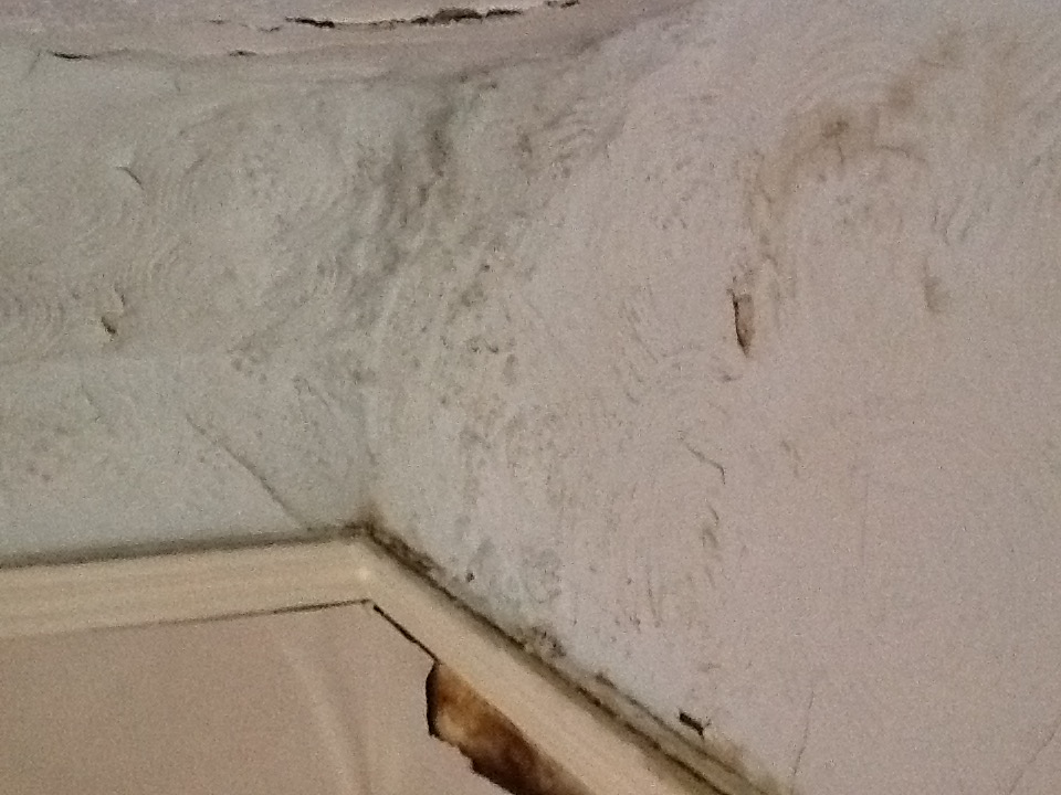

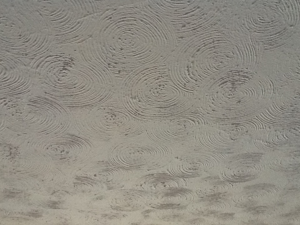

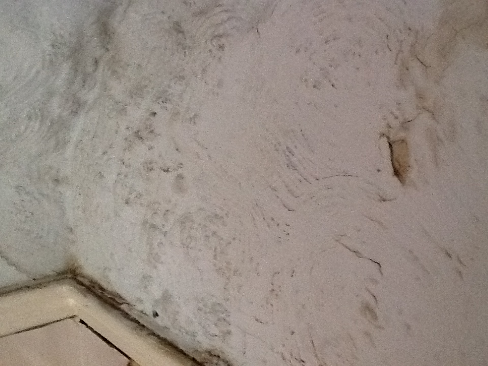

Hi,
I have rented a room with the corner of the ceiling flood damaged (not recent). Please see photos. Is this artex or textured plaster? The cottage is possibly 1890s and this is the only ceiling with this finish. I was told by asbestos co it's not a typical artex finish (sent photo), but should test to be sure. Lath and plaster also mentioned by someone at council who thought it could be asbestos. I have asthma and would rather not chance there being asbestos fibres in bedroom as they are too small to be hoovered up (pass through), and could still be in situ. Please reply as soon as possible. Thank you ever so much.

Sorry, but it's difficult to tell from a photo, and really needs a sample being set off for testing. I would be more inclined to think it was plaster, but better to play safe If you're that concerned. If it has to come off, the safest way is to steam and scrape it off, but you should wear a good quality face mask, not a cheap throwaway one.

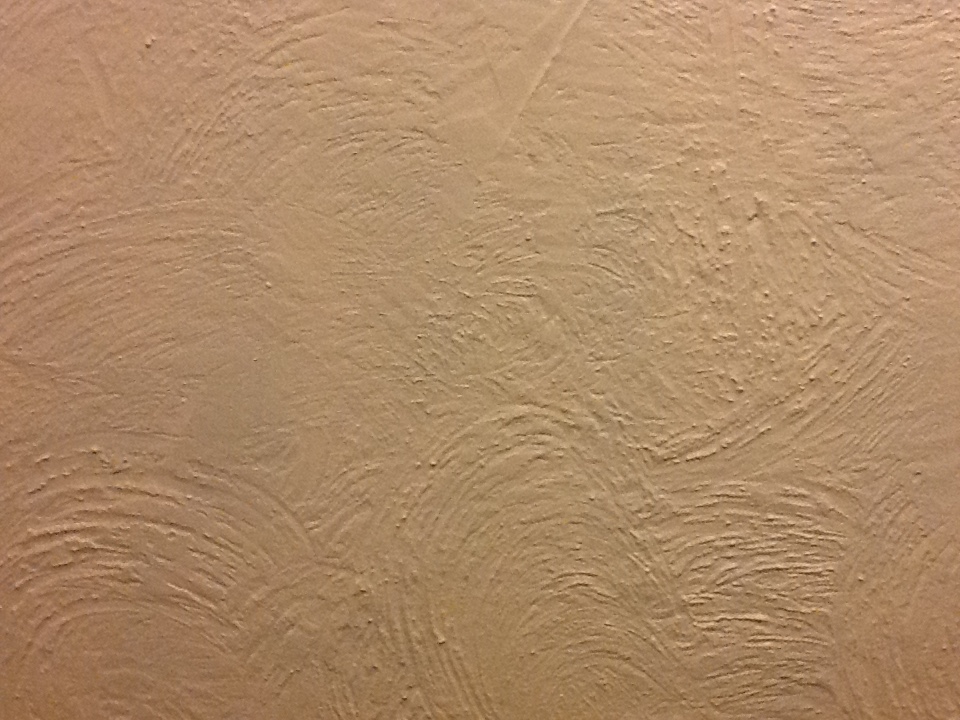

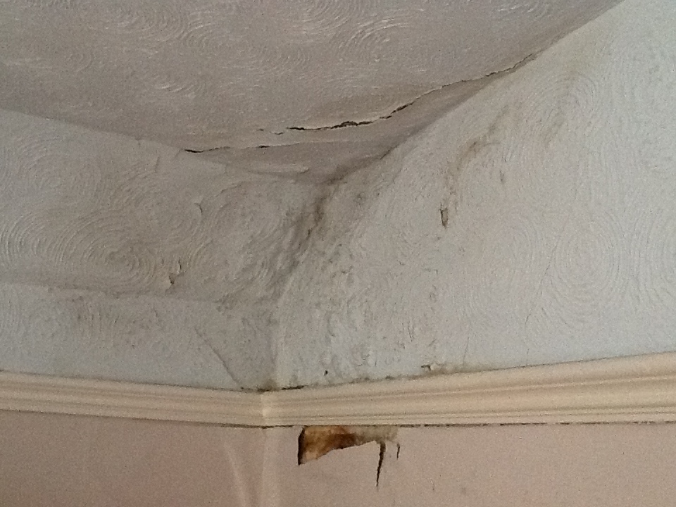

Thanks for replying. I've zoomed in on the swirly pattern of the photos on an IPad and compared it to photos of asbestos containing artex on the Internet and the swirl does seem more bumpy/lumpy and less peak-like on my ceiling. Would a house survey have mentioned if the ceiling was asbestos artex as nothing was said in the one for this house. Renting from friend so won't be removing. Attached a photo of hallway wall in case someone recognises asbestos artex or plaster. Still debating Kipling on sofa instead of sleeping in this bedroom so any replies extremely gratefully received. Wondering if moisture damaged will make fibre release less likely as opposed to drilling into, but it is a substantially cracked as well as other smaller cracks. Also wondering if the bubbling (see photos) points to plaster or artex. Bless you all. K.

House surveys don't tend to bother with asbestos unless it obvious, and artex isn't always the obvious stuff. Surveys tend to look for structural defects, are the wall sound, does the roof need replacing. Wall coverings don't tend to come in to their remit.
If you do have artex, then never drill into it, but moisture tend to hold on to the fibres, hence it's best to steam it off and scrape it, rather than dry scrape it.
I suspect you're going to be fine; but it's your choice. Best of luck with it.

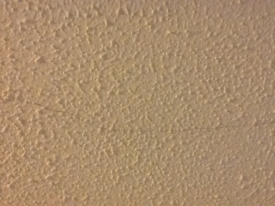

Anyone else out there who can offer an opinion, especially seasoned plasterers, or could you email this link to any you know. Chanced bedroom this morning and it's quite unevenly done - see photo. Don't know if this implies anything. Would really like to stay here and would like to find out for sure without getting up close and personal re the sampling/testing route.

As long as you're not scarping it off without a mask etc, Artex is actually very safe. It's been in homes for years, and having been painted over, it will have had any loose fibre sealed in. With the gap in the ceiling, you could get a tube of caulk, and seal up the gap, and I think that will deal with any problems.
If you're really worried, then do a search for artex asbestos testing, and read up on the isses, and where to send a sample for testing. But the trouble with doing that, is that you're then disturbing the covering, so you test it for asbestos, and then expose yourself to danger whilst you're doing it.
Sometimes is just best to leave well alone. You're going to get this problem in almost any place you rent, and and you've been in the room already, so if there is any particle floating round the room, then they've already got you. Asthma isn't a precursor for problems, and shouldn't be worried about. But it's down to you at the end of the day.
