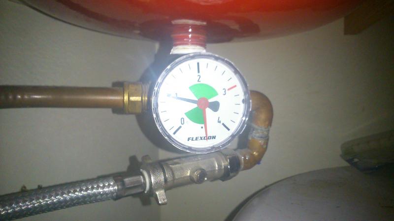

Just noticed the position of the dials which are under the smallest (one of two tanks) in my airing cupboard.
Cant work out what the black and the red dial mean ? :rolleyes:
Does anyone know what is the right position please :confused: ]
Thank you for anyone who knows :)
Terrywookfit";p="3337588 said:
Black is system pressure.
Red should be pointing to the cold setting pressure. Normally 1-1.5 bar[/quote
thankyou so much!
do you know how i change the red pointer please ? :)
