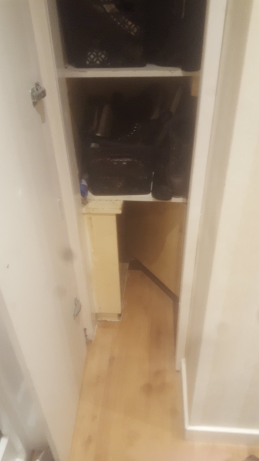

I know access is tight but it is accessible .

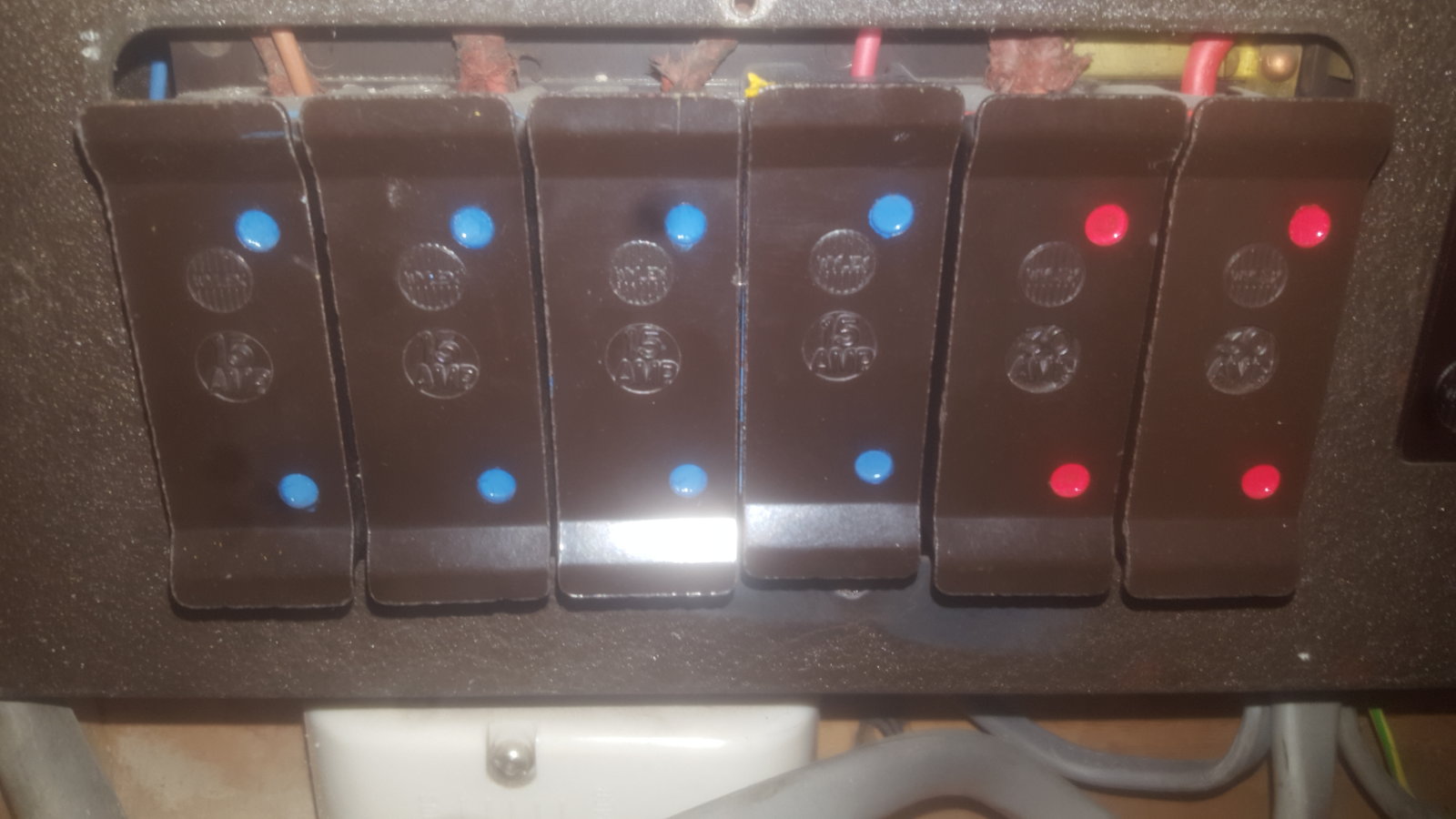

Not illegal, but it's in a ridiculous location, it's at least 40 years old and some of the wiring inside appears to have cotton braid over it, which makes that at least 60 years old.
Life expired, should have been replaced decades ago, and not suitable for continued use.

Perished rubber cable insulation is not "safe"
Is the CU inside that cupboard you show? Where?
Was told by a spark that its illegal due to hard access ...the unit is inside the small cupboard...and consists of old wire fuses

While it's not breaking any laws as it is, no one with any sense or credibility would ever consider adding anything to that installation.
That fusebox is pretty much inaccessible, and it won't be possible to connect anything else to it.
If you really must have this bath connected, then the only option is to have a new consumer unit installed just for that, and at the same time install the required earthing and bonding which almost certainly won't be there.
The new consumer unit will need to be connected at the origin where the meter is, and most certainly NOT attached via that fusebox or any other that may exist there.
The reality is that the property needed to be rewired several decades ago.

No point moving or replacing the consumer unit unless you are going to rewire that old braided stuff.
Long overdue for replacement.

It should have been rewired 50 years ago.
Presumably that wiring goes all over the house.
If you was to bend that cable, the insulation inside would crack and drop off.
This type of wiring is sometimes installed in metal tube, which makes rewiring in walls easy(ish).
However, it can also be found inside wooden trunking, though usually under floorboards.
