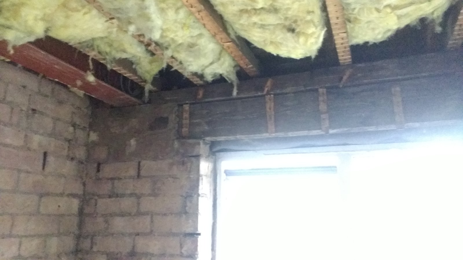

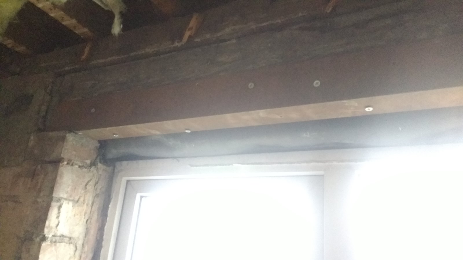

Is this lintel ok?
22 Nov 2009
2,971
770
Oldham
It has been for 88 years (1930s semi with rosemary tiled roof). It is 170mm deep X 65mm. Above, but separated by a bed of mortar, is a 75mm x100m wall plate supporting the rafters and joists. I'm adding some new 7x2 ceiling joists sitting on the wall plate and 18mm chipboard flooring to provide loft storage (3-400kgs). Roof covering will be replaced in a few years (flat concrete tiles seem to be popular in the area - don't know whether these are heavier than the existing). I think I'll have problems if I leave it as is and I know if it was a full loft job it would need steel in. I'd rather not take it out as there's a big lead cavity tray nailed to the back of it so wonder if I can reinforce it with an angle iron or flitch plate.
While I appreciate it may be an SE question any suggestions would be appreciated. Thanks
Span is 1.76m.
Sorry the photos aren't great it's sunny here!
OK for re-tiling in concrete, but if you were supporting a floor off it as well....?
Why not just reinforce with a 4 x 2 channel section bolted flat to the face?
Thank you Tony, I thought it would need something. Channel would project beyond the finished wall as it's only about 25mm back from the plaster. Looking at steel sizes a 100x65x7 unequal angle should fit quite nicely so I'll fit one of those in.

1.76m of timber lintel and the wall plate above it take anything you might be able to put in a loft.
'anything'?
depends on the span of the new joists, and the actual loading. If it's the accepted loft floor live load of 5lbs/ sq ft, then maybe OK,
if normal domestic loading of 30lbs..........?
The wall plate and beam will work separately, according to their I-value, so the wall plate will contribute little to the combination.

I apologise but I gave the wrong measurement for the span, it's 2.3m (the 1.76 was the big sealed unit). For my own peace of mind I've put a piece of angle iron in - £5 and half an hour's work.
