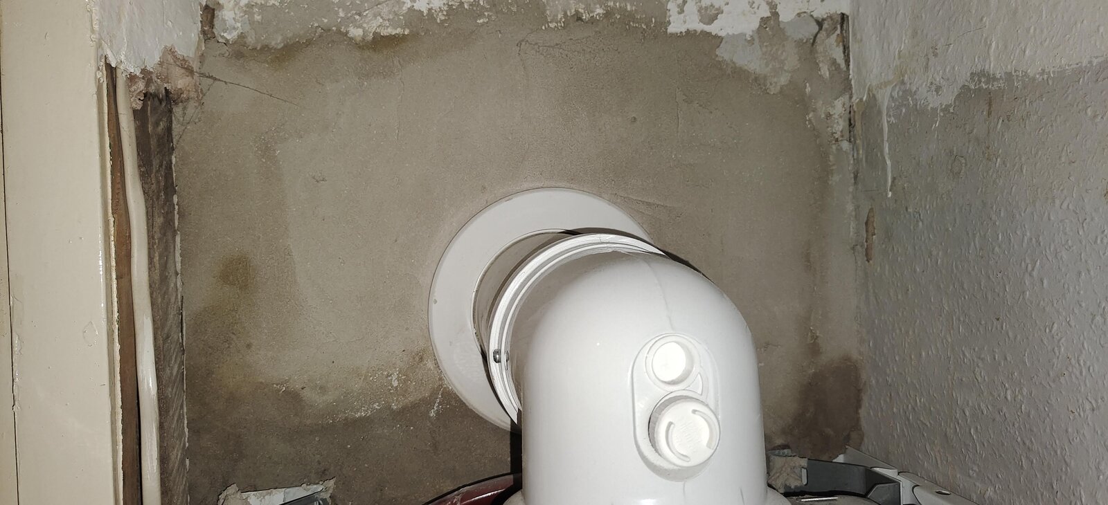

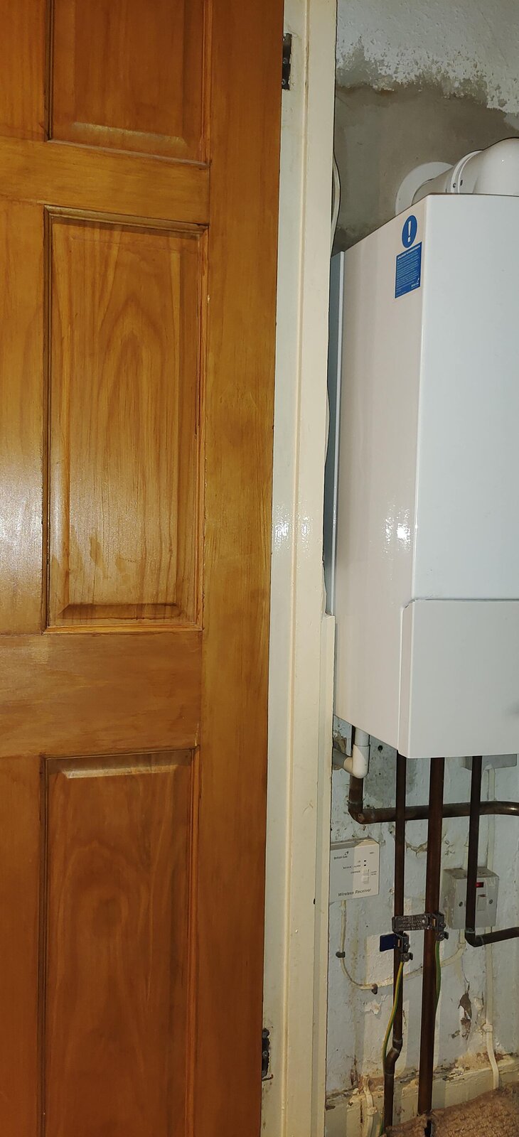

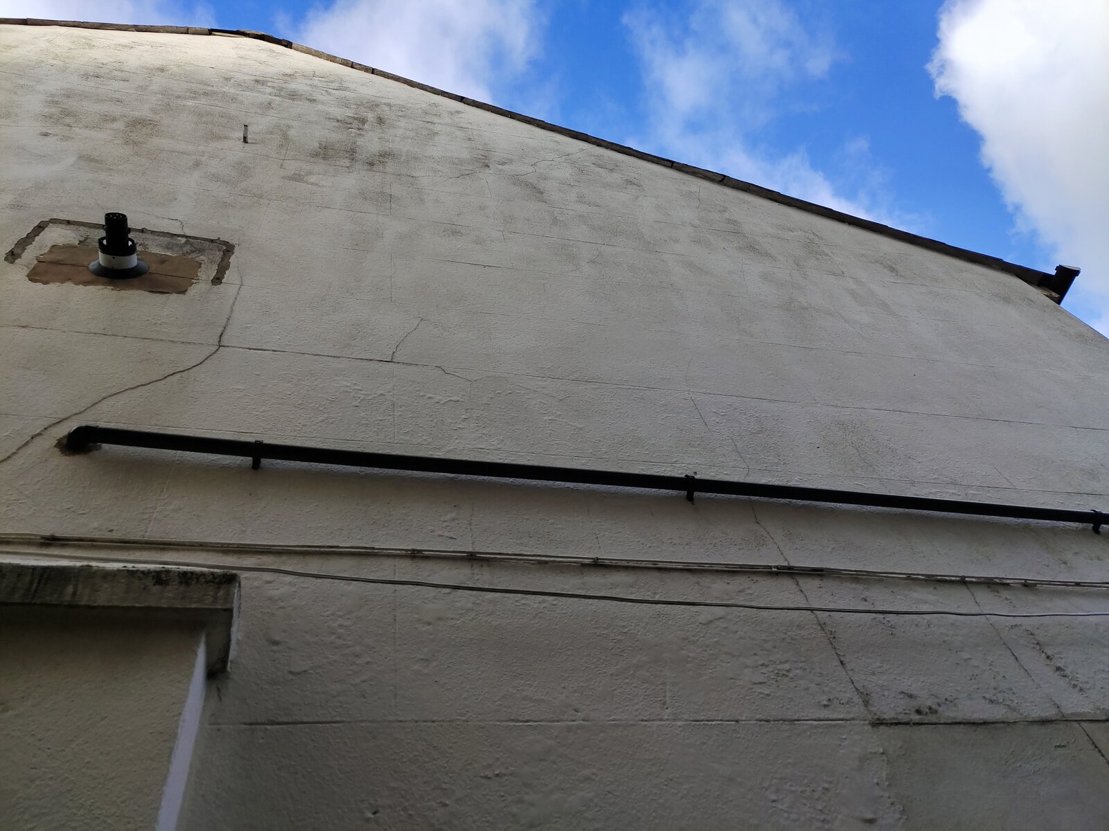

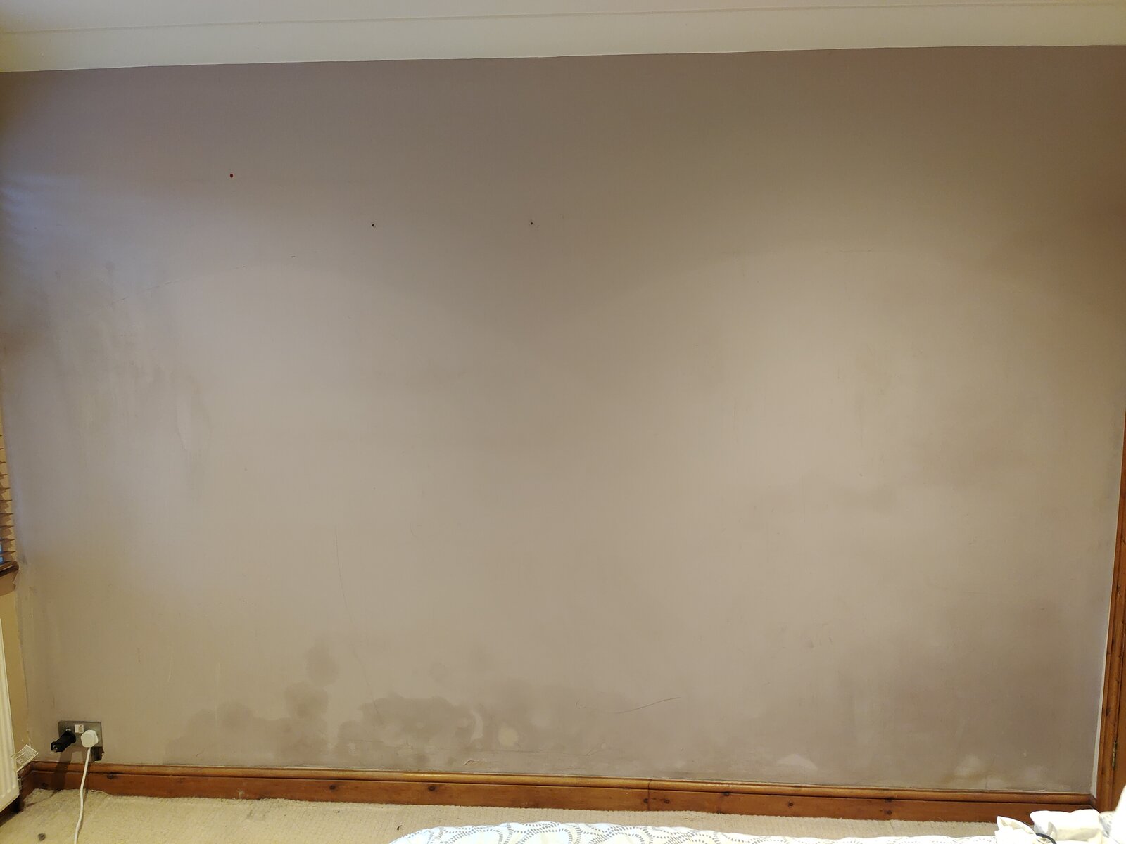

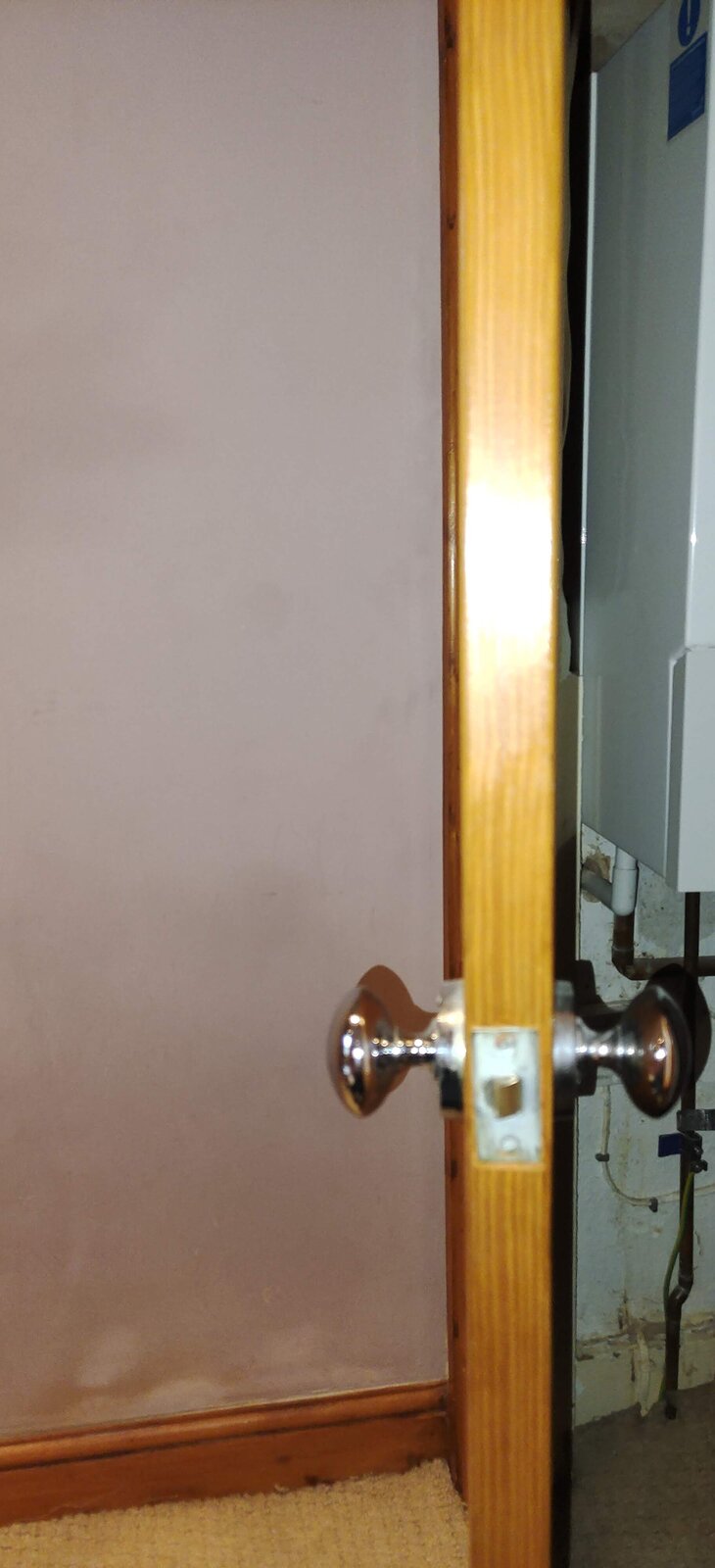

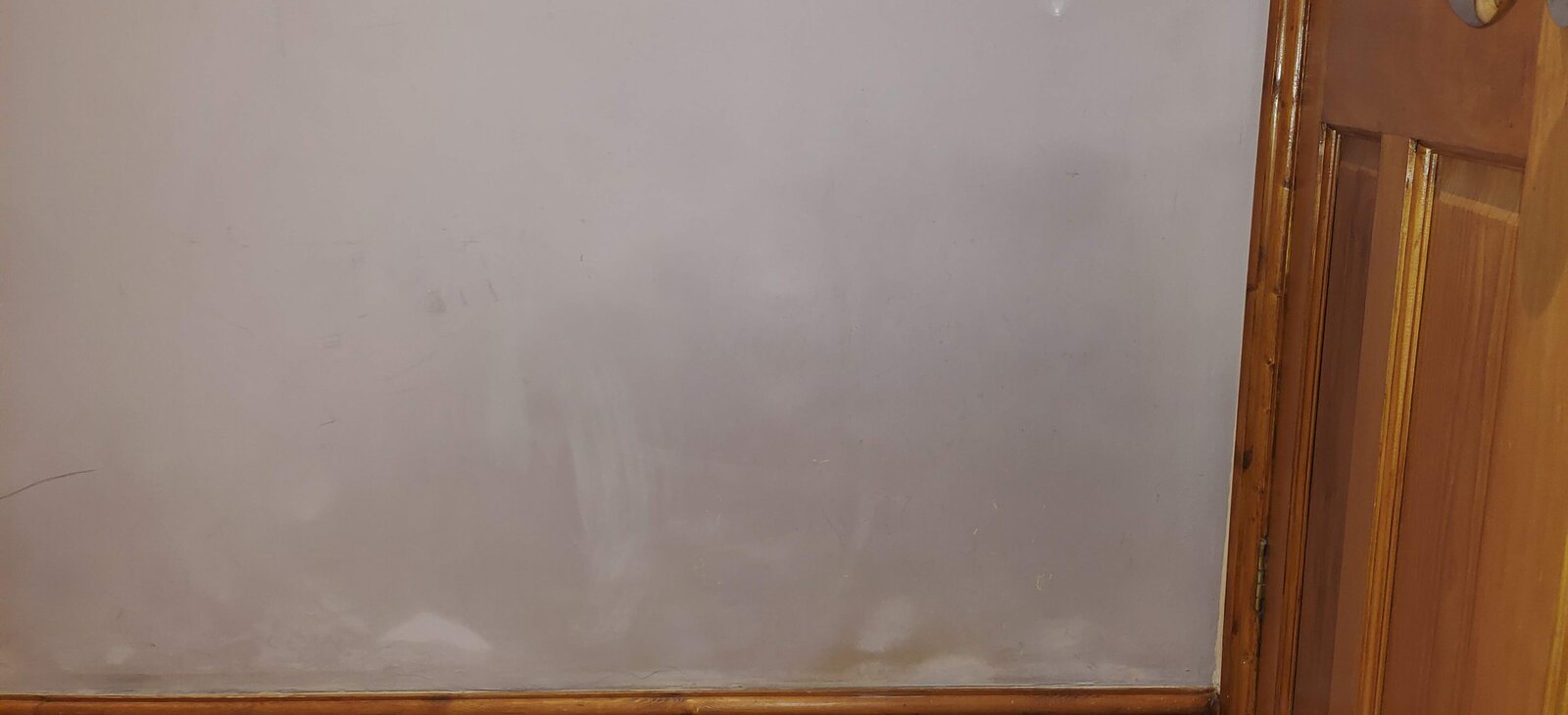

I'm an inexperienced first time buyer. November moved in to the house to find damp plaster on 1st floor bedroom wall (external).
Based on the description below and attached pics, what might be likely causes of the damp, and what repairs should I realistically expect? Are there any specific questions I should ask when getting quotes?

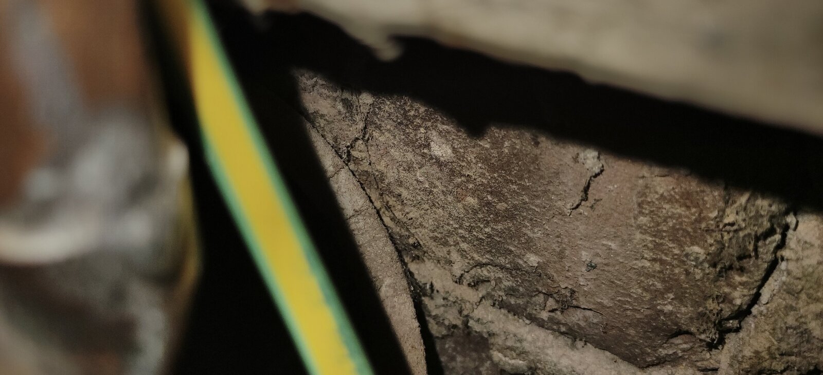

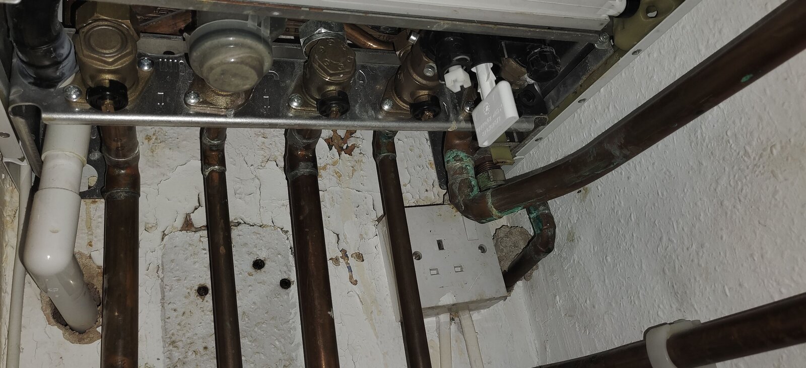

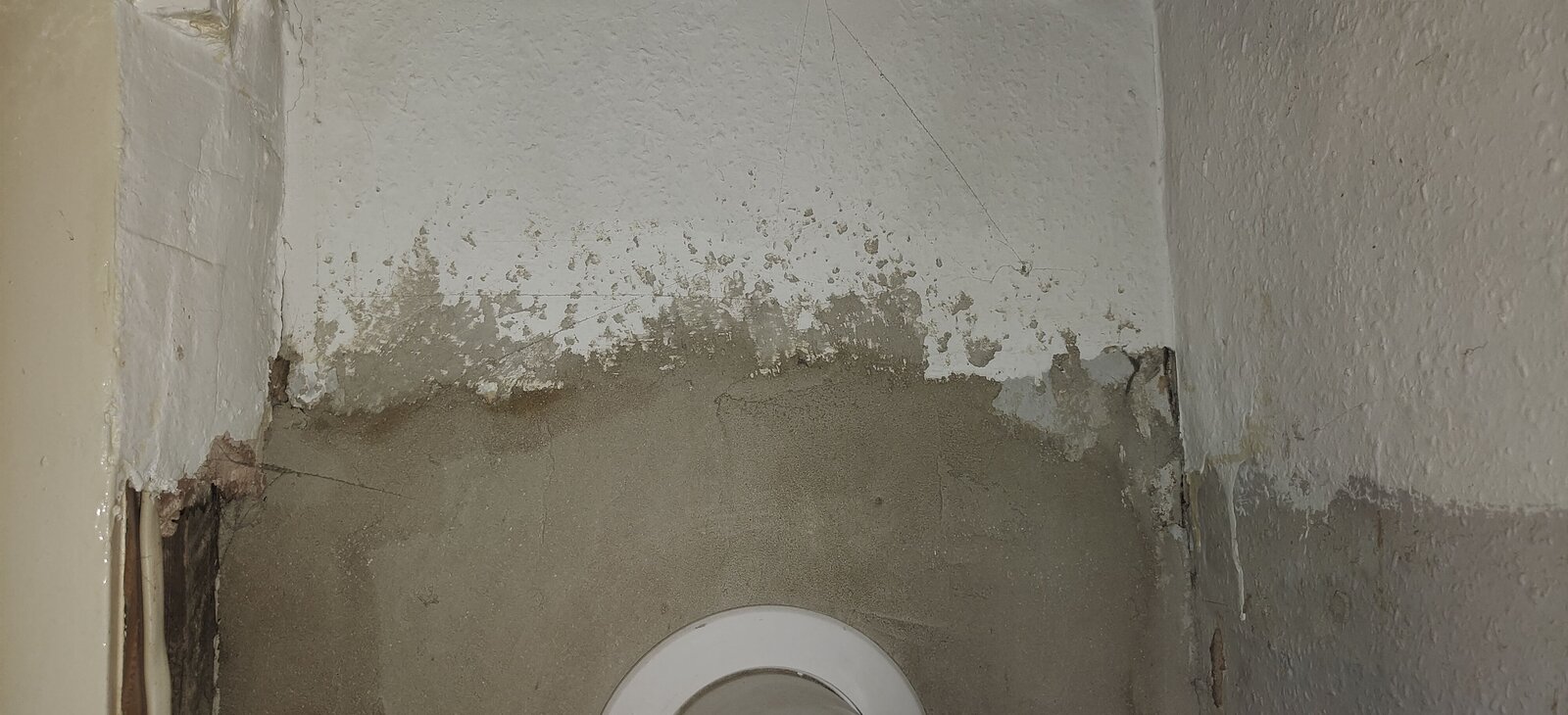

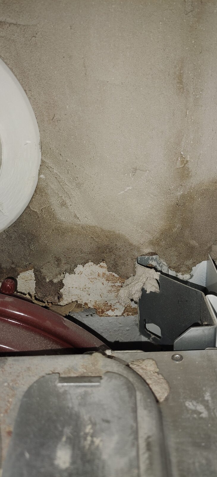

There's a boiler mounted to the wall with a flue passing through to the outside. Damp appears around the flue and the plaster behind the boiler is crumbling. The damp spans the entire length of the wall, just above the skirting, but rising in places.
The external wall is fully rendered with a 2-3 cm thick layer that is cracked in places.

No matter the season or the weather the surveyor must have seen the blown render on the gable wall and the water damaged plaster on the bedroom wall.
Have you examined the conditions of the rooms below the bedroom?
With surveyor's binoculars the condition of the verges could also have been clearly seen?
The gable render needs removing and new sand & lime render installed.
Go into the loft & examine the gable triangle - & the roof area below the verge.
The bedroom plaster needs hacking off back to masonry, and also rendered with sand & lime and, say a Limelite Remedial finish.
Thanks for the the advice, will go check out the gable.
From your suggestions, plus the previous, it looks like the course of action is: re-render wall, re-point wet verge and re-plaster interior wall.
The survey did mention "minor hairline cracking" to the wet verge and recommended repointing these in addition to filling cracks in the render. So there was warning that this was coming, which everyone here seems to have picked up on!
