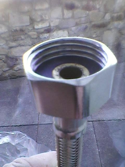

The flat face end of the adapter mentioned above and the isolator valve I found on TS website is 1/2BSP thread but the coupler nut on the flexi I have seems to be metric thread so will not fit. They spin on about a turn then jam.
I been to my local hardware and they have isolator valves which the flexi nut does screw onto but have an olive rim.
Anyone one know of an isolator valve with a metric thread on the flat face end?

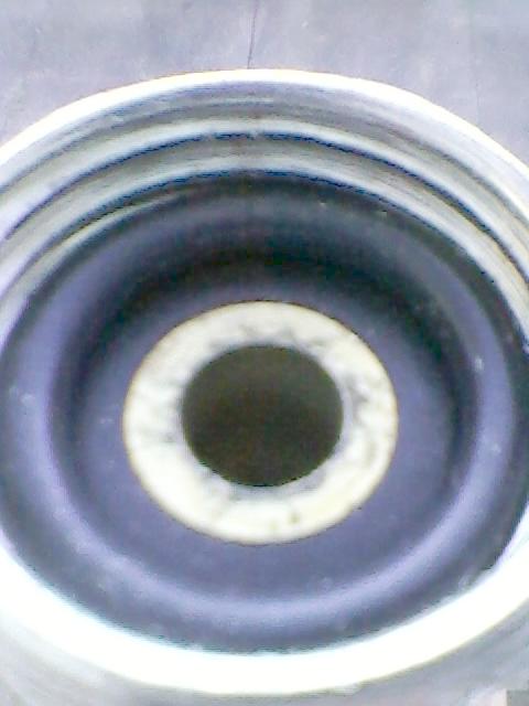

This is a photo of the flexi end,
full
I believe I have a solution!
Using these isolators and inserting an o ring in the flexi coupler to sit on the rubber washer, I can get it tightened with a 22mm spanner. I'll silicone grease the o ring. I'm presuming it will a good water tight seal?
full
Don't play with separate orings /washers etc, they're not designed for that, it's just a fudge, nor using the wrong threaded end, never advisable when it comes to water.
As suggested, get a flat file and flatten one end of a normal ISO and it'll fit without issue. They're just brass so dead soft and take no more than a few secs to flatten it enough so it doesn't bite into the seal of the tail.
full
Based on my own hellish previous experience of a no name Toolstation lever valve snapping (the fitting just snapped apart and caused £5K damage) after 3 years. I am happy to pay for Peglar valves. 5 times more expensive but trustworthy.
The internet is great in so far as you can find cheap stuff, but it can prove to be very expensive.
Update!
I got a set of flat face isolators at a local plumber merchant and I had to get a set of pipes too. The pipes that were supplied with the sink and tap did not have true 1/2" BSP threads so would not screw fully onto a fitting.
Sink is now installed and all is well.
Thanks All!
