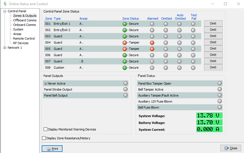

Please can I ask how to remove the sensor from the system? I need to remove zone 5 and clear the tamper on zone 4?
Many thanks!
I think I have found how to remove the not longer required one by setting the zone to not used. So all I need to work out is how to remove the tamper on the remaining zone.
Thanks!
It cant simply be removed, you will have to find the cause of the tamper i.e cable fault/disconnected, falty switch in pir. Perhaps this shared a cable with the pir that was removed...or cable was damaged by the builders

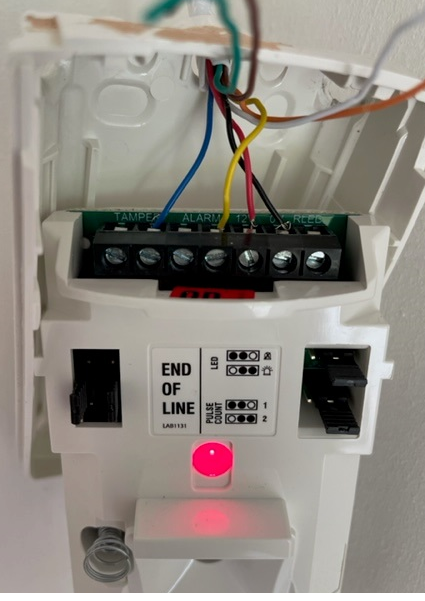

How many cores do you have in the cable feeding the PIR?
Which PIR's are you using?
How are they wired?
How are they wired?
It's an 8 core cable, I assume I could try the reaming four wires to see if they put the pir in tamper?
Thanks!

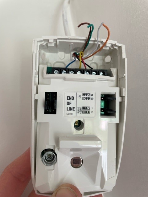

cant see which pins are shorted for the eol if any.
Sorry hard to capture, I have taken some more. The one PIR in question was moved so I think the cable was extended but I have no idea if they joined all wires or just the wires the PIR was using. I would like to think all but if not I am guessing my only option is wireless setup.
okay so that looks like the resistors are set correctly ie pins 3 and 4 shorted out for alarm and tamper.
Move the blue wire left one space so its right at the end.
then check your wiring type is doublepole eol against the zone.
the close the pir up properly and what does it show up as?
You only need three cables.
On the Elite 24 if you wire just one cable to the left terminal.
Wire that wire into last tamper terminal in the PIR
take a short wire between 0V of the PIR and the first alarm terminal.
You will only need 1 wire to be good as you already have power to the PIR.
so try blue wire in last tamper terminal to left zone terminal in Elite 24.
then the other wires to see if one of them is any good.
