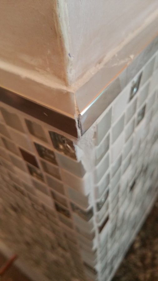

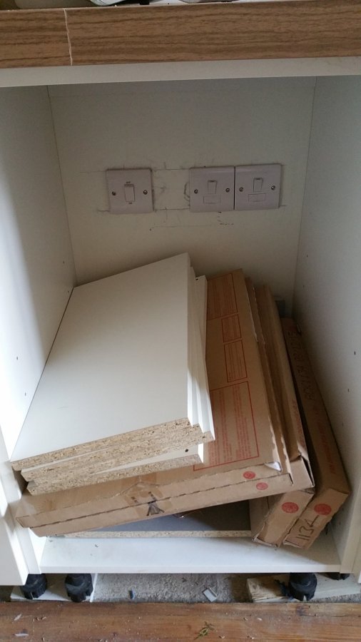

I cant even tell you how bad the problems are. The mitre joints are terrible. The worktop slopes. The wall units have had large screw drilled through them and ruined them in my opinion. There is so much more I just wished I could post photos.
I asked for a meeting with the builder who became very offensive. He eventually turned up and I pointed out the bits Im not happy about.

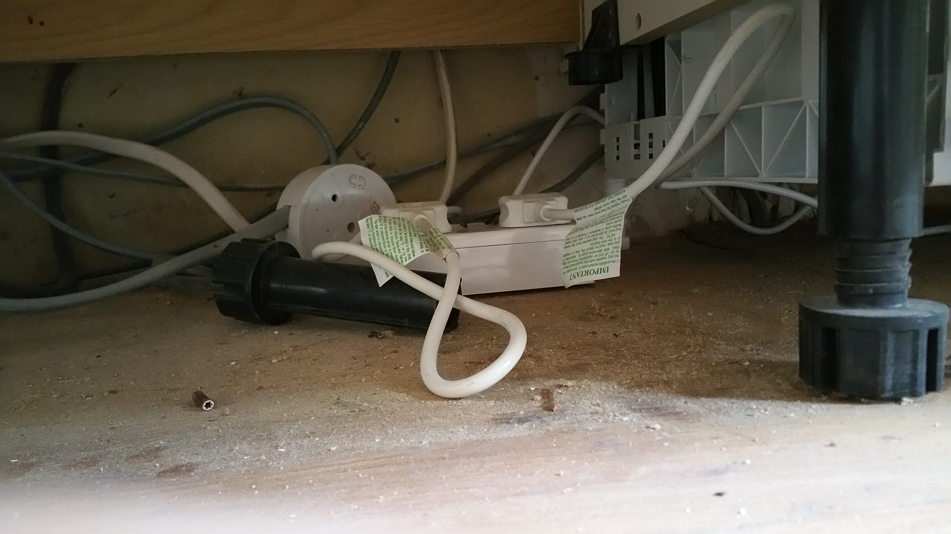

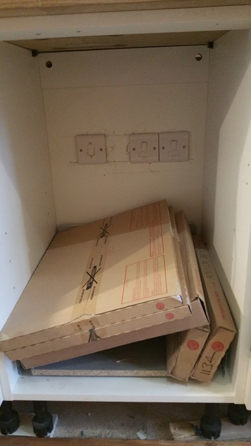

For instance, the isolation switches have been placed behind the base drawer units.
The plug socket for the washing machine and dishwasher has been placed in the unit under the sink directly below elbows in copper piping. I had asked for the switches to be placed above the worktop.
The electrician who turned up became very offensive and insisted it was all acceptable and I was being too picky.
I had to ask him to leave.

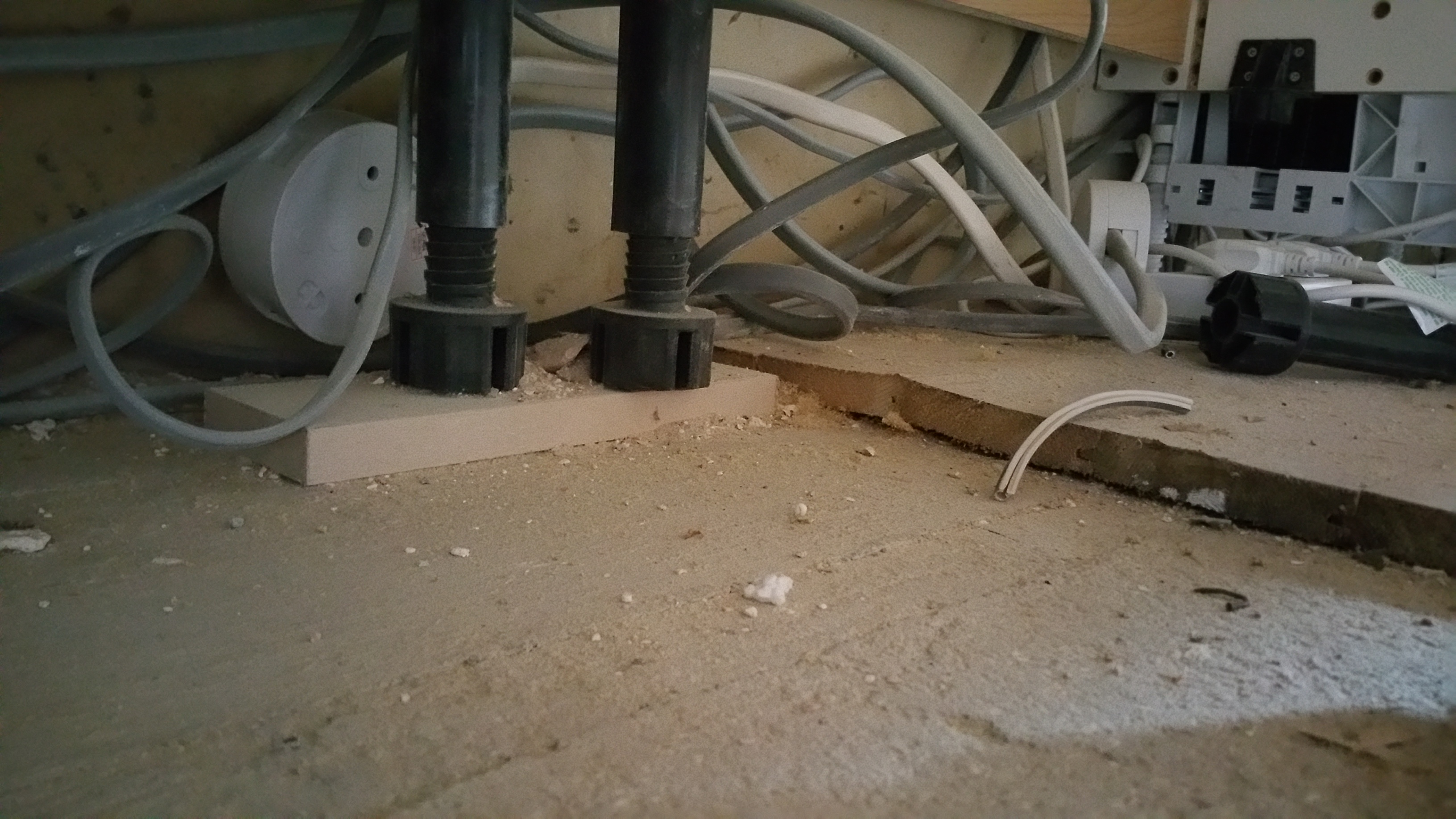

On further investigation as to why my fridge and freezer was working i found switched sockets under the units screwed into the floor towards the rear of the base units. A cable went from this double socket to one of the isolation sockets behind the drawers.
I am worried about this socket for several reasons. One of them is that it wont be that easily accessible if needed behind the kick boards.

Im will start with the electrics. I had asked the builder to place isolation switches above the worktops.
Instead the electrician has placed some behind drawers and a socket underneath the sink. He told me this was acceptable even though i asked for them to be placed above the worktop.
He said the isolation switches met building regs anyway.
I do wonder how by placing the switches behind drawers this is classed as easily accessible? The sockets under the sink is directly under elbow joints.
On further investigation the sockets for the fridge, freezer and cooker have been fixed under the base units on the floor at the rear of the units behind the kick boards. Is this acceptable ?

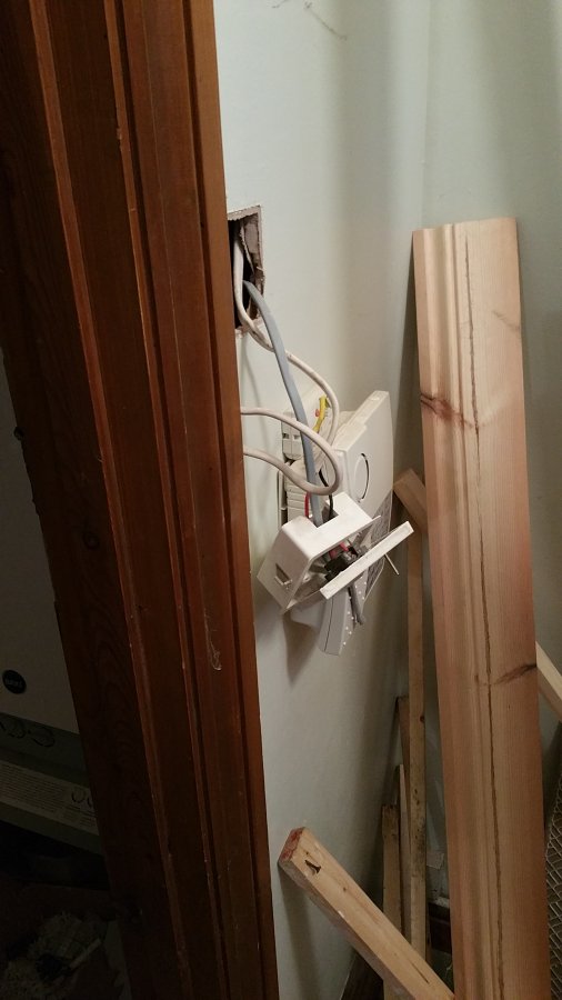

He has also left light switches exposed. I fear that someone could get a shock if they try to turn the switch on to use the bathroom.
I will post some photos.
Light switched left exposed for days.

Sounds like you've paid for a good quality job and been screwed :( Did you get a written quote? or estimate? (what does it say)? Does the Builder have any terms & conditions (what do they say)? £12k is rather high for a normal kitchen deposit. How much are you still owe them/would be owe them if they finished? Generally you have to let them finish the job, ordering off site may not have been the wisest decision. You should have gotten in writing where the electrics were to be going (did you?). The only thing actually wrong with the electrics I can see is that earth wire not connected. It's permitted to have sockets behind a plinth. Don't know where about in the UK you are(?) but in Scotland it's 'should' rather than 'must' have switches above-counter. None of it is of a high standard though. Live wires shouldn't be left hanging out of a wall. Has there been any changes made at the fuseboard/consumer unit?

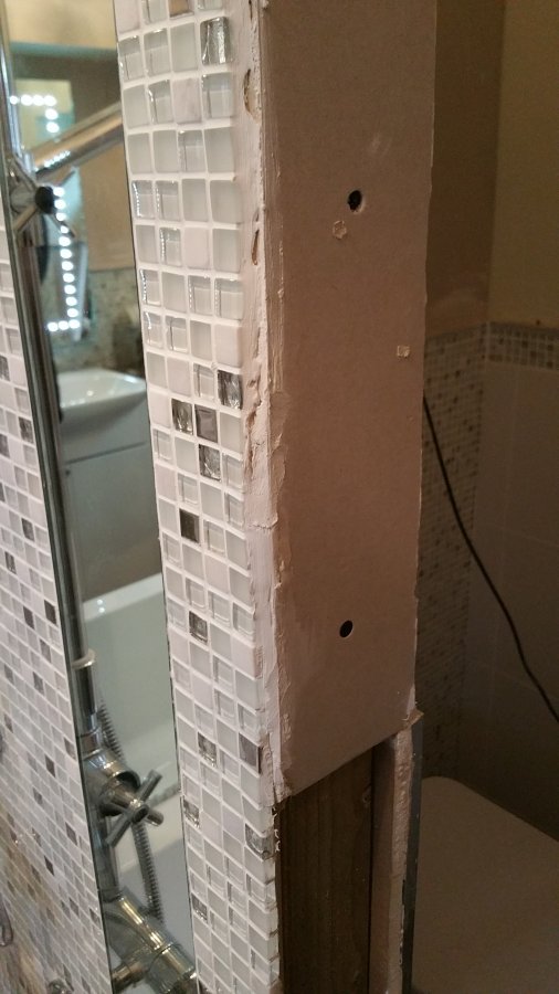

I will try and post some bathroom photos now.
