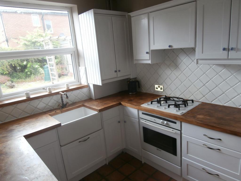

Hi
I'm am looking to replace my kitchen doors, drawers, end panels and kickboards with 18mm birch plywood.
What is the best way to remove the end panels particularly where they are situated either side of the oven. I believe they are secured with screws inside the cabinets but I can't imagine they will just pull out easily.
Will I need to remove the worktop and if so, can I re-lay the same worktop? I have a Belfast sink so replacing the worktop won't be cheap and I'd rather avoid it if possible.
Photo of the monstrosity attached!
Thank you :)
Once you have lifted the oven out, I expect the screws will be easy.
Though in your pic I cant see any end panels except on your wall cabinet.

OP - In order to replace some of those decor end panels you may be into a lot of work. For example the ones either side of the extractor cabinet might require the extractor to be disconnected and the extractor cabinet to be remove before you can get at the panels. Same sort of thing may go for around the Belfast sink. In all probability all the pelmets and cornices will also need to come off. Fortunately, most of the time decor end panels are fixed with 4 to 6 screws through the inside of cabinet walls - just watch out for screws hidden underneath hinge plates, behind shelves, down peg holes, etc
TBH if you can get away with sanding and refinishing the worktops I'd do that. Replacing a sink around a Belfast with falling drain grooves, underside drip
grooves, etc is a fair bit of work
