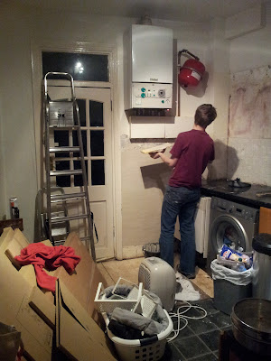

Our current kitchen and our planned kitchen are both L shapes. The new kitchen is to be relocated pretty much the same as our old kitchen, apart from the cupboard we have assembled which unexpectedly, does not seem to fit in the space provided.
In a fit of enthusiasm, my husband and I decided to install the wall cupboards last weekend and now, we are having trouble fitting an almost floor to ceiling unit in the space to the left of one wall cupboard. (Tall cupboard furthest to the left) You can see the boiler and expansion tank (which we have already knocked) here:
Here is a picture of the wall cupboard we have installed, the cupboard that doesn't fit, sits to the left of this.
The wall cupboard sits as the last cupboard on the wall. This is due to the fact there is a boiler expansion tank on the wall which sticks out about 2cm too far. It hadn't even occurred to me that this even needed to be thought about. If we hadn't already installed the other wall cupboard then we wouldn't have the problem. :( But, now we have, my husband has informed me that moving the wall cupboard over to the right means that we are getting too close to an electrical wire so that doesn't seem to be an option either.
My solution is to pay for a plumber to move the expansion tank up towards the ceiling, above the height of the cupboard. Will this cause problems, does the expansion pack need to be at a certain height? If not, how long do you think this job would take?

Thank you for the reply, do you mean pencil the position of the wall cabinet we already have up?
We're not sure what the wire is, it's just picked up by the detector. We haven't tried to rehang it yet as it's currently full of stuff! And yes, I did mean that my husband thinks moving the cupboard over to the right, means the hanging bracket is in line with a wire.
We can't take a picture at the moment as the cabinet is still on the wall. I hope what I've said makes sense! What is the other option for hanging it?
chip the plaster away so you can see the cable. Identify if it is a live one or left over from 80 years ago.
you can fit Hanging Rail which is like the hanging brackets but in long strips with a hole every inch, so you put up a length of it with screws where they are safe. it is very strong and you can lift the cabinet up and down and move it along the strip at whim.
the pressure vessel can go anywhere, it does not even need to be next to the boiler. But it must be accessible for servicing. It might have been fitted because the one inside the boiler casing went faulty and a separate one was cheaper, or because the house was extended and now has more radiators than the internal one can cope with.

Thanks so much, those look perfect. Thankfully I managed to convince him to take the cupboard down and we managed to find enough space to squeeze in some screws. We still have some more to do so those may be just the tickets.
Thanks again, for now we are sorted!
