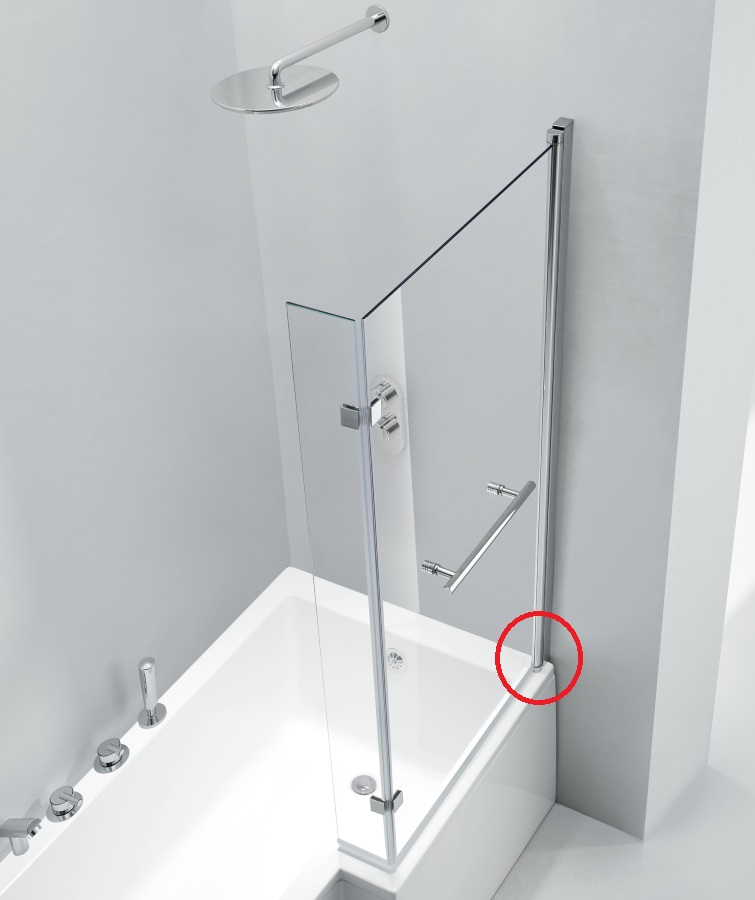

I have one of those l-shaped bath screens to fit my l-shaped bath. I've sealed the screen as per the manufacturer's instructions and have replaced the sealing strip at the bottom of each pane of glass.
Unfortunately, it still leaks at the point circled in red on the below picture (where the screen swings at the hinge). Despite battens under the edge of the bath to hold up the edges, water still runs along the edge and eventually pools at that swinging hinge where it will spill over the edge and eventually onto the floorboards under the tiles.
I shower with the door pushed inwards which helps. My partner does not. She also takes long showers which builds up the pooling water.
Is it possible to have these screens converted to fixed screens? I've seen other versions of my screen which look almost identical to the second picture below except they have a chrome strip where the two panes meet. The glass panes are the same size - I'm hoping you can get the spare parts? Wickes couldn't help me.
Anybody any experience of these?

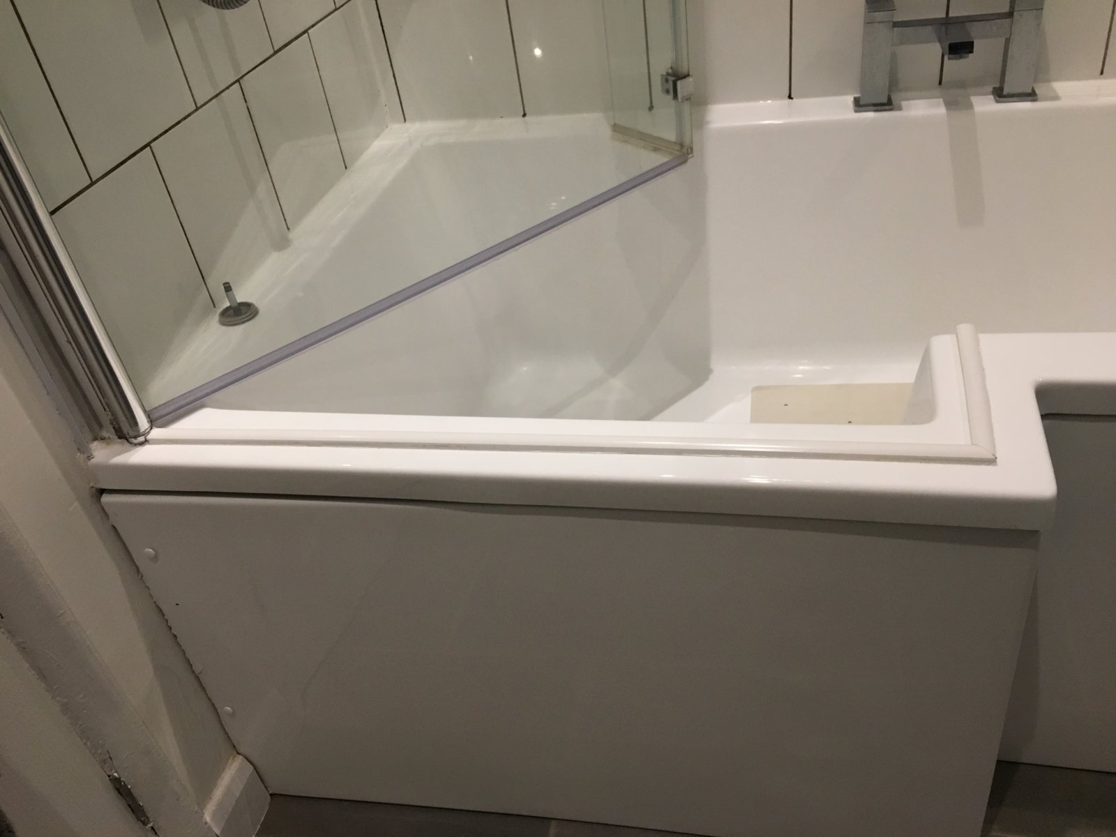

Sorry to resurrect an old(ish) thread, but I wanted to offer my solution for anybody searching for one on Google.
I went to the local DIY shed and bought UPVc quadrant trim. I removed the screen seal then stuck this down with silicone to the top of the bath edge (where the screen sits and following the L-shape), replaced the bath screen seal and let dry.
When dry I ran a bead of bathroom silicone sealant along the outer edge and let that dry. Since then (6 months ago now) water running down the glass cannot go under the seal and instead runs into the bath. Cost of the quadrant was about £4.
Your original problem suggests the screen was mounted too far out, water should drip off straight into bath and no pooling should occur.
It probably was I agree, but even if it were on the inner edge of the bath this strip stops any pooling water running along and out too.
In an ideal world all new baths would be fitted to sit on wall battens with a slight slope inwards at the edges to help direct water but for those of us who have bought homes with baths not fitted this way I hope this helps.

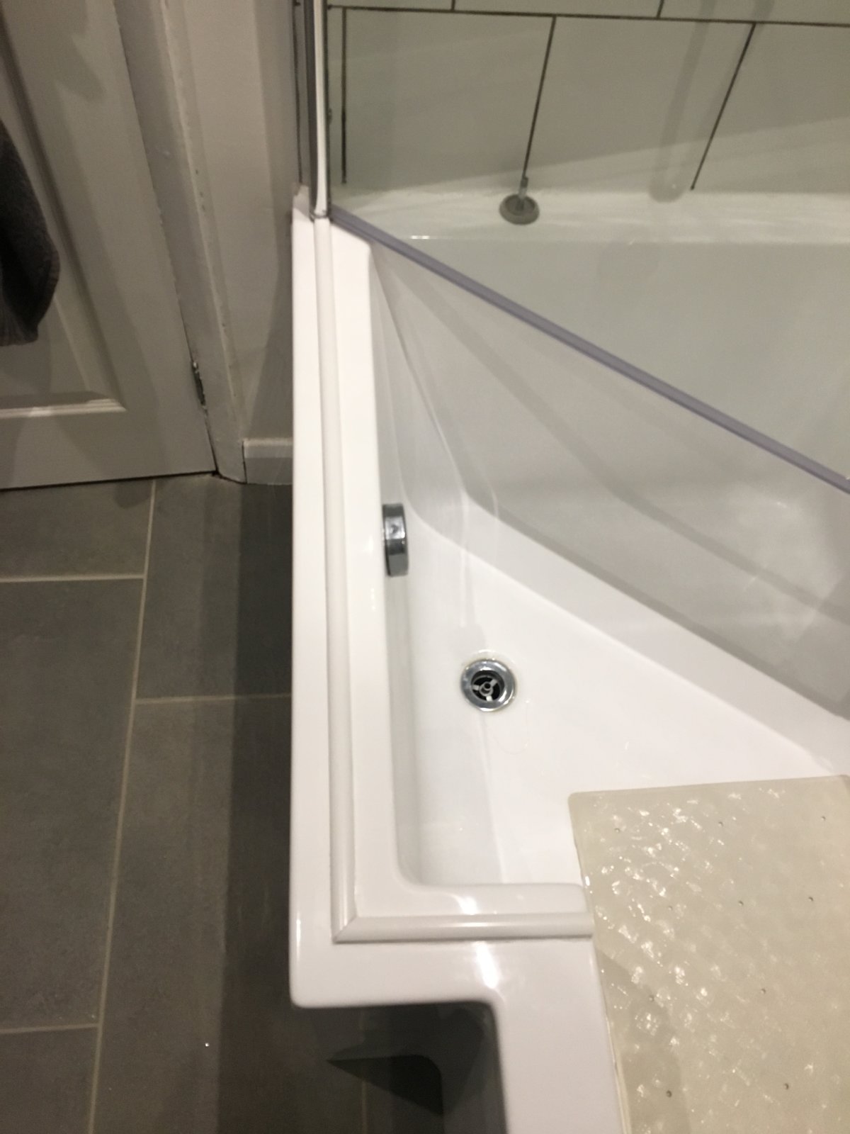

Here are the pics. I siliconed the quadrant strip along where the screen sat and mitred at the corner. I then used sealant along the edge of the quadrant.
Where it meets the screen hinge I just cut it to match the curved shape.
