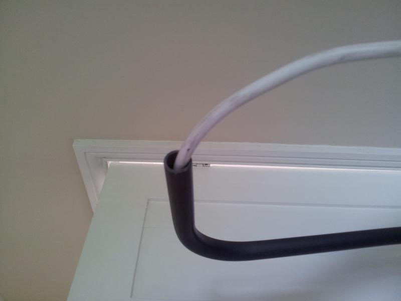

Hi folks,
I've been lurking the forum for a little while now, have a few little projects on the go and am in need of some wisdom. First off, apologies if any of this is extremely obvious, I'm largely clueless on these matters.
Long story short, I have a half inch thick steel tube with a two core flex running through it. The flex will be hanging downwards so I think I just need to wire a lampholder on one end and a plug on the other.
So my questions are:
1) Am I ok to use a two core flex with a plastic lampholder even though the tubing is made of steel and screwed into the wall?
2) I'd hazard a guess that the lampholder itself shouldn't just be hanging, it needs to be attached/screwed into the opening of the tube - are there lamp holders/sockets that can screw into the tube opening or similar?
3) Any recommendations for a black lamp holder
Thanks in advance for any help!
Is there a reason that you are not using a three core cable, so a CPC is offered?
I would always advice continuity of earth between accessories.

I don't mean to be rude, but if you didn't realise that a CPC is a good idea when making a light fitting, perhaps you should reconsider this project. Do you have any means of checking the insulation resistance of the finished product?

I would assume the tube itself needs to be earthed too
Yes, unless the OP has the knowledge and test equipment to make his fitting Class II.

It's not from one end of the flex to the other, it's between all conductors of the flex and the exposed metallic parts. Those metallic parts would need to have a terminal for connection to the circuit protective conductor. You would also need to check the continuity of the connection through the metallic parts, usually at 25 A.

So looking at your post and what I need to do: is the conductor of the flex the steel tubing, and the steel tubing is also an exposed metallic part. So I need to test between the flex and the tubing and have something going from the tubing to the CPC.

The insulation resistance test would normally be performed at a high DC voltage. The earth continuity from the CPC to all exposed conductive parts would be at 25 A and a low voltage. Do you have access to test equipment to do that? If you're going to use a metal lamp holder that too is an exposed conductive part, also a metal reflector would be. How is this light going to be switched?

It has exactly the same issues. I cringe at the sentence "We could not use wire nuts to connect the wires together so we used a solder gun to connect our power cord to the light socket". That's an American web site, and they have appallingly unsafe electrical wiring practices over there.
