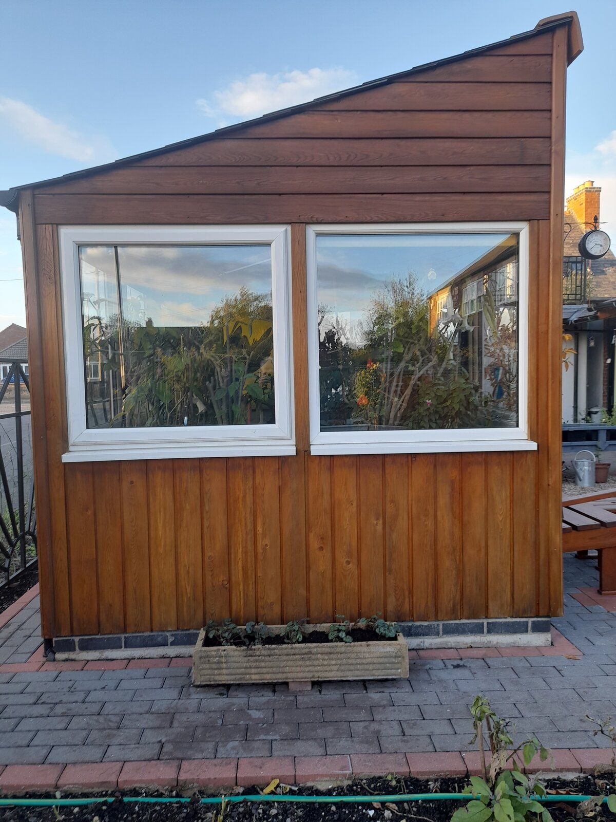

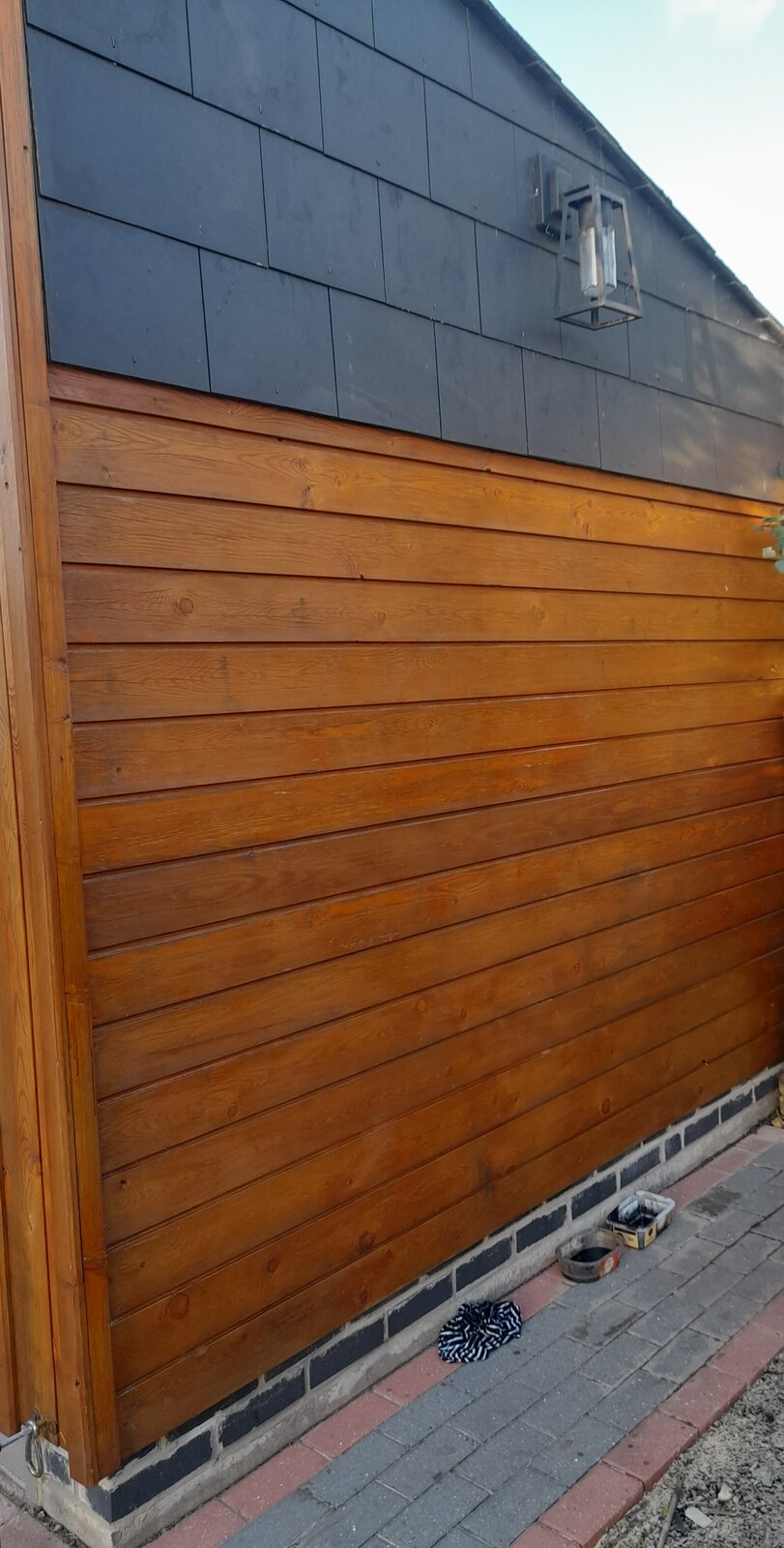

We have used quite a bit of siberia larch have both screwed and nail gunned it.
As above pre drill for screws
Tends to blunt tools fairly quickly and be ready to get splinters in your fingers!.
Still love the look though pics are a shed & greenhouse at home been up about 5 years.

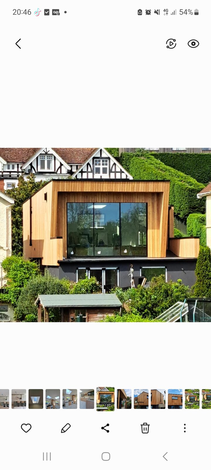

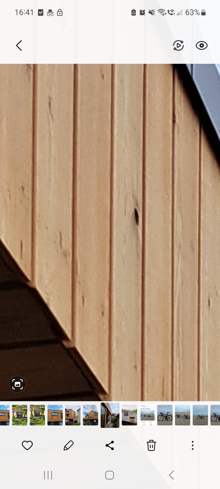

I cladded this house in Siberian Larch, using 3mm wood drill bits, an Estwing hammer and 7500 65mm Stainless Steel lost head nails. The supplier Vincent Timber said the warranty would be void if I used a Nail Gun.
I cladded this house in Siberian Larch, using 3mm wood drill bits, an Estwing hammer and 7500 65mm Stainless Steel lost head nails. The supplier Vincent Timber said the warranty would be void if I used a Nail Gun. View attachment 320032

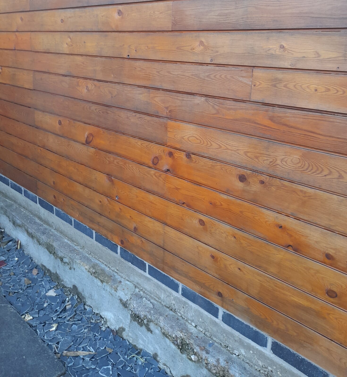

That looks very similar to the finish I am hoping for. Is that open jointed cladding? Do you have any pictures of the finish you got using the lost head nails?
No it's lapped not open Jointed, this is the closest picture I have.
