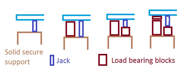

We're doing a self build which is actually a conversion of a current industrial building. It has a large flat roof which is supported by 3 x 11m long i-beams, approx 450mm x 300mm section, and they need to be raised by a few feet up to a height of around 7.5m. My question is, for a beam this size (i'm still trying to confirm the weight, but i know it's substantial, is a crane out only option, or is there some other solution using a Genie type lift?
Depending on the situation it might be possible to raise it a few inches at a time using a jack and blocks at each end. It is not a risk free method but with care it can be sucessful
Use the jack on a temporary patform to lift the beam, then place blocks of timber under the beam. Do the same at the other end of the beam. Lower the jacks so the beam rests on the timber blocks, put blocks under the jacks and raise the beam further, put more blocks under the beam and lower the jacks. Repeat until the beam is at the required height.
It is essential that the beam is securely held at all times to prevent it moving sideways and thus toppling the pile of blocks supporting it. An Acrow supporting the centre of the beam as it is lifted would reduce the risk of it falling off the blocks
The solid secure support is a temporary structure next to what ever the beam is resting on now.

Thanks for the input. It's a good idea, and we had thought about a similar idea, but the amount we need to go up, is substantial (about 1.6m on one beam, and the temporary support would need to be so sufficient, it's probably cost as much to construct as it would be to hire a crane. If we had a temporary support in line we could use i'd jump at that.

Sorry, i probably didn't make it clear in my original post. This is a conversion (from a small storage unit to a residential building), so we're using the existing steel i-beams that support the current roof. The issue is the roof needs to be raised by about 1.6m so we need to take the original beams down, build the walls higher, then raise them back up to the new height. Hope this explains it now.
