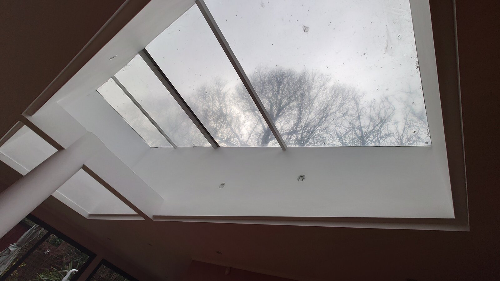

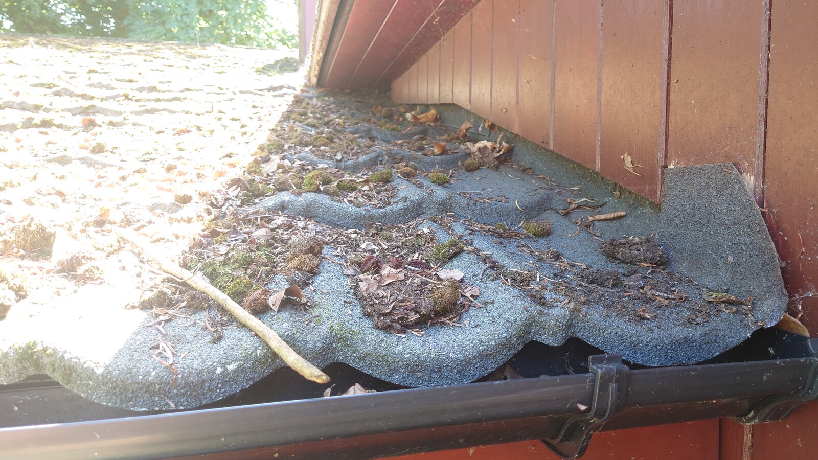

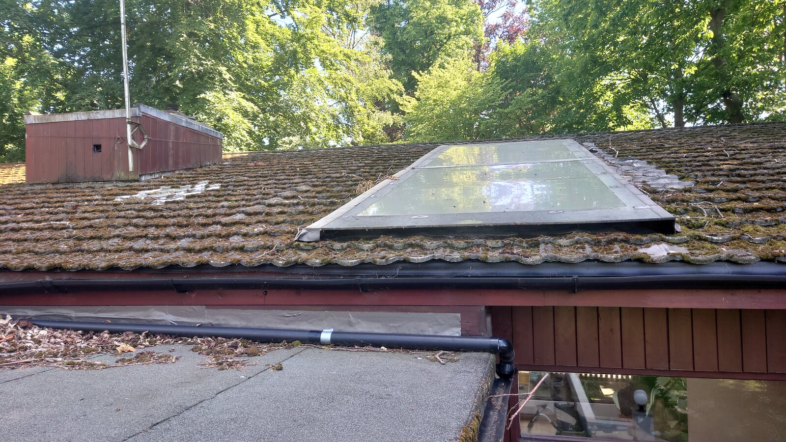

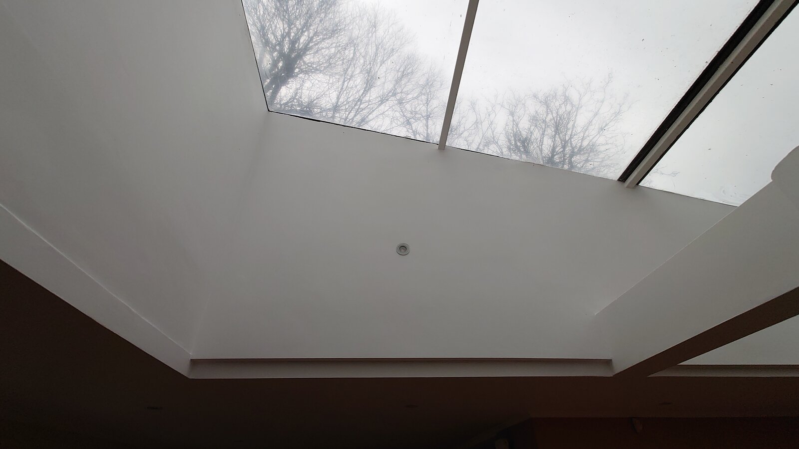

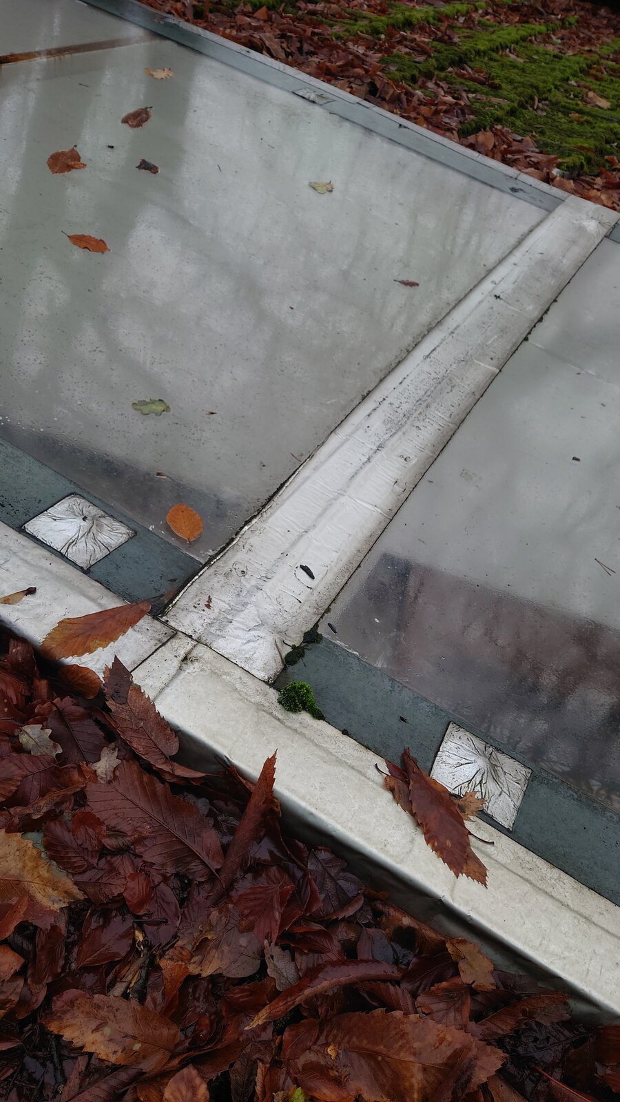

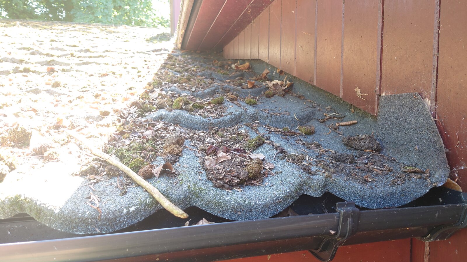

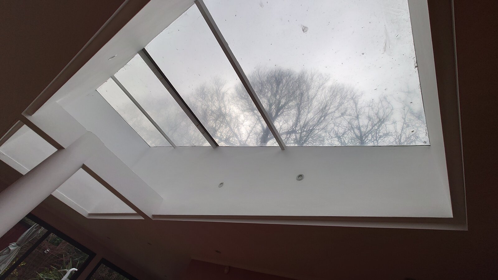

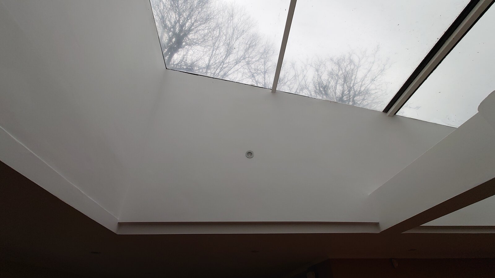

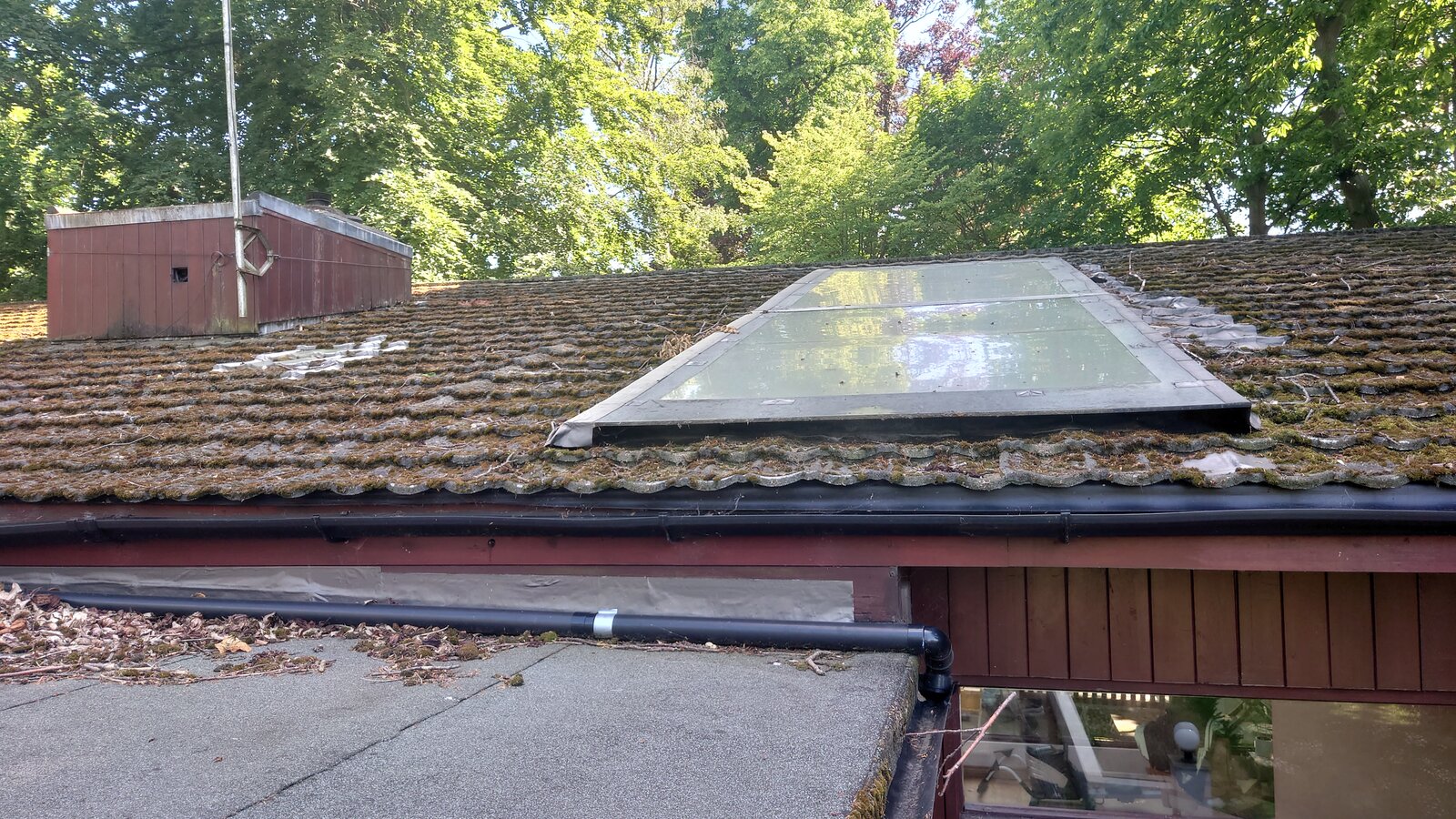

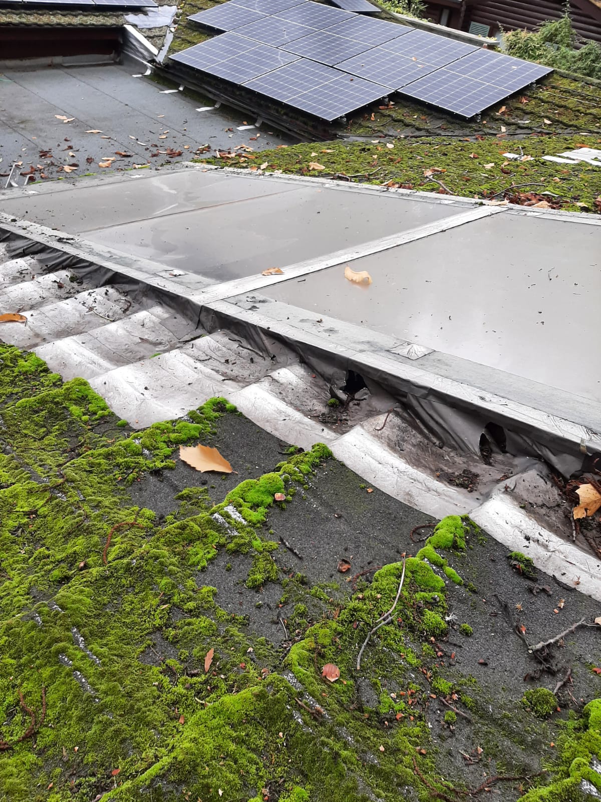

We have a large (c. 5.33m x 1.68m – measured internally, so I’m guessing nearer 5.5m x 1.8 or more externally) singled glazed angled roof light. It appears to be made from two sheets of glass.
1) The seals are failing and need replacing/repairing. The roof material is made from fibreglass sheets, corrugated to look like fibreglass.
2) We then plan to secondary glaze it with four (or possibly two) cast acrylic sheets on the inside, secured with a wooden frame.
Photos here: https://www.amazon.co.uk/photos/share/0dJCw4rC1TRQn5ifhpQpJogkP2suc9WdwUb3tE60Pi4
A less extensive set attached to this post.
Replacing the whole unit with a double or triple glazed one isn't economically viable (quotes so far have been £9k-£14k+)
Any tips on how to go about 1 and 2 (particularly the first) would be much appreciated. It might be as simple as clearing it all up, applying flashband primer paint, and wide flashband tape. But (a) that seems a bit temporary and (b) I suspect I’m missing something! E.g. Any sense in plastic/fibreglass edging strips underneath? e.g. like this . Or another approach entirely? Lead? Lead alternatives? E.g. Wakaflex Rapid Flashing, Ubiflex, Masterform by Nicholson. Stainless steel? (All probably beyond my skill set, unlike it's quick to learn for someone practical).
If flashband, even as temporary measure, I'd need to wait for reasonably warm (and dry) weather for the adhesives to work properly. So I can't really crack on with it as quickly as I'd like!
Despite contacting 30+ roofers, most haven’t responded (despite chasers and lapse of several months) at all and those that have got in touch have said they're too busy or only doing total re-roofing projects. Given heat loss / poor insulation, extensive condensation and insane gas bills, it looks like I’ll need to get my hands dirty! Though if anyone has recommendations on people that might be able to help (near Crystal Palace), that’d be appreciated too.
Any tips much appreciated.

What's your appetite for roofing over it?
It's single glazed, so even if it doesn't leak it'll probably generate as much moisture as a leak would just in condensation
Might be hard to find something to replace this, you really could do with some sort of flashing kit, might have to be made for your window due to size, probably combined with some leadwork.
Flashband has it's uses, but it's no long term solution for your roof.

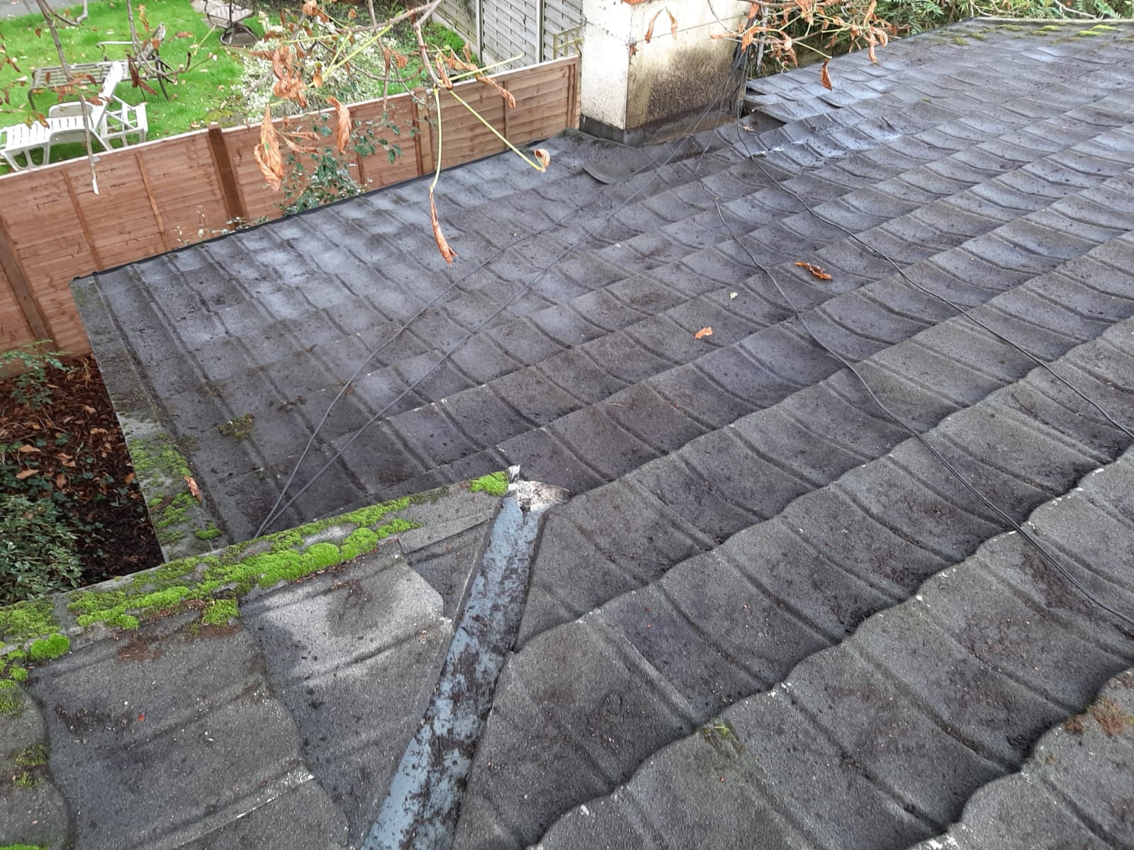

Fwiw it's a decra roof system . Metal not fibre glass . Fair few of the panels are bent probably foot traffic .

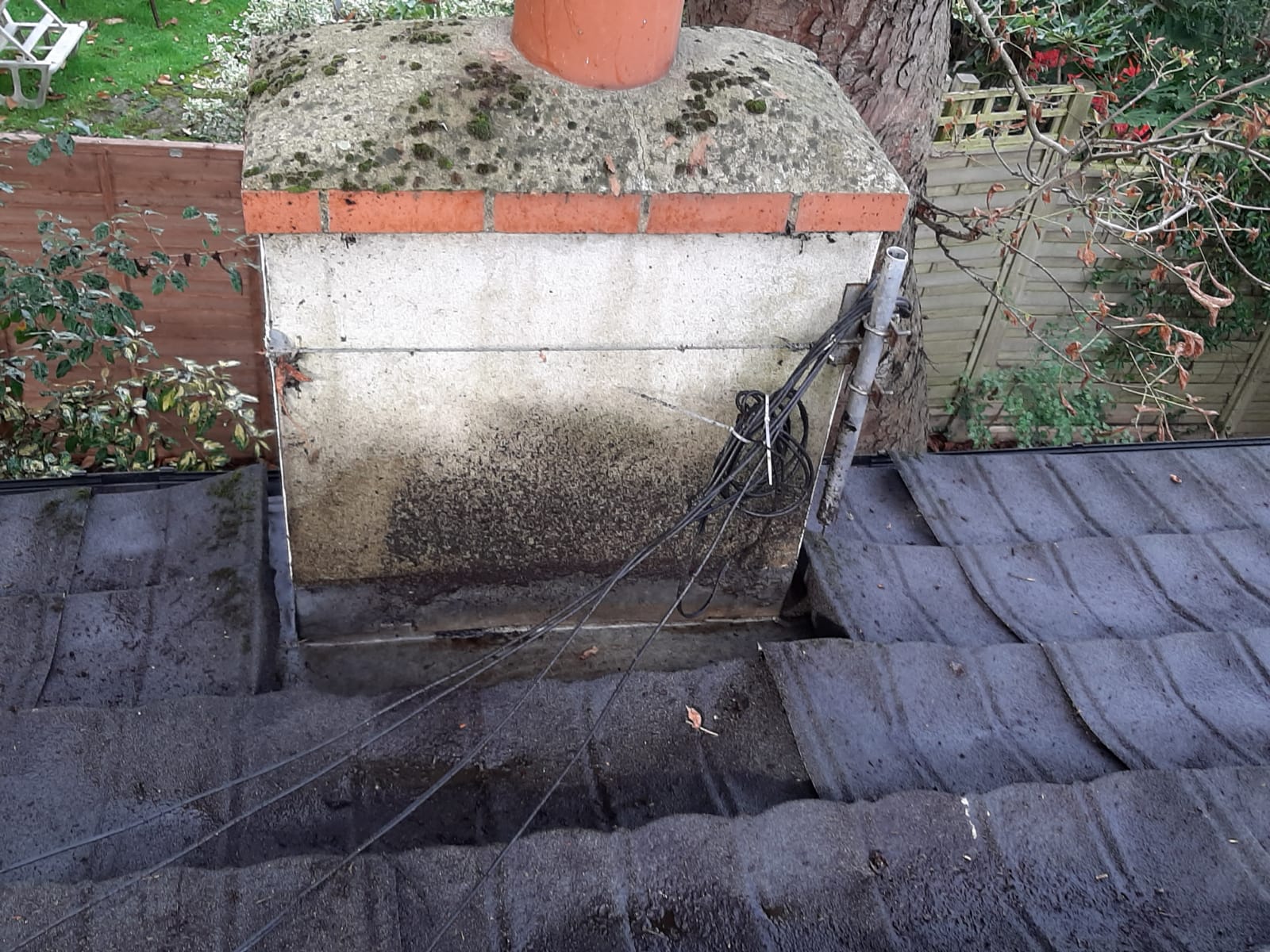

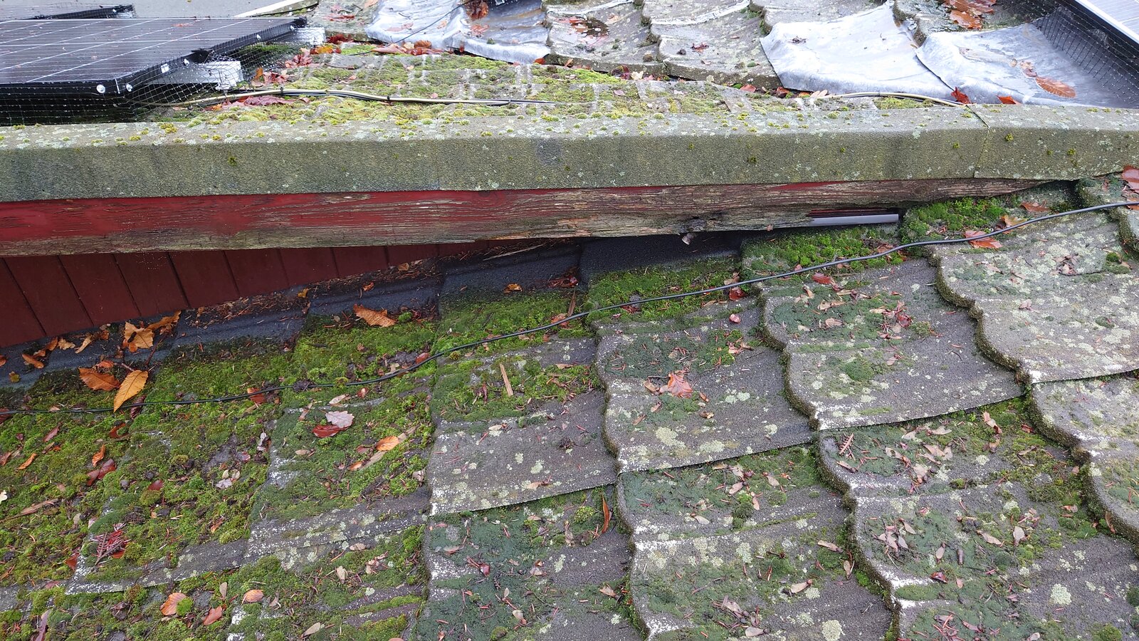

In case it helps, here are a few other shots of it. It may be two different systems going on (?). And it may be it needs some TLC ... Certainly the fascias do - I was considering possibly uPVC overcladding rather than replacing the timber (or perhaps both).
Thanks. So far I'm struggling to find anyone who'll even inspect it, yet alone advice on how to address it!
For a flashing kit, would the glass have to be lifted and reinstalled? I ask because that may not be viable - you'd probably need a crane, in which case it'd need a 30m arm, given the location. Or can it be retrofitted in place. I'm afraid I'm pretty clueless when it comes to roofing ... ! But willing to learn.
The quote I've had so far for an installed replacement are in five figures, which isn't on the cards. So it's unfortunately a case of trying to make the best of what we've got (even if that means periodically having to re-flashband it). A roofer I spoke to on the phone today (but who'd seen these photos) said he'd not touch it (too busy with other work) but DIY flashband might me the best economical bet.

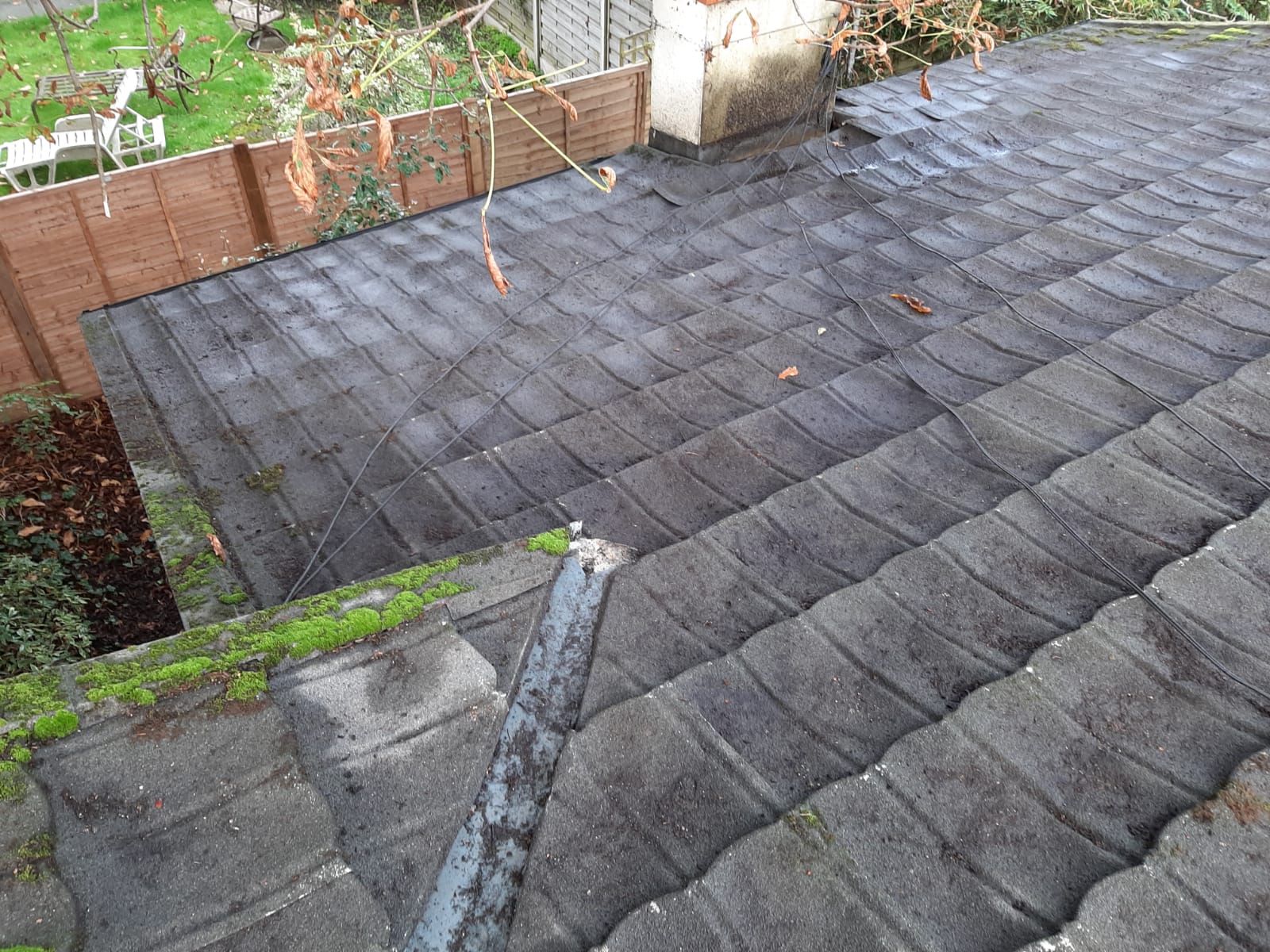

It is decra classic . With a grp valley .
Most of the panels have been bent by foot traffic as I said . This can lead to ingress
Horrendous roof and poor choice of roofing material considering the surroundings. I'd run a mile from that job.

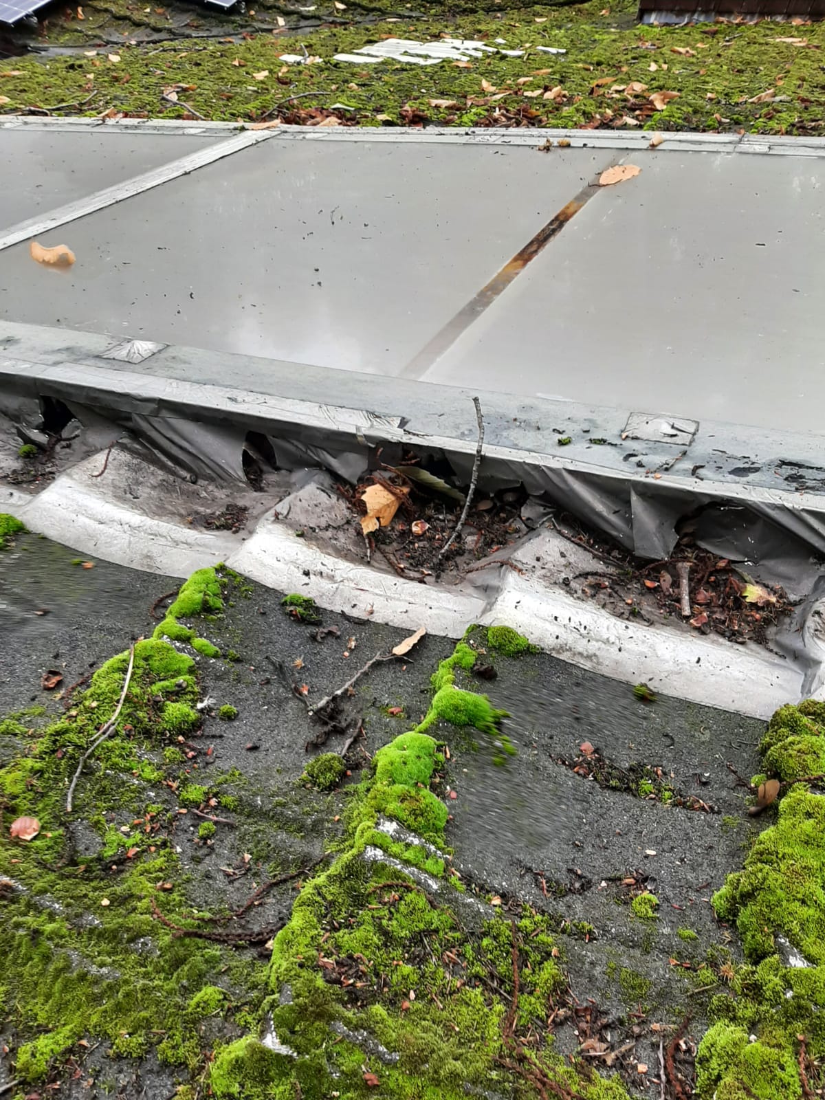

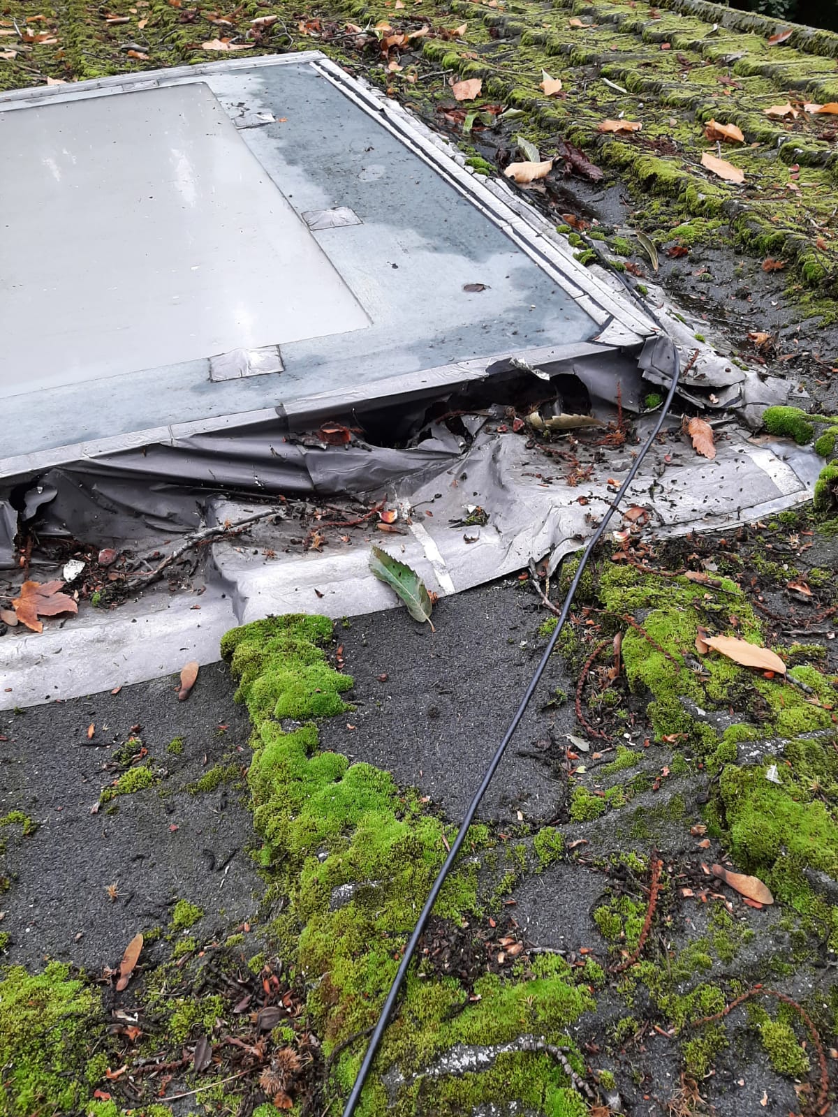

The images don’t really give much of a clue how the structure was weathered when built.
Your problem is that the correct way to weather to an upstand or side abutment is to create a hidden valley under the roof tiles or some form of continuous soaker…..without seeing how it was constructed, it’s not possible to know if this was done.
With the glass in place your only option is to weather on the face of the tile.….which is not really correct, but it’s all you can do.
Your starting point is to create a rigid upstand for any flashing material to stick to - It looks like the glass overhangs, so you need to fix some timber under the glass to come out flush to the glass.
You can then fix maybe a cut plastic fascia board to form an upstand.
and the flashing will need to be a flexible material -mayber EPDM strip, if that can be stuck to the decra face.
Maybe a liquid roofing system
I wouldn’t use fibreglass - those decra tiles probably move too much.
See above. You have inherited a diabolical roof, sorry. Decra tiles are like single use plates/cutlery that you sling after parties. They belong on shed roofs.

The roof is built over a bungalow which has been extended at various times over decades. About half of it was originally a flat roof (much of it seems to be something that looks like about 10" of compressed hay with a bitumen covering), with an angled cold roof (including the skylight) added on top. I think that at least that part of the many roofs (and probably all of them - see internal loft shots below) was only built to support a lightweight roof, which is what I imagine informed the choice of Decra Classic. I suspect this was all done quite some time ago (I'm guessing 40 years but really don't know).
Many thanks. Seems like a sensible and practical solution, given the circumstances.

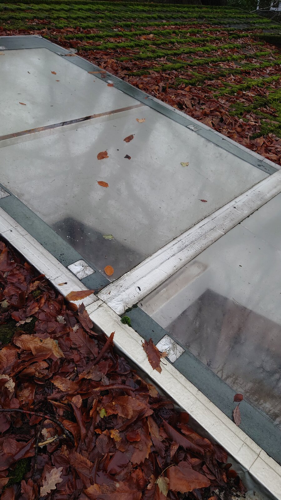

FWIW, the other side of other sky light, which has been flashed (I'm unsure when - I think it was originally installed c. 2006/2007) looks like this. I really should take some better photos ... and remove the leaves beforehand!
