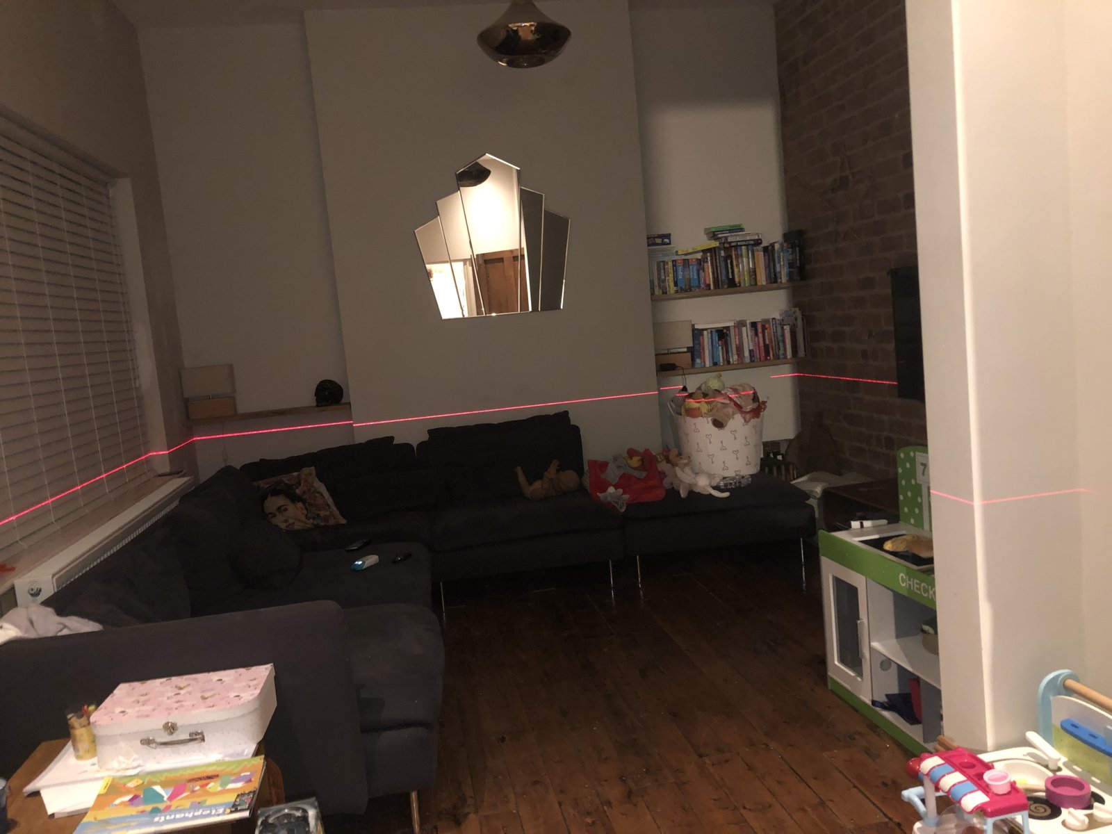

@juniper
It comes with a clip that is magnetic, and the back of the laser is magnetic too. I very rarely use the bracket as the magnet is good and will stick to Plasterer’s angle bead even once it’s been skimmed. There’s also a hole in the back so I’ll knock a nail I and hang it Over that aswell. The laser swivels so facing off the wall it fixes to I’ll swivel to the left when working on that wall and to the right when working on the other
The self leveller flashes of it tilted too far but it’s very forgiving.
It does vertical aswell and is accurate
To 0.3mm per metre so 1.2mm Over your 4m room

Will it beam a horizontal light across all 4 walls at the same time? Apologies if that is a silly question but I've never used one.
Whilst a 360 degree laser is nice (I use one for trade) it is going to be very expensive and not wholly necessary for the sort of use you will be putting it to. A cross line generally covers somewhere around 180 degrees field of view and TBH if set up in one corner and swivelled as required you should be able to cover pretty much all of the room with minimal movement. The main thing to be aware of is that with lasers the line has discernable width, so you need to set your "tick marks" on the wall at the middle of the beam (and you'd probably be amazed at how many idiots I work with who still can't get that into their thick heads). Even a 360 degree laser will have small "blind spots" (4 of them) where no line will be visible. This is because the protective cover over the pendulum has four metal legs to hold the top cover in place. The only way round that is to go to a rotating laser - a major step up in cost and frankly not worth for most tradesmen let alone a DIYer
The self levelling works by means of the lens assembly being mounted on a pendulum which is free to find it's own position. That means all you need to do is to is to physically set the level to within 5 degrees of level and the pendulum does the rest. Not all lasers beep if they are out of level - some of the older deWalts certainly don't, they flash, as do all the Bosch lasers I've used (although they do also beep). Worth bearing that some lasers (e.g the basic DW models) lack a pendulum lock. A pendulum lock allows you to use the laser to project a non level line, e.g a line up a stair wall to position a handrail. This can be useful in some circumstances. Also be aware that even lasers have a degree of error in them (they often run out 3 to 4mm level over 10 metres which is regarded as acceptable)
Line colour is another issue. More basic lasers use a red line, not a green one. This is more difficult to see in bright light (so you need to close the curtains/ cover the windows and set out in semi darkness), but they are a lot cheaper than green lasers. Green lasers are more visible in better lit conditions (because the human eye is more sensitive to green that red) but even they cannot be seen in bright sunlit conditions. There's nothing wrong with red line lasers (I used them for 20 years before going to a green laser this year), it's just that they are less useful in brightly lit situations, something easily overcome with a bit of ingenuity and some black Visqueen DPM
