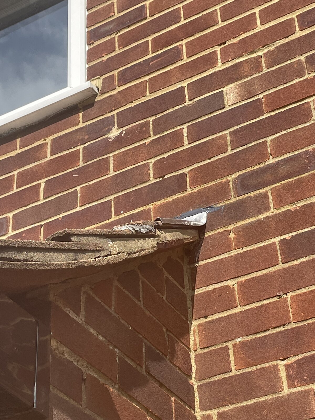

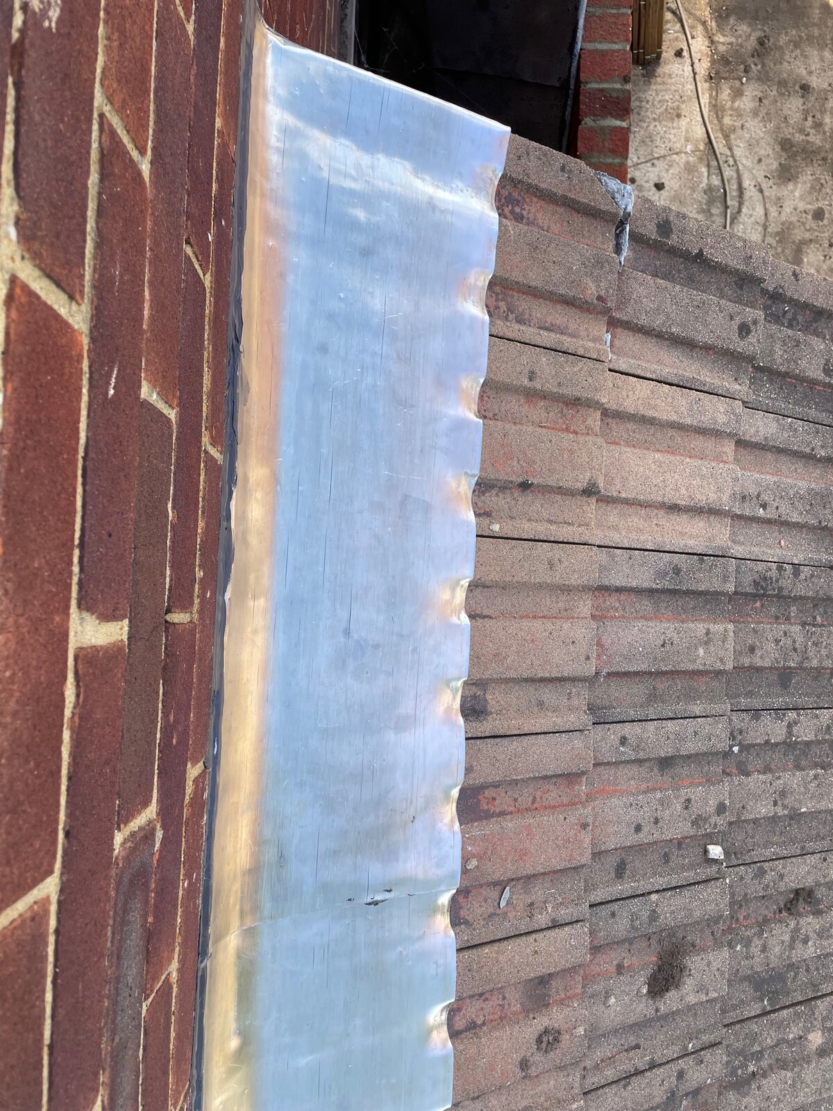

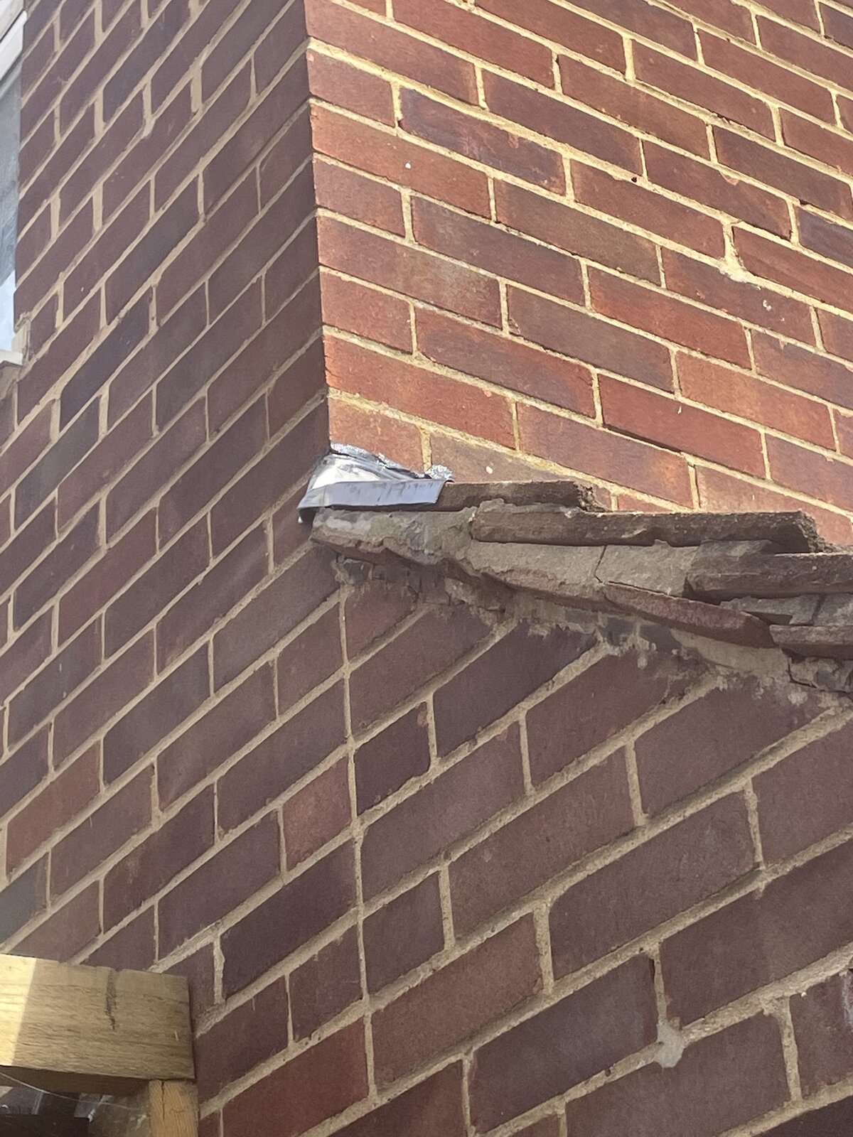

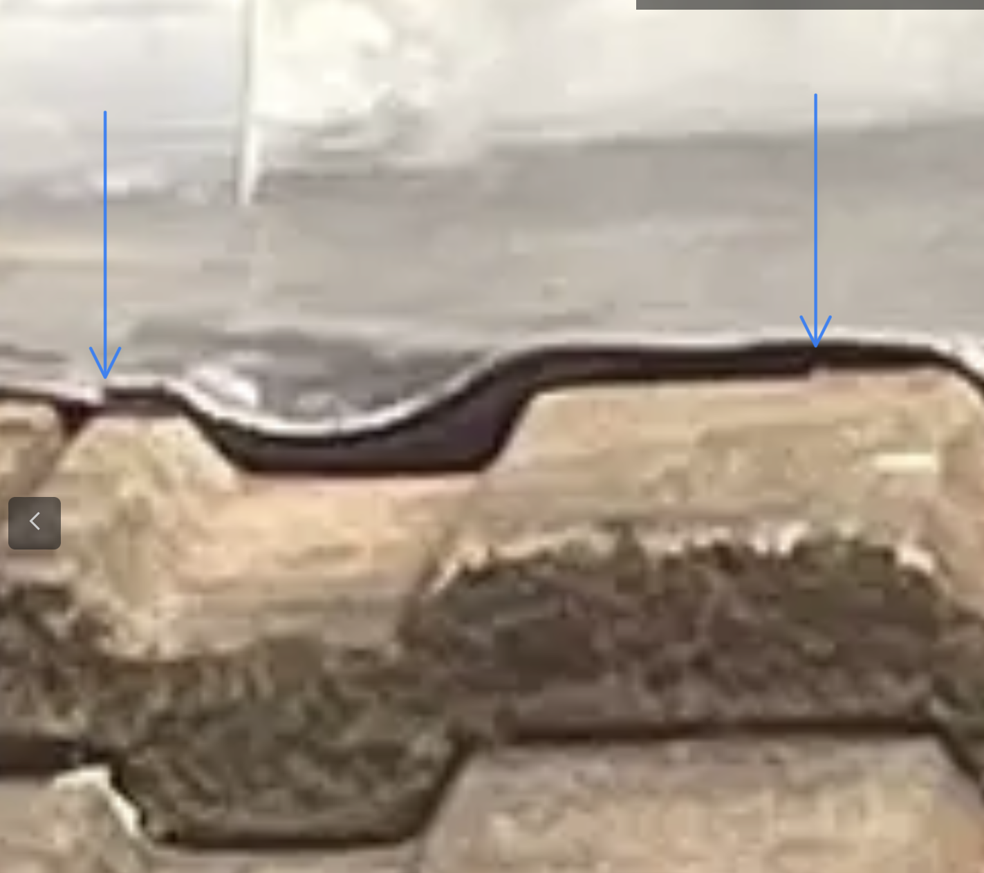

Hi,
Had some flashing replaced, does this look like a good job? Thought the flashing should follow the tile contours all the way but it's only partially done.
Ideally yes it should have more contact to the tile but as it is it will not leak. You could tell the roofer you want it beating into the channels a little more but chances are he will consider his work done and may ask for more money to do so. A decent roofer would have done a better job and so maybe his skill at leadbeating is limited and he didn't want to break any tiles.

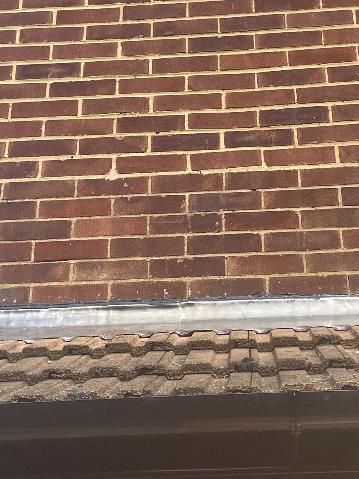

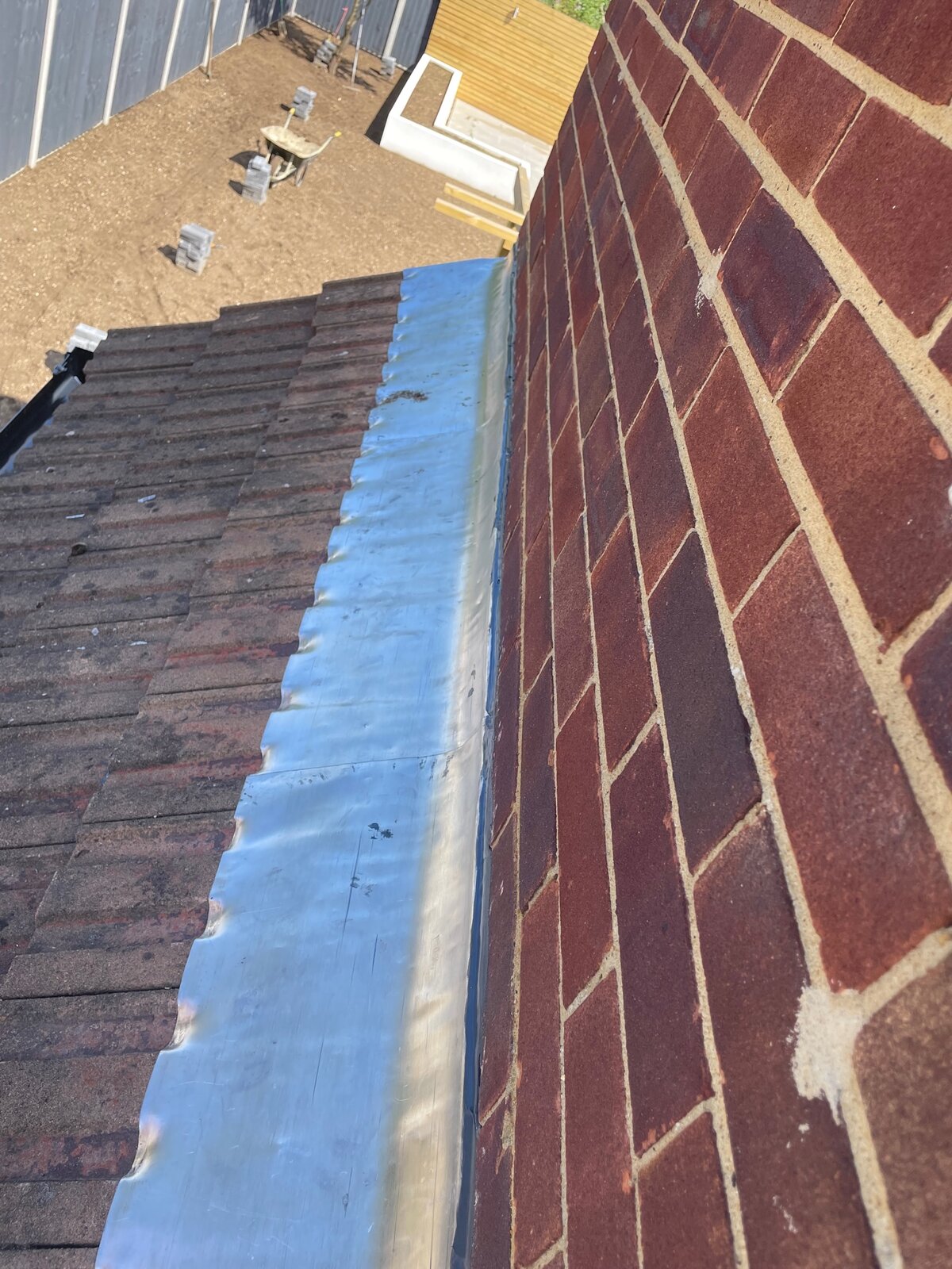

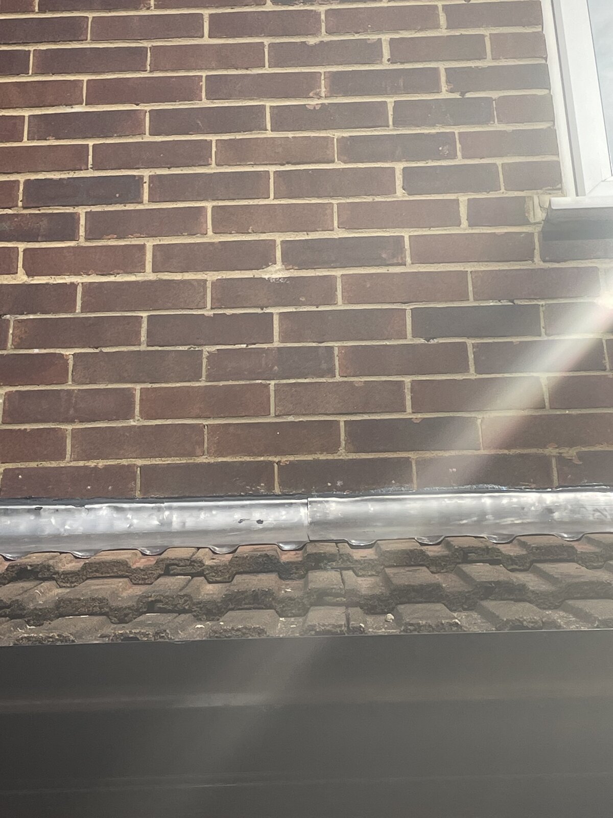

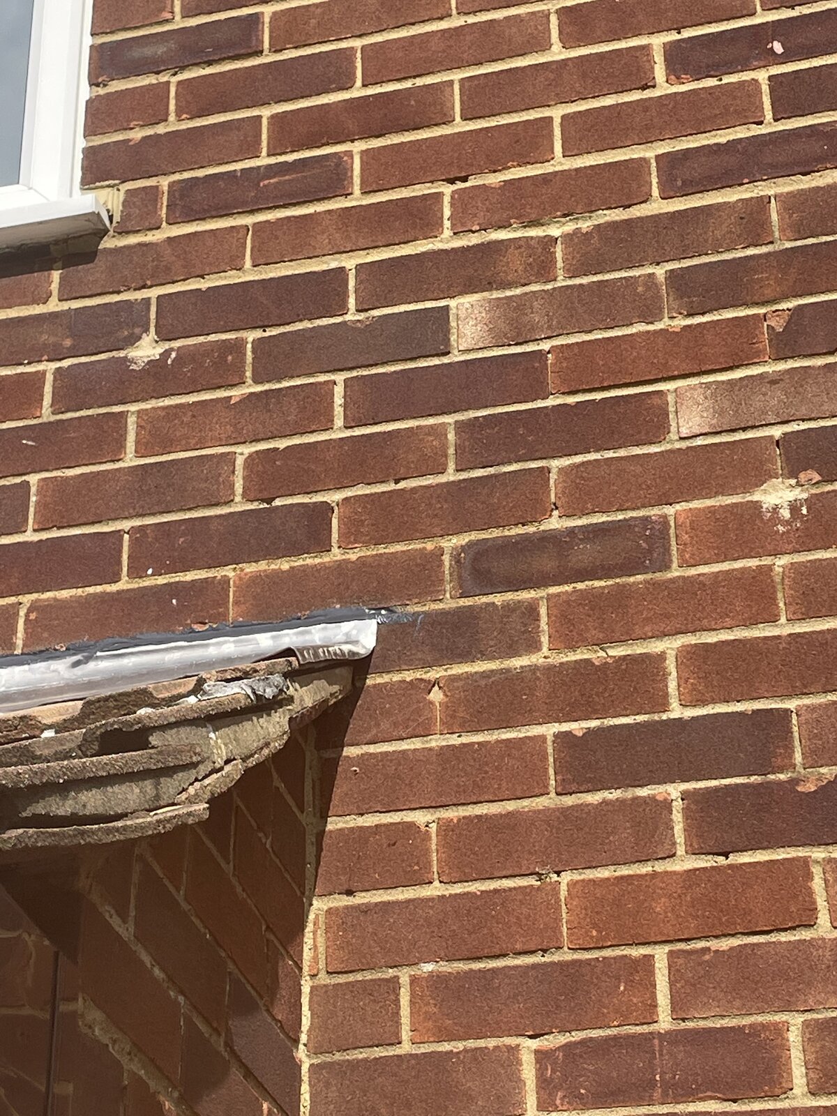

Thank you @DAZB. Also another thing I see is that the overlap between pieces only seem to be about 5cm, about the same width as a contour.
I've attached more photos, it's a bit hard to see as I'm on the ground.
Would this be an issue?

The lap should generally be 100mm or more so that is a bit lacking but could possibly never be an issue... or it could leak next week. The side laps are certainly too short and will not stop water getting to the verges which need repointing also. If you are getting him back then increase the laps on both ends and the mid joint and beat down the gap to the right of the mid joint lap so it doesn't look so bad.
Thank you all.
I rechecked today and it does seem to be about 7,5 and 11cm going left to right.
How long should the side lap over the verges be?
Does this mean having to buy lead to cut at least one new sheet, with the left three being reused or is it best to start from whole new lead for all sheets?
I will ask him back to fix.

Is it broke though? If the lower lead of an overlap is beaten into the tile channel there is no way the water entering the side will flow across and up the channel
Playing devil's advocate here - to get every channel covered all the way with lead it has to be bossed - bringing lead from the peaks to the hollows - then straightening the upstand ( the lead has to come from somewhere so it will thin slightly ) As a plumber I could have done it , but wold have explained to the customer. I would have probably done it a couple of inches more .But as robinbanks said it does the job. ;)
We tend to aggressively dress the very edge of the lead down onto the tile troughs. The rest gets a light battering. This way the lead isn't weakened and the critters cant get in.
