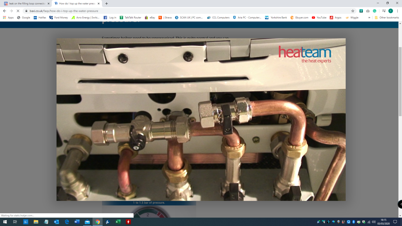

A pic would help.
Are you saying that it is leaking at the end of the braided hose that goes from one valve on the cold water main to the other valve that's connected to the flow/return pipe on the boiler? Are both black valve taps at 90deg to the pipe direction?
It's like this the copper 90-degree bend leaking on the brass nut that is screwed to the return iso valve on the right

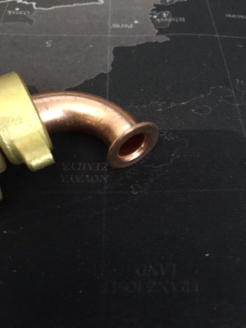

The copper end is like this I did change it about 12 month ago when I was changing a rad but I drained down the system.
don't want to do that if I can get away just draining the boiler. I tried the iso valve but water still came out.
You need a fibre washer on that fitting to make the seal.
If the isolator will not close the supply to that elbow then drain down.

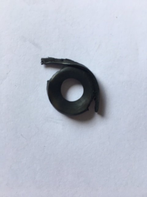

Thanks, guys just watched a youtube video I have now drained the boiler turned all iso valves off and opened the white drain valve on the boiler not much water loss this is the washer that was leaking so I will replace with a fibre one.
Thank's again
Careful then, if you replaced that a year ago then you have overtightened it, causing the washer to become damaged.
It just needs to be finger tight then 1/4 to 1/2 a turn and that should be plenty.
Thank's Madrab
Yes kept tightening to stop the leak yesterday but it got worse so did it just now all sorted now thank's.
