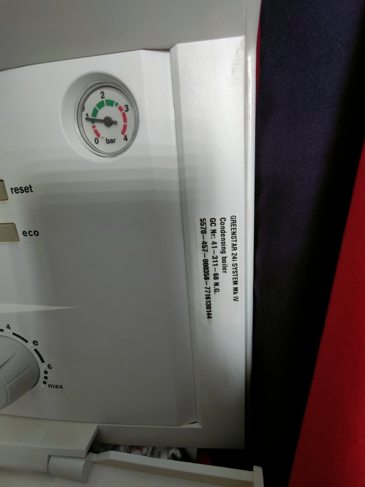

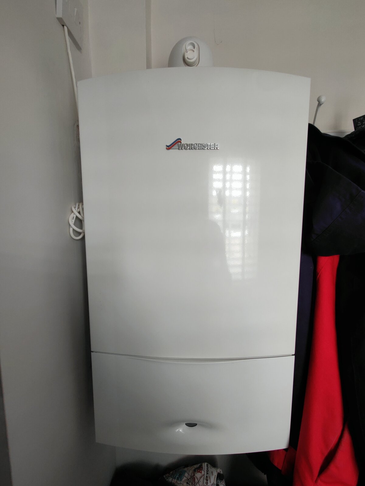

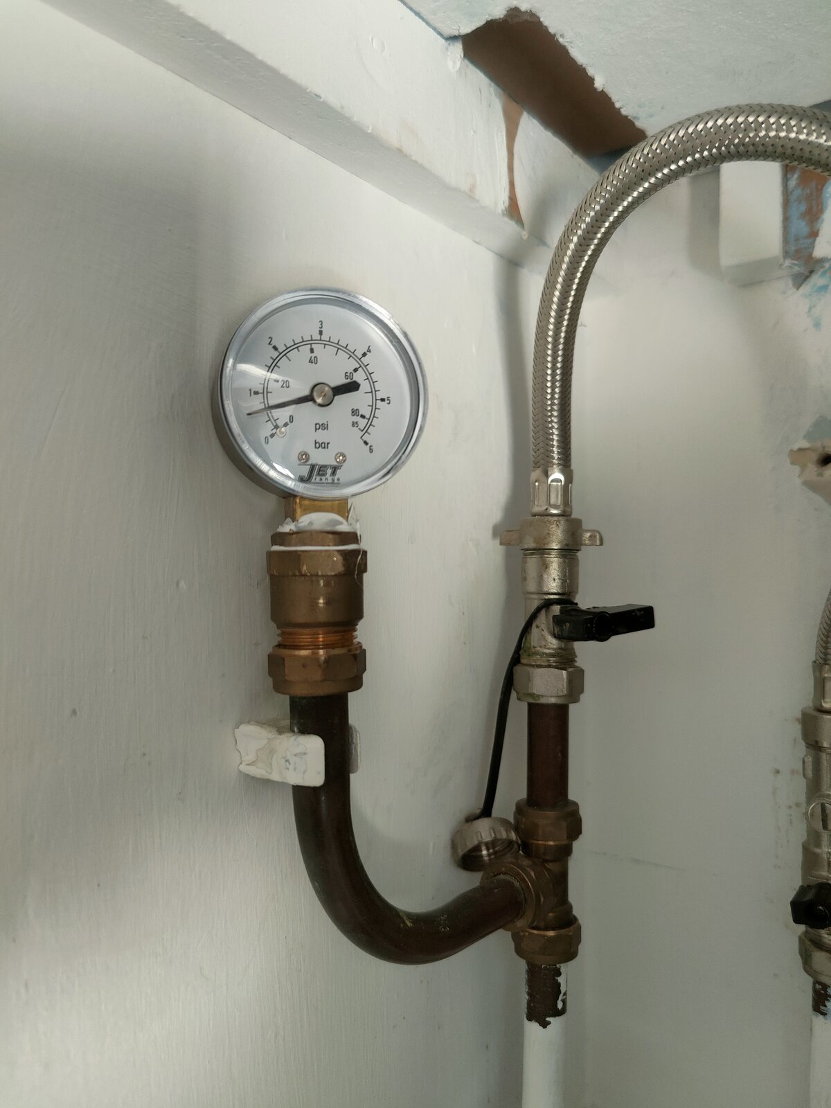

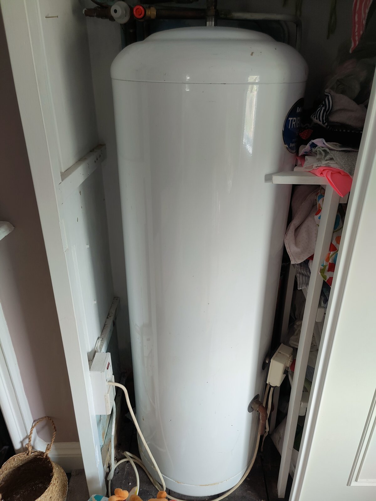

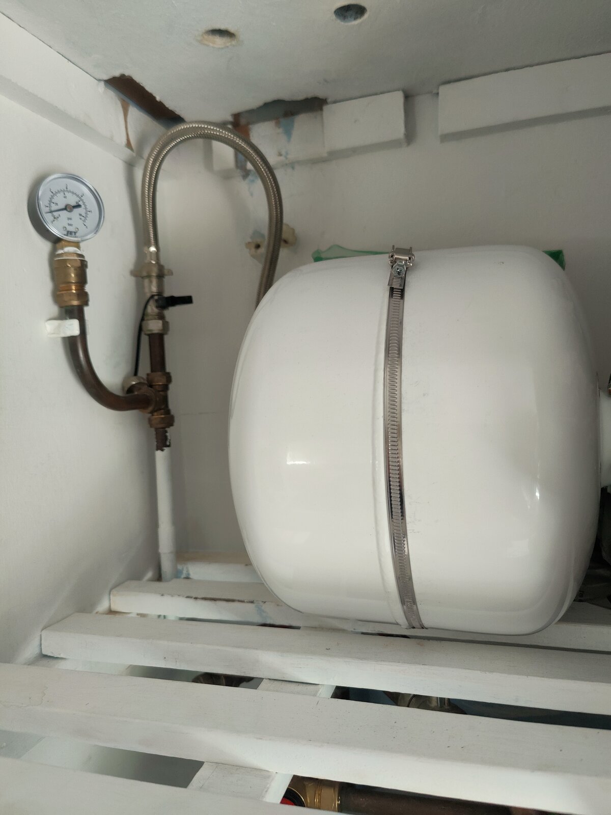

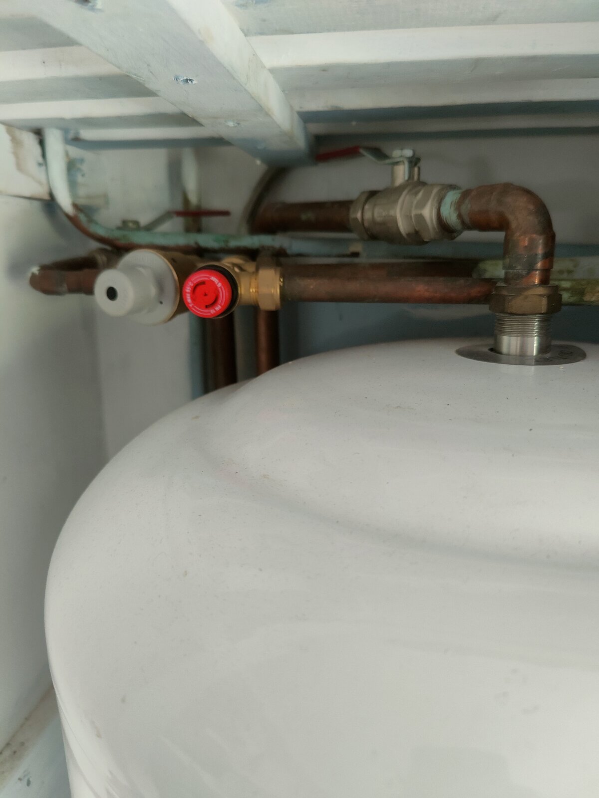

Some pictures of the system.
Water tank and it's vessel upstairs which the vessel was replaced. Pressure relief valves next to it which was also replaced.
Worcester boiler

Are you mixing up two systems? The unvented equipment has no effect on your heating system. The vessel near your cylinder may not be linked to your heating, and it is not usual for a tun dish to be used on a heating system. When you mention a PRV, is this a pressure REDUCING valve or a pressure RELIEF valve?
The vessel near cylinder is just for the water cylinder/tank. The boiler has its own vessel (appears hidden) at the back. The pressure gauge near cylinder vessel is for the heating system though. Yes, tundish is for cylinder.
It is pressure relief valve.
Hope this helps. Thanks

The boiler service was a standard boiler service, if this is part of standard service then this is done and checked. But i will also try to check if this was done.
Could the issue still be with boiler perhaps? Surely there would be some leaking around the boiler if the case.

you are confusing your systems, the unvenetd cylinder and the , loss of pressure on your primary boiler system, have nothing to do with each other, they are seperate mostly and if a problem you would get over pressurising rather than pressure loss, yor pressure loss on the primary system means either a boiler fault or a leak on the pipewrk somewhere, you boiler has its own expansion vessel and its own pressure relief valve, there will be a 15mm pipe from the boiler usually to outside, you need to check to see if any water is dripping from this, also set your boiler when cold at 1.0 Bar, then run the boiler with HW and CH both on for 30 mins and see what the pressure guage now reads, if above 2.7Bar your boiler expansion vessel needs re-charging
