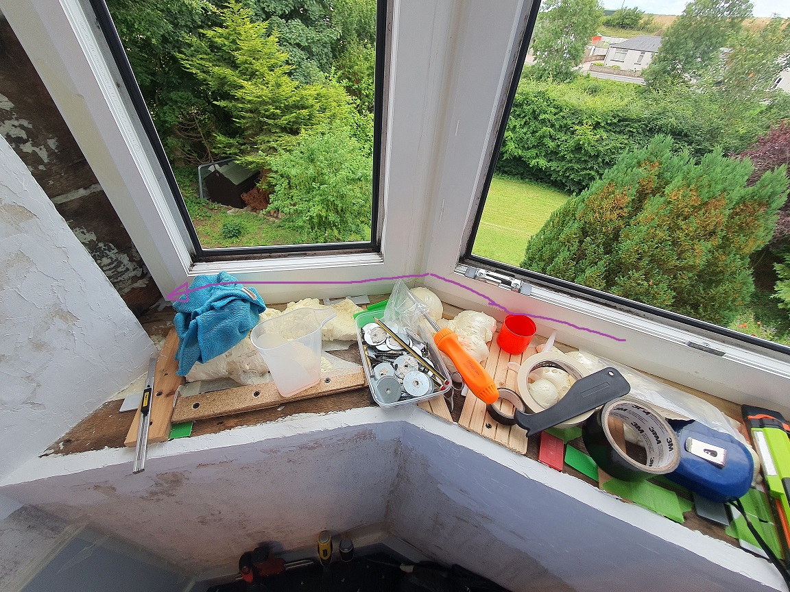

Evening, gents.
Got an issue with a recurring leaking window frame on a bay window that I have yet to solve, but think I'm on the right track now. This has probably been happening for years, but I only noticed when I ripped off the PVC window board during a redecoration in order to replace it with an MDF one.
There, I noticed on the left edge of the window frame, was water ingress that was soaking into the wood. This would occur after rain, usually when it was fairly heavy rain. At first, I thought the seals on the outside of the window were the culprit, as they were coming undone at the bottom of the frame, but that didn't seem to fix it either.
Then I learned about drainage channels, and today (after more rain and noticing it leaking again), discovered that my drainage channels appear to be blocked off by mastic that I just replaced (!). I have yet to remove it again and test to see if the holes are now unblocked, but wanted to get you guys input on this. I did pour water into the drainage hole of this particular window after pulling the window out of the frame, and did indeed have water trickle out of the open edge of the frame that I have pictured, where the water was ingressing, so it feels like the culprit to me.

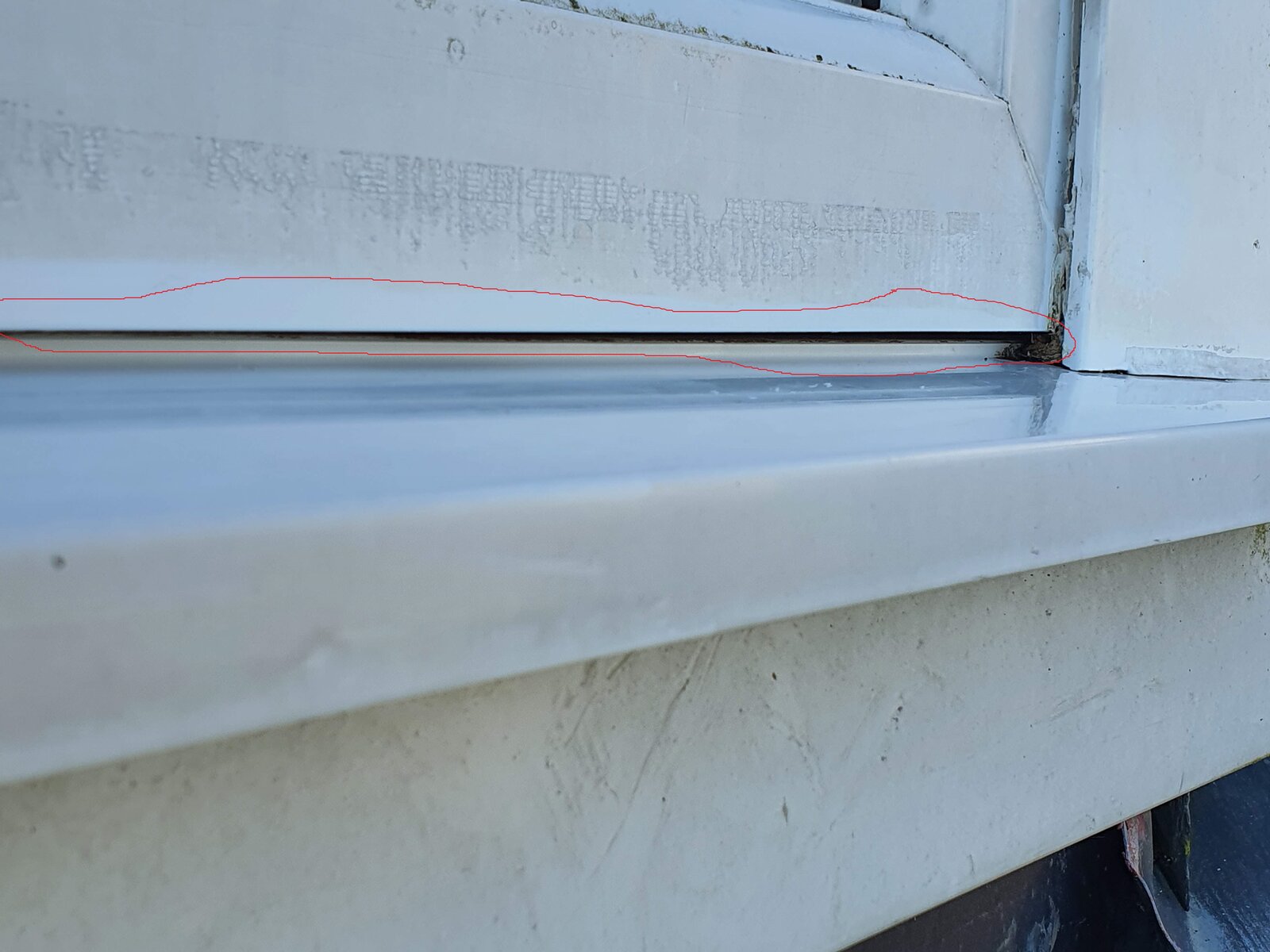

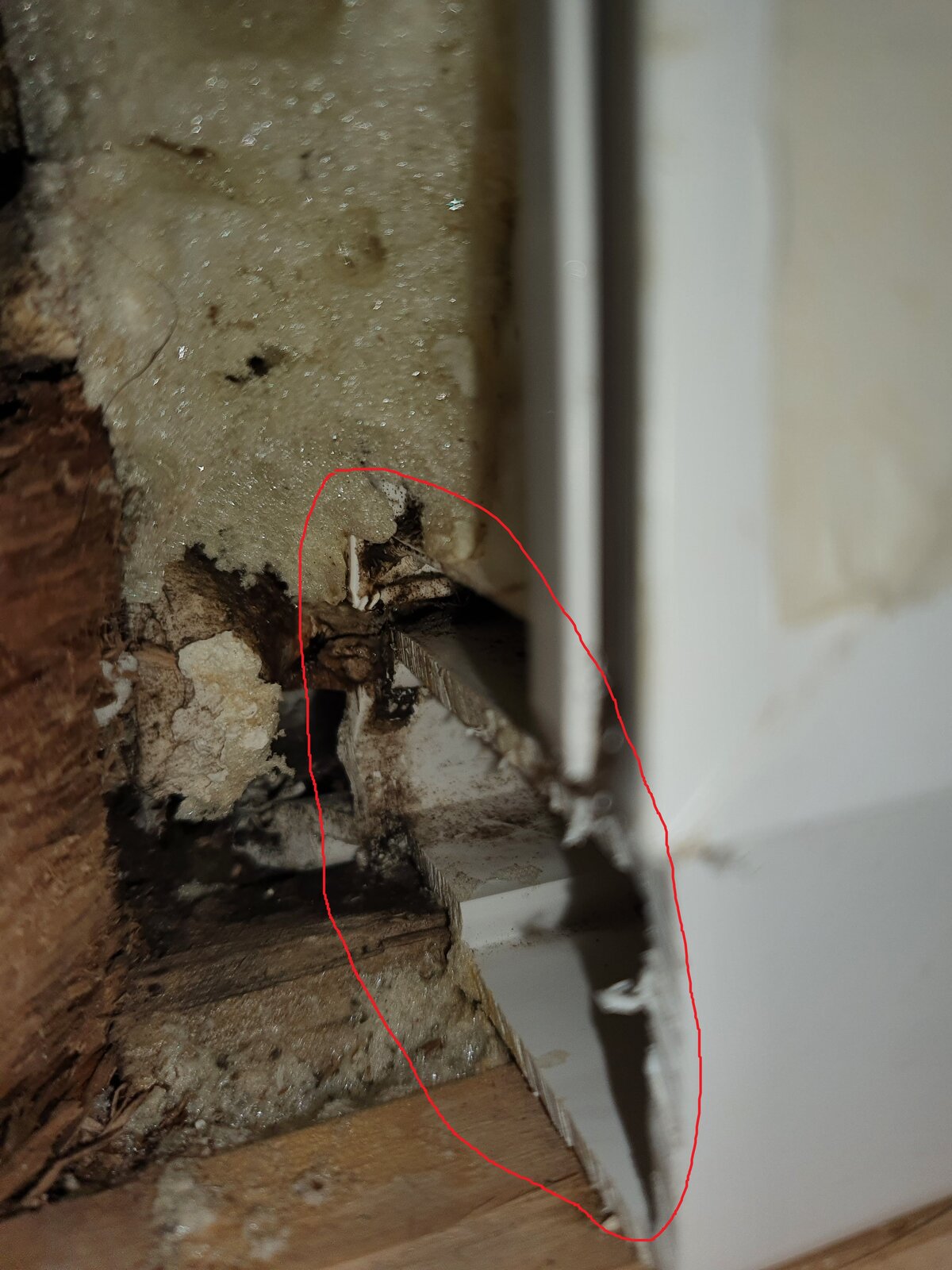

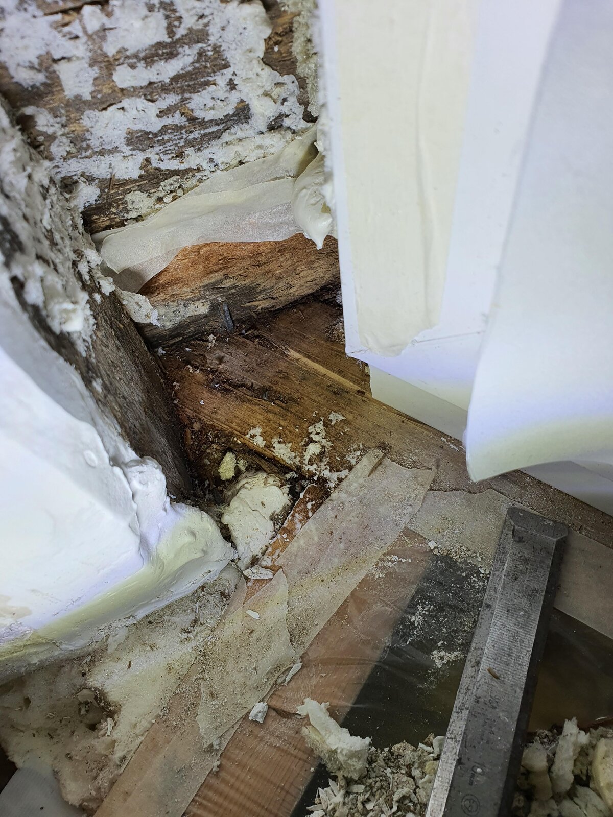

I have uploaded pictures showing:

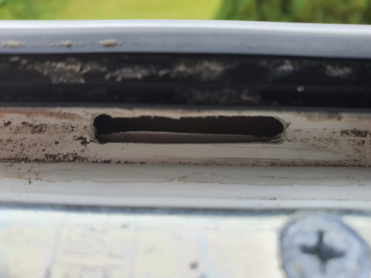

1) The area where the water is ingressing, you can see the wood that has become wet there.
2) The actual location the water is coming in from. It appears to be coming in from those channels at the edge of the frame... are those holes supposed to be sealed off at the sides? I had to hack away at foam to get here, but as foam isn't waterproof, that wouldn't exactly count as sealing. Circled area I'm talking about in red.
3) The outside of the window frame, before I (incorrectly) sealed it back up. I have concerns about that black line above the 'lip' at the back of the sill. Is that supposed to be there, or has the frame been fitted incorrectly? If it has, what do I do? Would sealing in the gap (but leaving the drainage holes exposed) work? Again, circled in red.

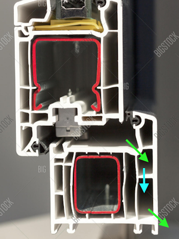

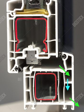

Well, I did more searching and found a picture of how the window would roughly be constructed, and it makes more sense now.
So that gap pictured on the outside indeed shouldn't be there, and the windows weren't installed correctly all those years ago. The question is, how do I go about correcting it? It'd be a bit of a bodge, but would just gunning in a bunch of mastic do the job (while leaving the drainage hole exposed)? I realise that long term, the only solution would be complete replacement, but if I just keep an eye on the mastic every year or so to ensure the seal is good, it should do for now.
I also presume that gunning some mastic on the exposed end to stop water dripping off would be in order too. I did think about gunning some foam in there as well, but that's probably a bad idea with uPVC due to warping if I remember correctly.
I did notice that over the years this particular window would always feel colder and condensate much more than the other two next to it, and I'm guessing this is probably why.

Update: I'm still having issues with this window.
I thought I'd solved the above, but apparently not. I'd gotten around to opening up the weep hole on the left window frame, and carefully sealing all around it, which stops any outside water ingress but allows the weep hole to drain. Job done.
I moved on to removing the sealant that was blocking the weep holes from the middle frame, then poured water in to test drainage. It appeared to drain fine.

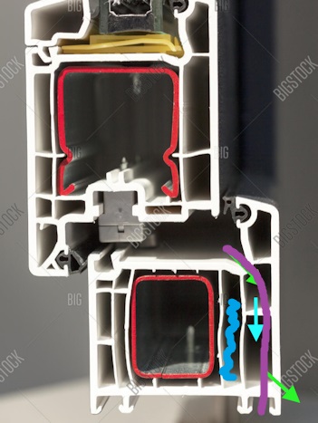

Then I noticed the area that I mentioned on the first post that was leaking heavily had water all over the place! It seems that I may be buggered here, if water is somehow leaking out of the drainage channels, down into the framing channels and ending up in a cavity? How is that possible -is the middle frame defective?
The water is following the direction of the purple arrow on the attached picture. The frame is slightly non-level to this side, which is probably why the water ends up there.
The water is draining out of the large open channel on the lower half of the red circle in the above image.
As I'm unable to have the frame replaced, I'm not sure how to fix this. My father suggested that, if something is busted inside the frame in the drainage channel that is allowing water to burst out underneath the frame, then we skip the drainage channel entirely and drill holes straight out, gluing tubing to allow water to drain straight outside. Seems like it would work, but look a bit naff.
The other thought I had is, maybe the weep holes were drilled incorrectly to begin with?
In the above pic, I notice a weird plastic 'lip' on the inside of that hole at the bottom - is that supposed to be there? Or is water draining down into it and ending up in a part of the frame it shouldn't be, and that is why it is leaking? Really hoping that it is as simple as this, as then at least I could just seal the holes up with Stixall or something and drill new ones.

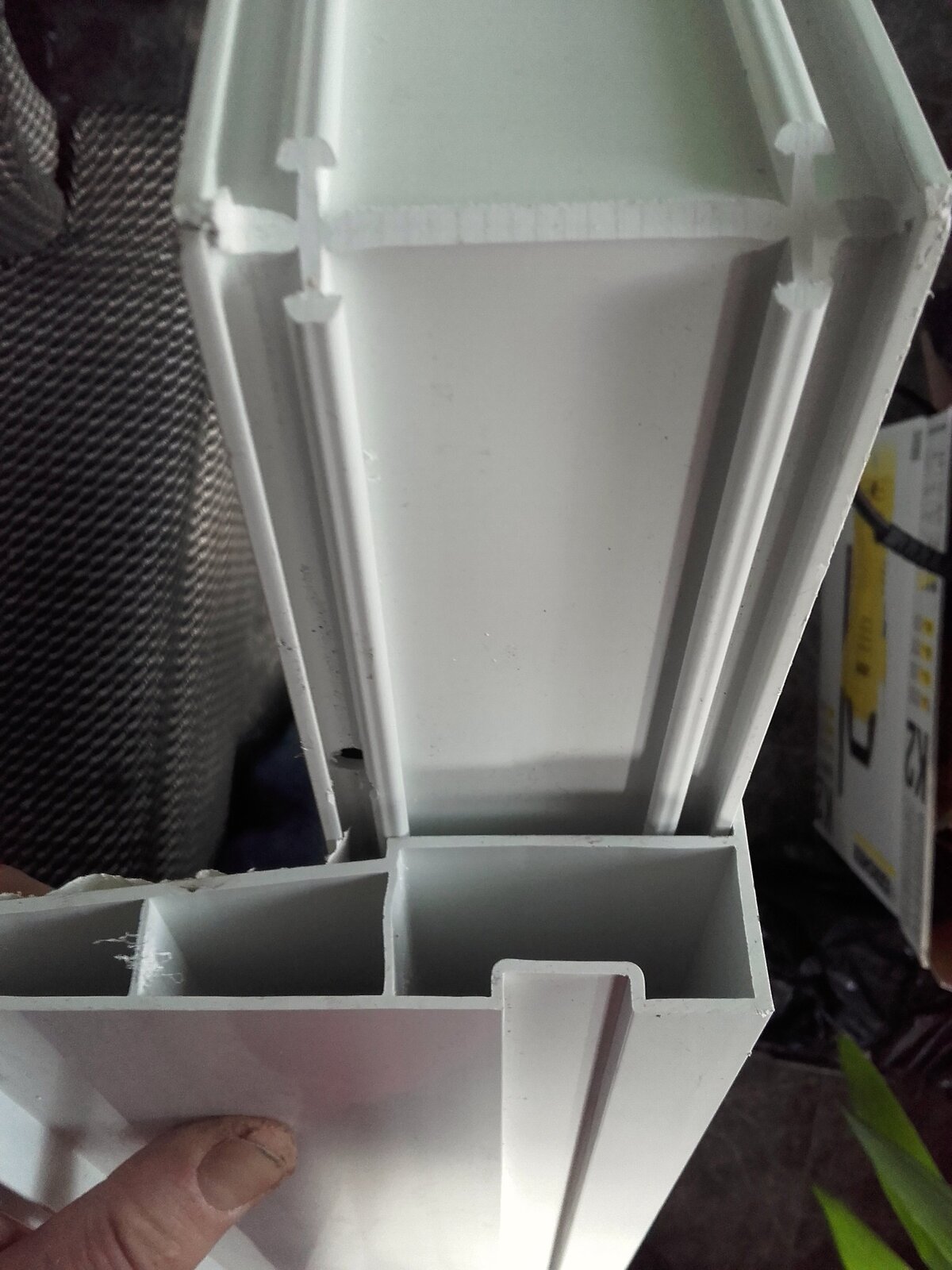

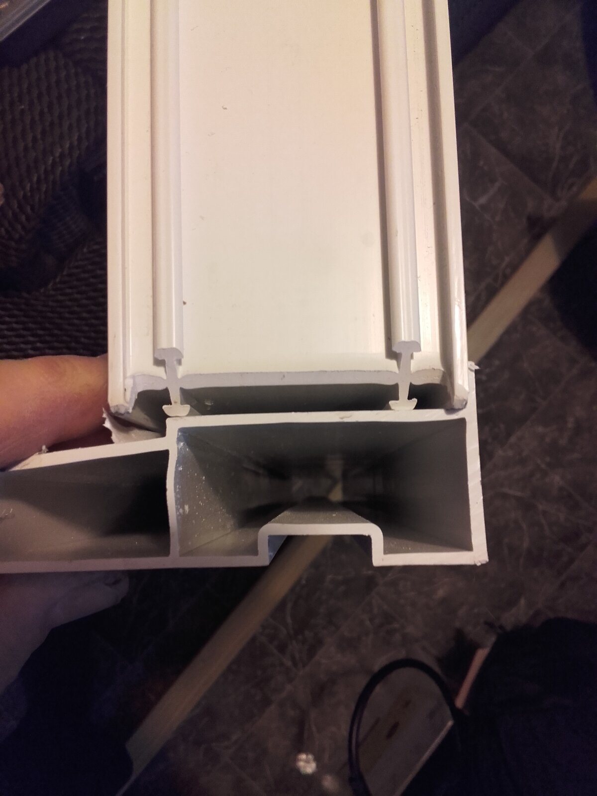

If you Google upvc window cross section you'll see how these windows are constructed. Normally they're modular in design and the drainage holes allow water to drain down the front cells and out. Like this:

There are no screws in the bottom of the frames other than espags ones, fixing screws are on the top and sides instead, which holds them together (you can observe this on the picture I scribbled the purple arrow on). So there wouldn't be any punctures there.
As for the weep hole exits, in these windows it would go as follows:
The pre-drilled holes exit right out the bottom, so they are not visible from the front.
However, see that thin bit of plastic acting as a wall to the left of the weep channel? If you look at the last picture I posted again, that seems to be what that 'lip' is, so water would be getting into where I'd scribbled in blue... maybe it's also breaching into the rest of the window frame as a result?
If you have a syringe or something similar, try injecting water into the drain hole ensuring you do it over that lip, then check to see if water getting out at open end of cill. Make sure you do it a few times to ensure enough water goes in. If no sign of water, do it again but intentionally inject the water this side of the lip i.e. so the water goes down that part. Then check again for water at the open cill end. This will help prove if your theory is correct?

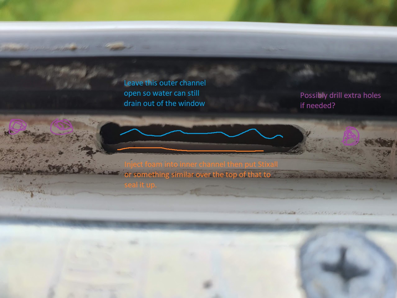

Hi, let me try to explain with one of the pictures, easier that way.
I have confirmed that the inner (orange) channel is not connected to the outer drainage channel (blue), and that the inner channel is responsible for the leaking (I tested it after my last post by injecting lots of water into it, no water came out the weep holes and it eventually started spilling out of the side of the cill as expected). I am guessing there is a hole or something in there and it is draining into the interior of the frame, probably corroded the hell out of the stiffening bar if it is a steel one!
So my idea was to put some foam into that inner channel, mostly to give the sealant something to stick to, then smooth over it with sealant. I figured it would be easier to leave the hole partially open (the blue part) so that water could still drain easily, as it looks like sealing this whole hole will be fairly difficult to do properly?
And if I end up needing to seal it all entirely, then drill the purple holes instead.
Ah right, I've got you now.
Does the plastic flap that separates the outer and inner sections move? i.e. can it be pulled towards the inner section of the frame (where your orange text is)? If yes I'd do this (disclaimer: don't blame me if the house floods!):
1. Inject sealant where the orange line is, also going to the left and right beyond the ends of the drainage hole. If need be buy something like this to get in there:
2. Pull the plastic flap towards you, closing off the gap and enabling the sealant to grab properly. If need be i.e. if the flap just wants to ping back to its original place, keep it in place by temporarily putting something in the hole (e.g. crunched up bit of tape or something) to stop it pinging back to its original place. Hopefully that makes sense?!?
3. Next day it should be secure. Finish if required by putting sealant over the newly sealed edge, just to make it smoother for water to traverse. Might not be required though if the first lot of sealant adequately fills the void and has a smooth top surface.
4. If the plastic flap doesn't really move, still do the above, the only bit you'd leave out is trying to pull the flap towards you. If it doesn't want to move, just seal up the void as per rest of my instructions.
That should be job done. Let me know how you get on.
p.s. remember to test it once sealant fully dry to make sure it's actually worked :)
