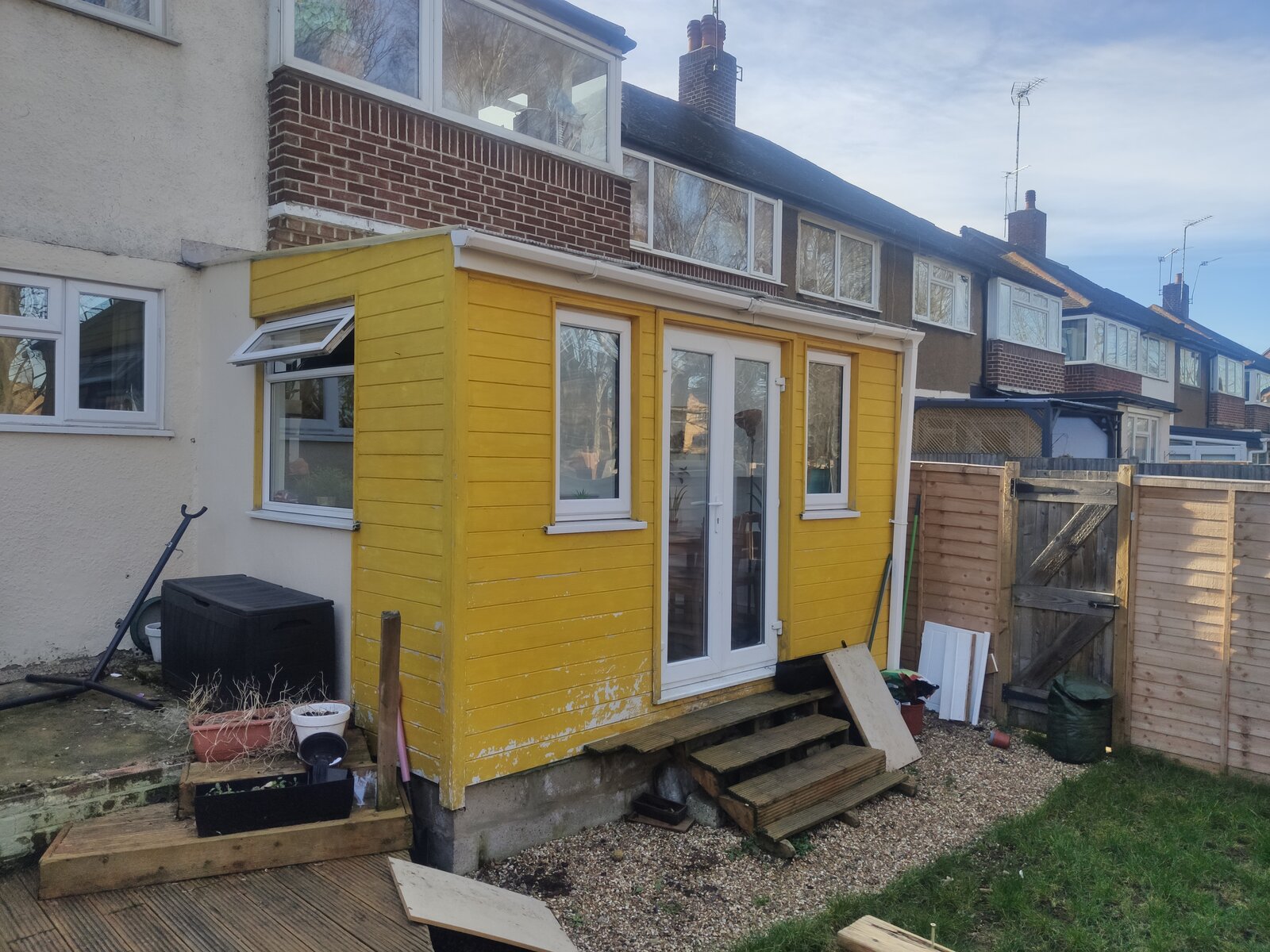

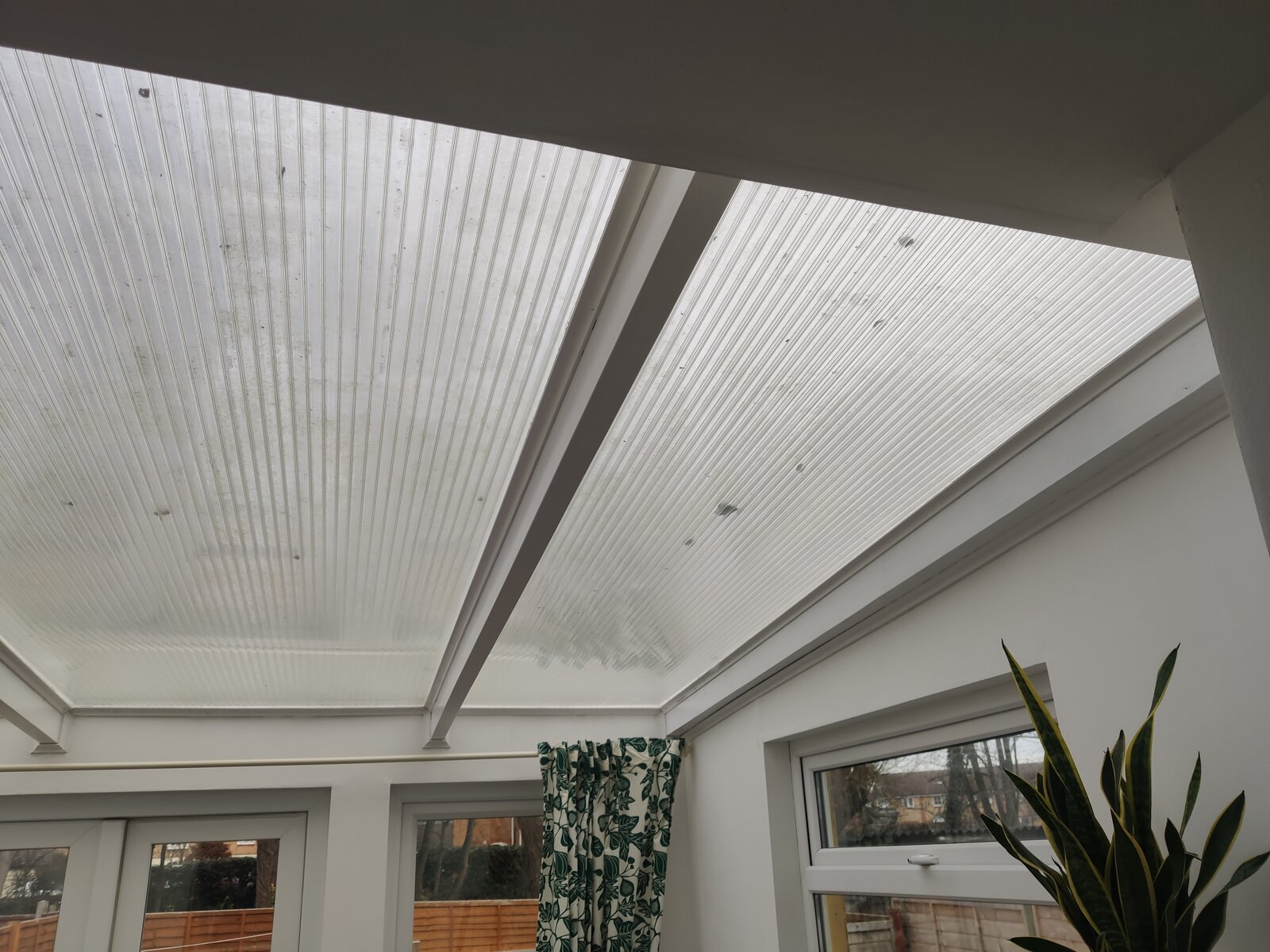

Thanks for the answer that's really helpful. The beams seem substantial 100mm x 47mm, there is insulation in the walls and wooden cladding on the outside, in total the walls are probably 200mm thick altogether with double glazed windows and doors.
I really just wanted to see if that seems at all feasible before I bother a roofer to come have a look. The foundations are blockwork to around 450mm from the ground but as I'm not an expert not sure if that's a lot. Funnily enought there seems to be a few structures just like mine along the street so maybe that was just a thing they did at the time.

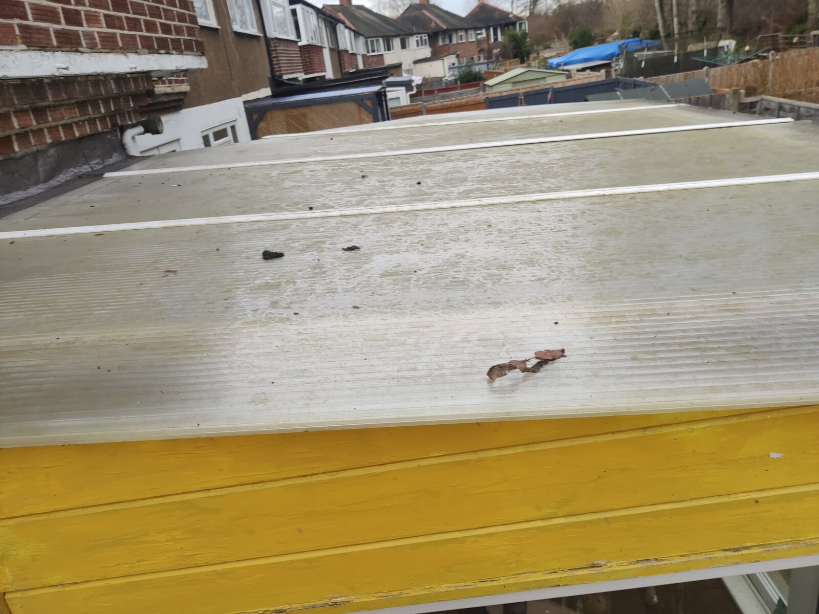

If I'm honest I don't mind what material will be on the roof as long as it provides at least decent heat insulation but I think concrete tiles would be to heavy. What I had in mind was plasterboard from the inside with some insulation between the roof. I would lose a lot of light but at least the house wouldn't hemorrhage heat. As the polycarbonate seems quite old it would probably makes sense to replace it with something at the same time

It’s going to be expensive doing something to that, I built a large back door canopy that has a roof similar... but it’s only to stop rain, wouldn’t want to spend time under it.
Your roof timbers look too small and too far spaced to be much use.
So they will need replacing.
You could do with seeing how the walls are built, but I suspect will be undersized to support a ‘proper’ roof.
I’d start again to be honest.
If you really want to proceed, you need to be looking for lightweight roofing.
Then wang in a decent thickness of insulation. What insulation type/thickness. Is in the walls?

Good news is you could put a warm rubber roof on the structure you already have, as long as you add new joists between what's already there.
The bad news is it will go dark!
That's probably a part of it. Thanks I'll look into warm rubber roof. Is it normally lightweight? Will it be supported on walls with timber frame?
