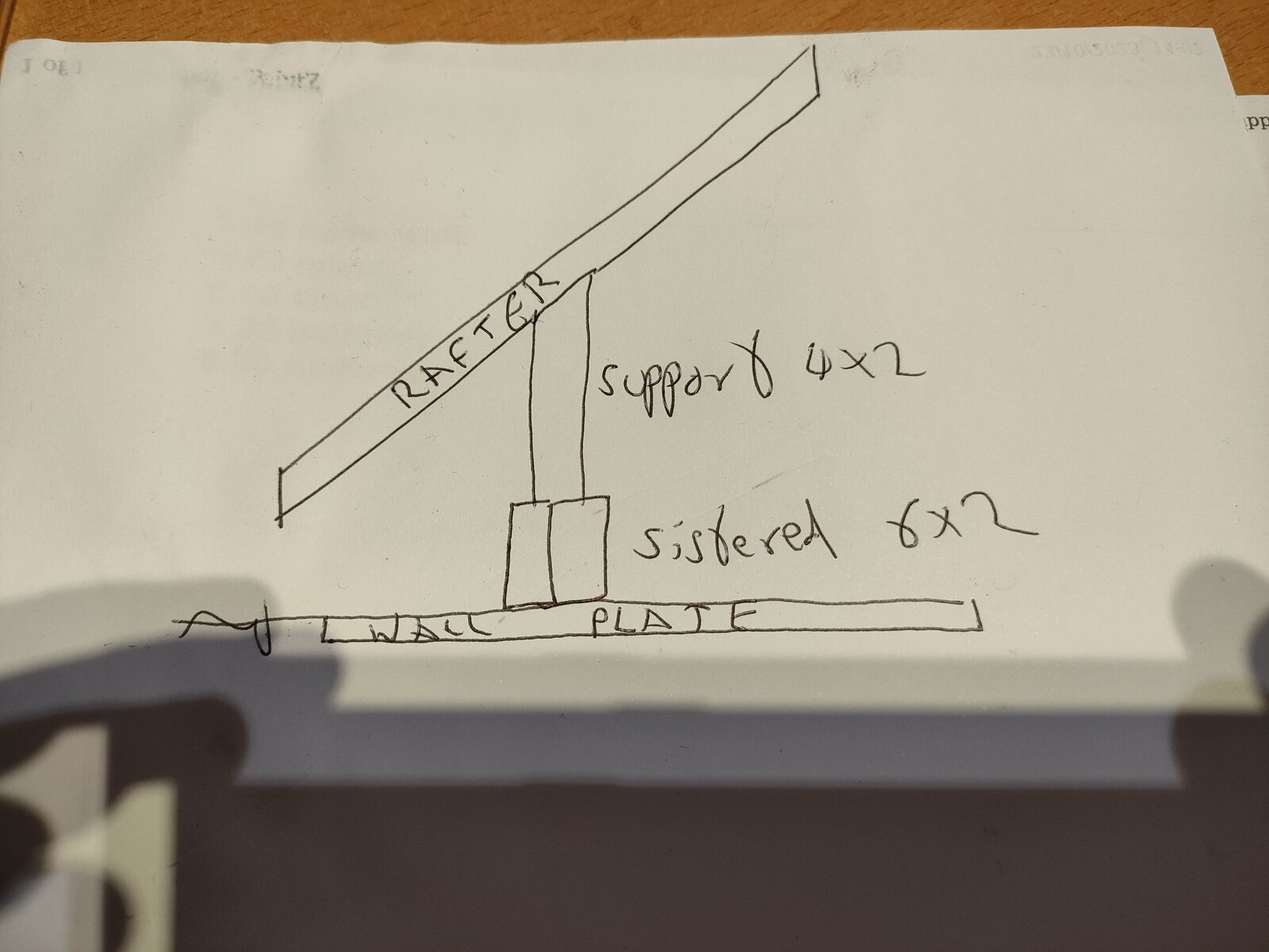

Thanks Notch. If I did that, would the purlin be horizantal from side to side resting on the wall plates? Something like the attached ?
Supposed to be side view so only showing one of the rafters.

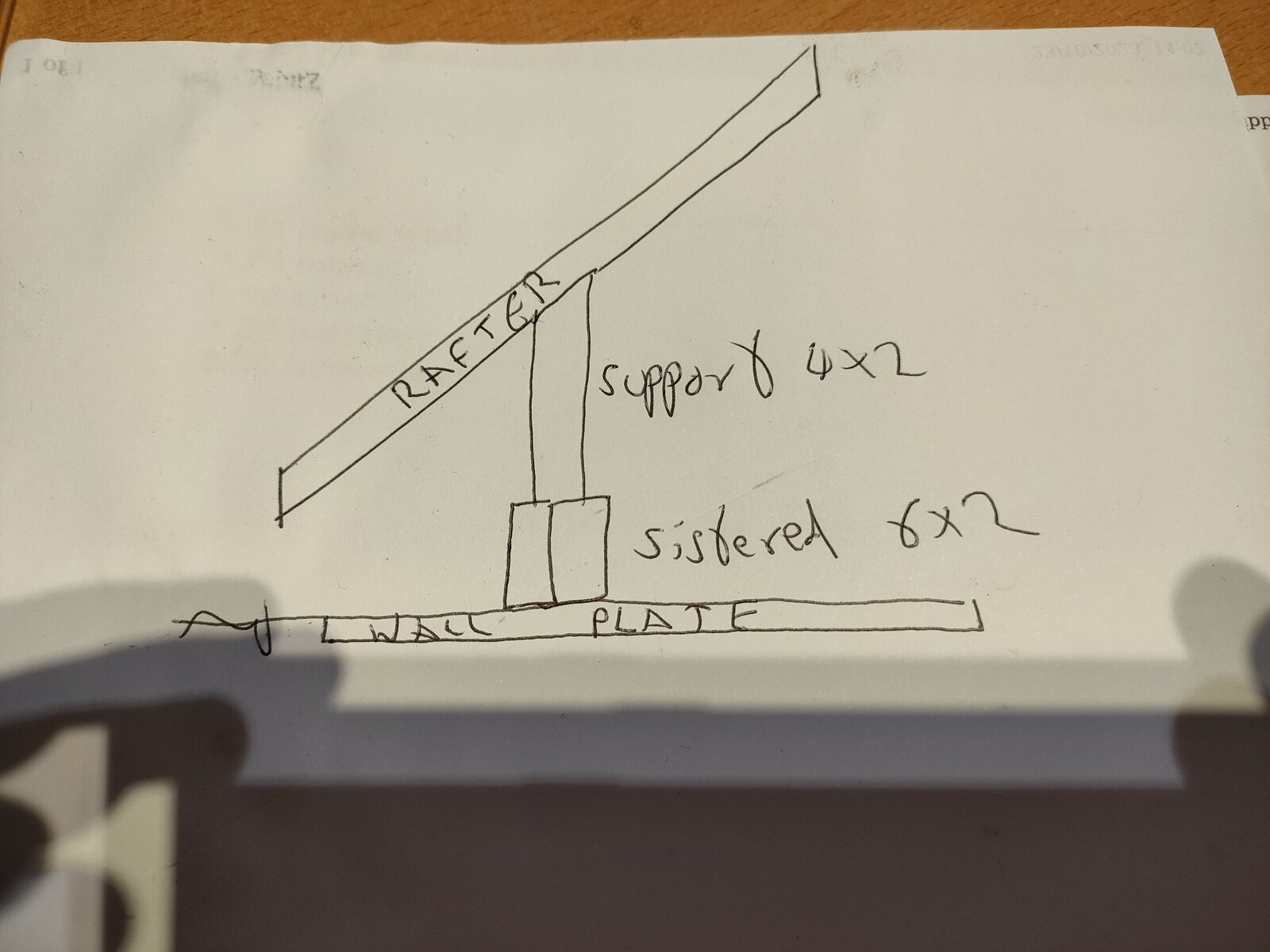

If you are doing it as per your sketch the purlin would normally be set at the roof pitch as well as the purlin props - but If it’s a shed, I’d make the framework to be the underside of the rafters, then set the purlin into the framework, in which case set the purlin vertically
I suppose it depends on the pitch, but if you are doing this under permitted development it can’t be very high

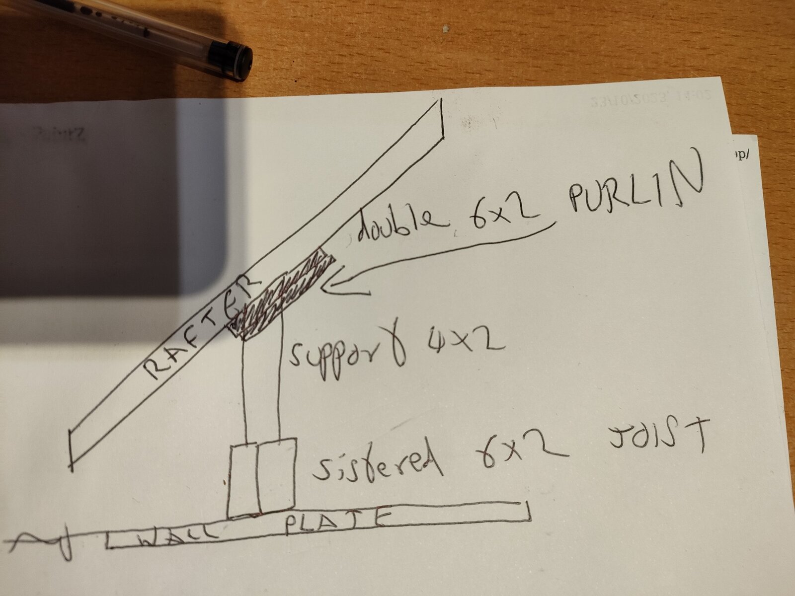

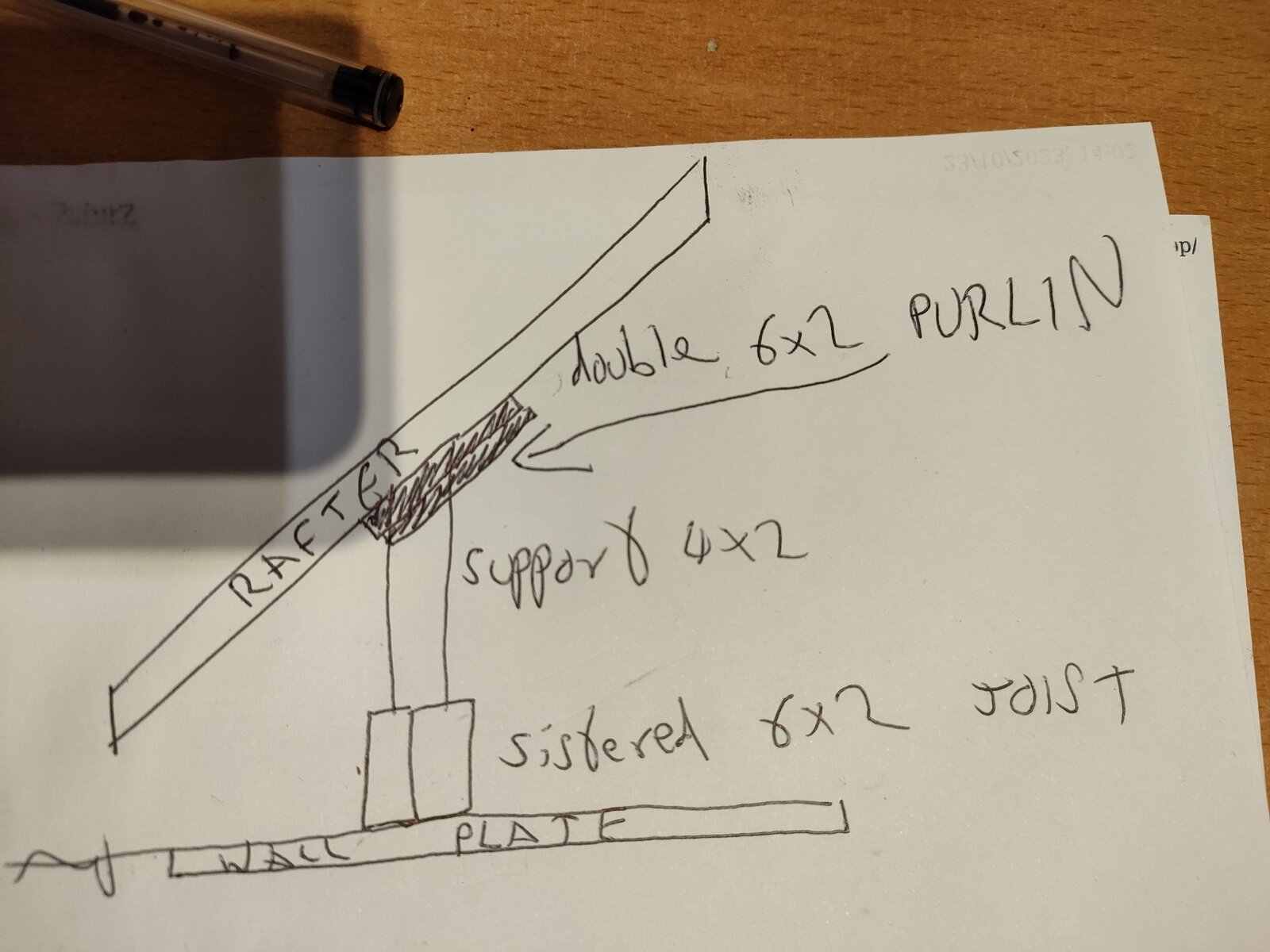

I've updated my back-of-an-envelope and put the purlin directly supporting the rafters. Not sure I fully understood you but am I closer to what you are suggesting or have I got it totally wrong (!) ?
Won't get into planning etc just yet but pitch will be as low as I can but could be as high as 15 or 20 degrees.
