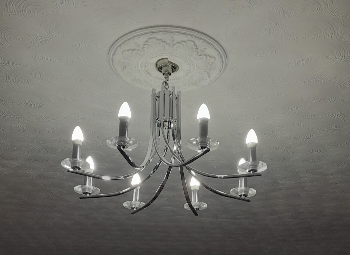

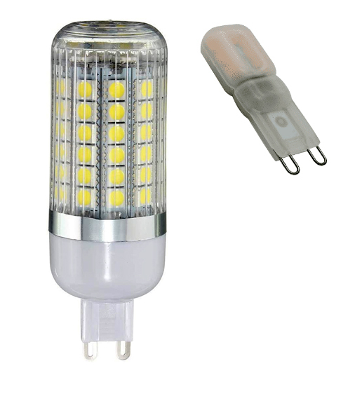

I have an electronic switch, not a dimmer, but is electronic without a neutral, the 8 x E14 bulbs are not dimmable, 20220415_000328_1.jpg but to me they seemed to work OK. However they gave my daughter a headache, the switch went faulty and was removed, and daughter has stopped complaining. As to if due to electronic switch can't say.
These two bulbs, G9-comp.jpgare both G9, the small bulb had a shimmer when on with the electronic switch, the larger one did not, and when one failed and I opened the bulb I found a large smoothing capacitor inside, nearly as big as the smaller bulb.

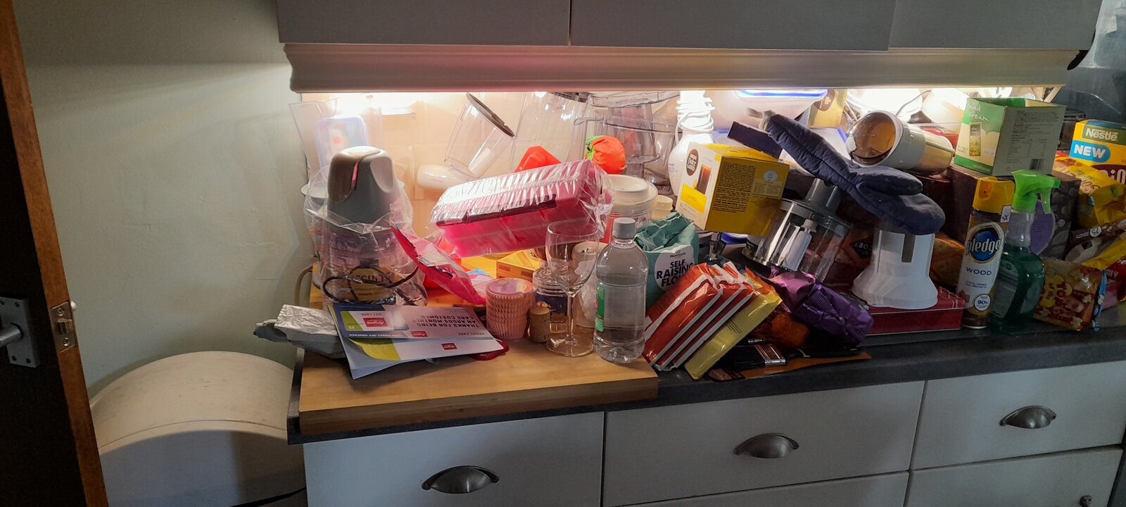

I do have dimmable lights in the kitchen, 20220626_085339.jpgLidi-Smart-strip lamp.jpg they work well as counter top lights, and at full 22 watt output it is a little OTT. I fitted them as originals failed, and the light strip was on offer at Lidi, I don't know why I bothered, as wife rarely turns them on, however also rarely see counter top clear, may as well just fit more cupboards in the space.

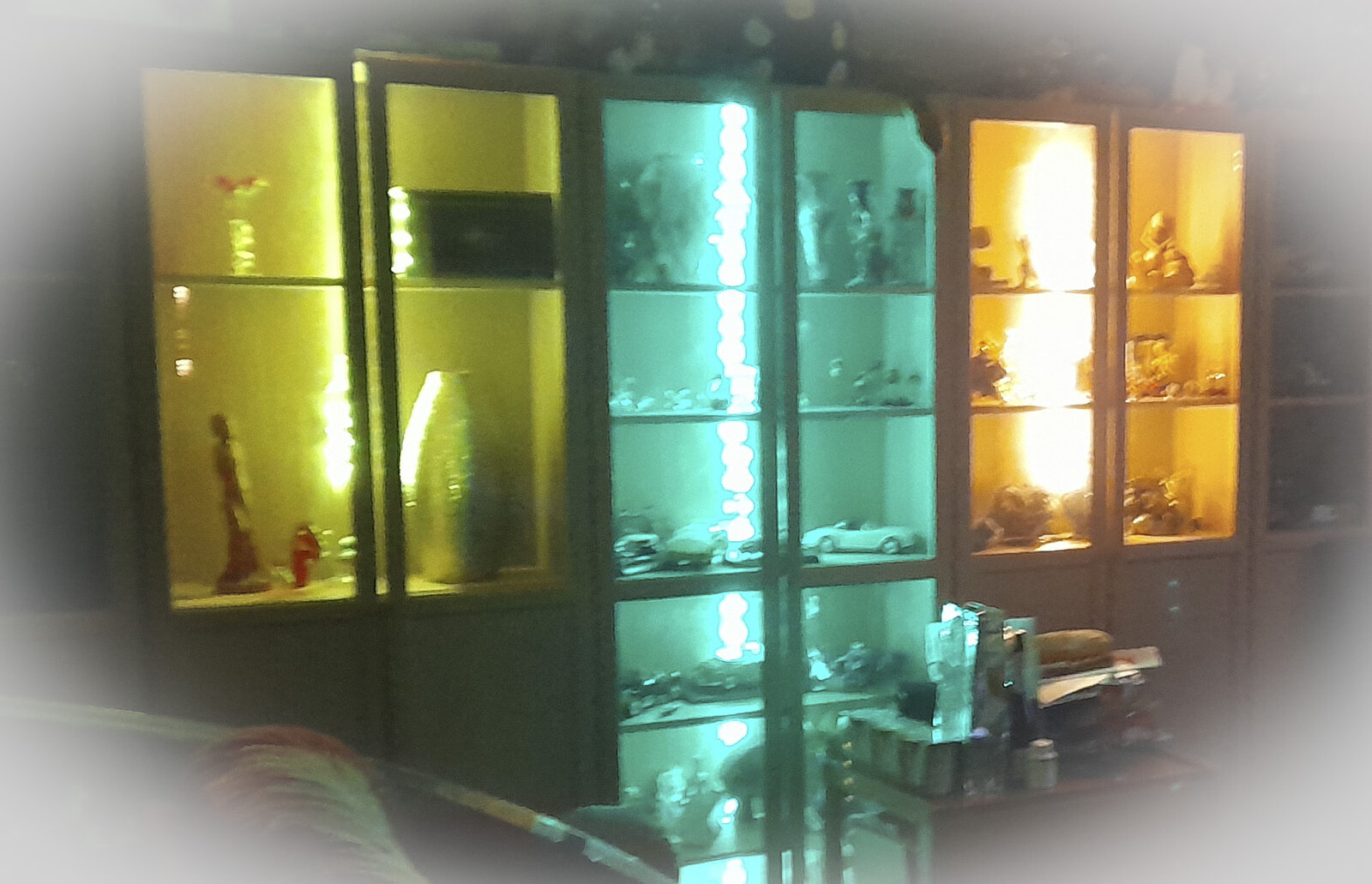

We do use the display cabinet lights 20220704_220311_1.jpg but only because I have set a timer so they switch on in the evening to light our way to main light switch should we dose off watching TV. Either side Ikea lights, centre another Lidi strip light. The two to the left are colour changing.

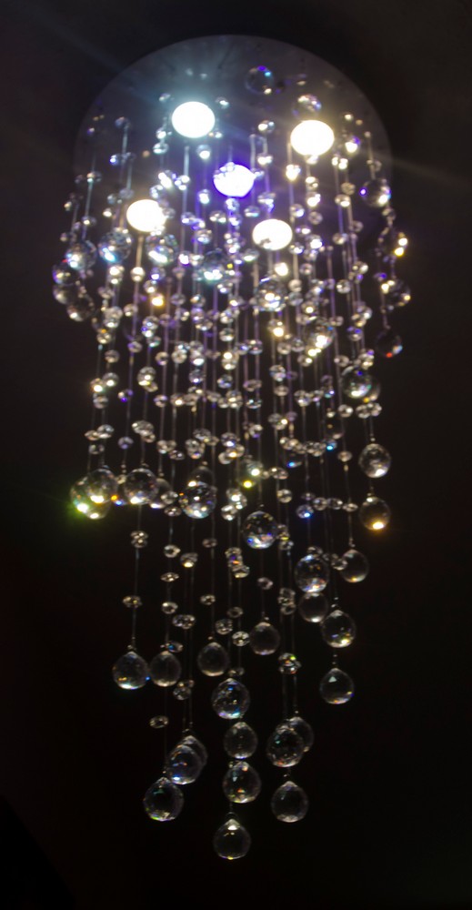

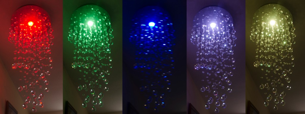

Top of stairs also colour changing Centre_bulb_colours.jpg it seems not to attract insects so much set to colour change, and with just centre lamp switched on it is enough to see up/down the stairs without waking wife if she has left bedroom door open. But normally use all bulbs DSC_6799.jpg which lights the stairs and landing well.
As you can see a fair few lights have smart controls, bulbs, switches, and relays, as to if useful or a gimmick is another story, the landing lights very handy with voice control when I arrive at bottom of stairs with a cup of coffee in each hand, it has reduced coffee spills. But else where rarely used, the remote control used for bedroom lights, but rarely use the app on phone, takes too long to select the app and use it, easier to use a wall switch.
