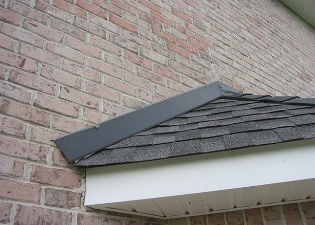

Given that it's only a couple of inches could you not extend the flashing to the next brick course and have it horizontal at the top, rather than either of the below? I would show a picture but I can't find one at present

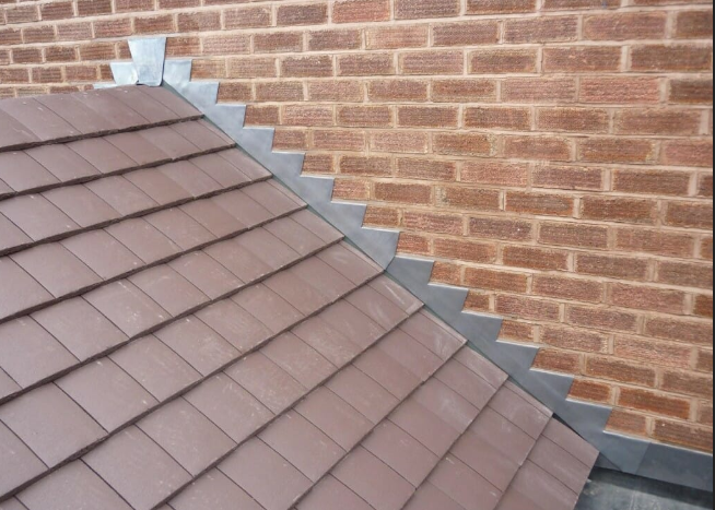

Personally I think that this:
looks a ton better than this:

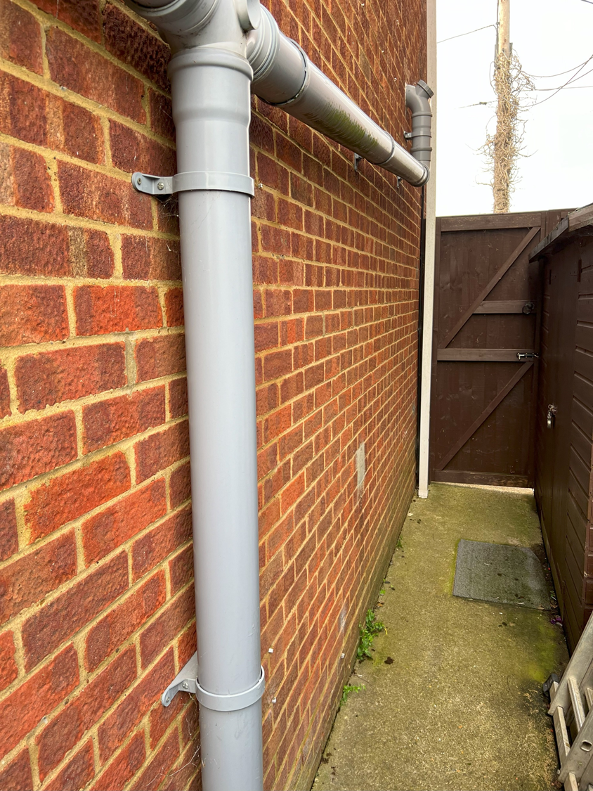

Thought a picture may help explain my current situation:
The shed is going in between the grey soil pipe and the gate on the other side. the current shed (top right) will be removed and the gate opening will move to that side.
One of the new shed uprights will be just inside the grey soil pipe and the other side will be where the gate is (past the white drain pipe).
The top of the shed will track the horizontal soil pipe and this picture should give you a good indication of the slope.
I would welcome any thoughts on this. Thanks for all the help so far.

Wow! - That makes everything crystal clear.
What were you planning re guttering? - In an ideal world the slope would be the complete opposite direction to hit your white downpipe
What shape shed were you proposing?

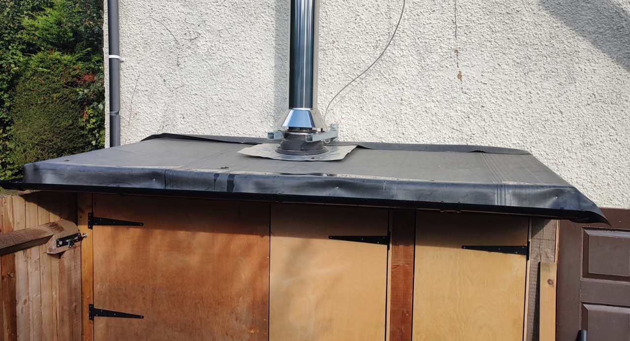

If you had a pent roof with a downsope away from theb house, you could encapsulate the soil pipe into your new shed. There are waterproof off-the-shelf shoes for the vertical and the horizontal would be covered by an overhang. With a downward slope you could then run mini-guttering round the corner to intercept the white downpipe.
This is exactly what I've done to accomodate a chimney. I'm re-rerendering, so nothing is final in this picture, but you get the idea

Box the soil pipe in above the shed.
Then you can have a straight run of flashing onto the box.
Cover the box with your EPDM (or whatever the shed roof is made out of.

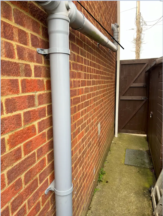

Can I please check, are you suggesting I put the roof here (black line)?
I hadn't considered this. This would give a me a straight roof and allow me to use flashing into the straight mortar line. This will mean that the roof has the white drain pipe going through it along with two lots of grey soil pipes. The upright soil pipe continues upwards and with this option, I will make the shed wider and finish it after this upright pipe. If I can reliably make these water tight, this would be an excellent solution. Thanks again!
Given how wide this will now become, I will probably have two sets of double doors to access different parts of this shed. I am using this for my tools and can organize them logically. The two sets of doors will allow me to easily access the shelving as this is is not very wide.
Should I be concerned that these sections of the pipe wont be accessible for maintenance. Is that an issue?
I would appreciate your comments on any of the above. Thanks again.
