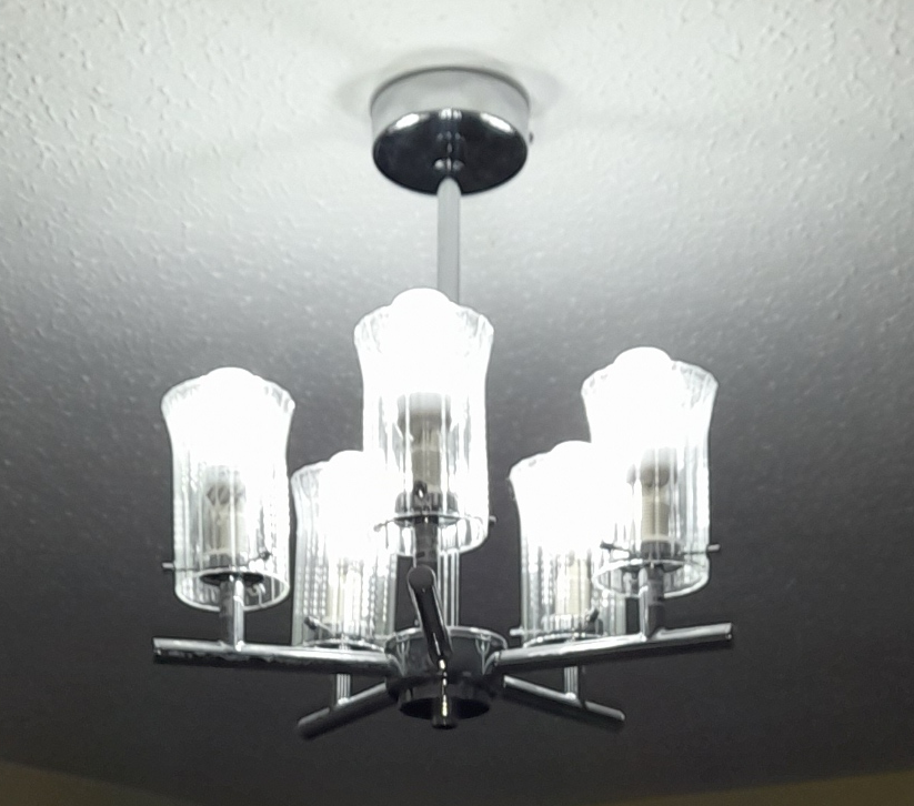

In my lounge we have a ceiling lighting unit with 5 spiral arms.
The G9 2.5W Led bulbs last no time all.
I fitted 5 new lamps 6 weeks ago, only 2 are now working.
They seem to flicker before finally failing.
Any ideas would be appreciated,........Thanks.

Have you tried without covers? And have you got SPD fitted? I have no proof a SPD is required, but it would depend where you live, the larger ones had a massive smoothing capacitor inside nearly as big as the whole of the old bulb.
Covers are open lattice work, so fully ventilated.
Surge protection in operation.

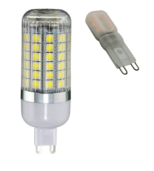

No details on bulbs
The type on the left in the first post #11 pic have lots of LEDs in series. The bulbs I've got have 75 LEDs apparently in series, so their total forward voltage is about 3 x 75 = 225V, hence with mains voltage applied they don't need much (if any) in the way of a voltage-dropper in series. I think the type on the right have fewer LEDs and a voltage-dropper capacitor. Using a capacitor can result in a current surge at power-up, which is a possible cause of the early demise of the bulb.
