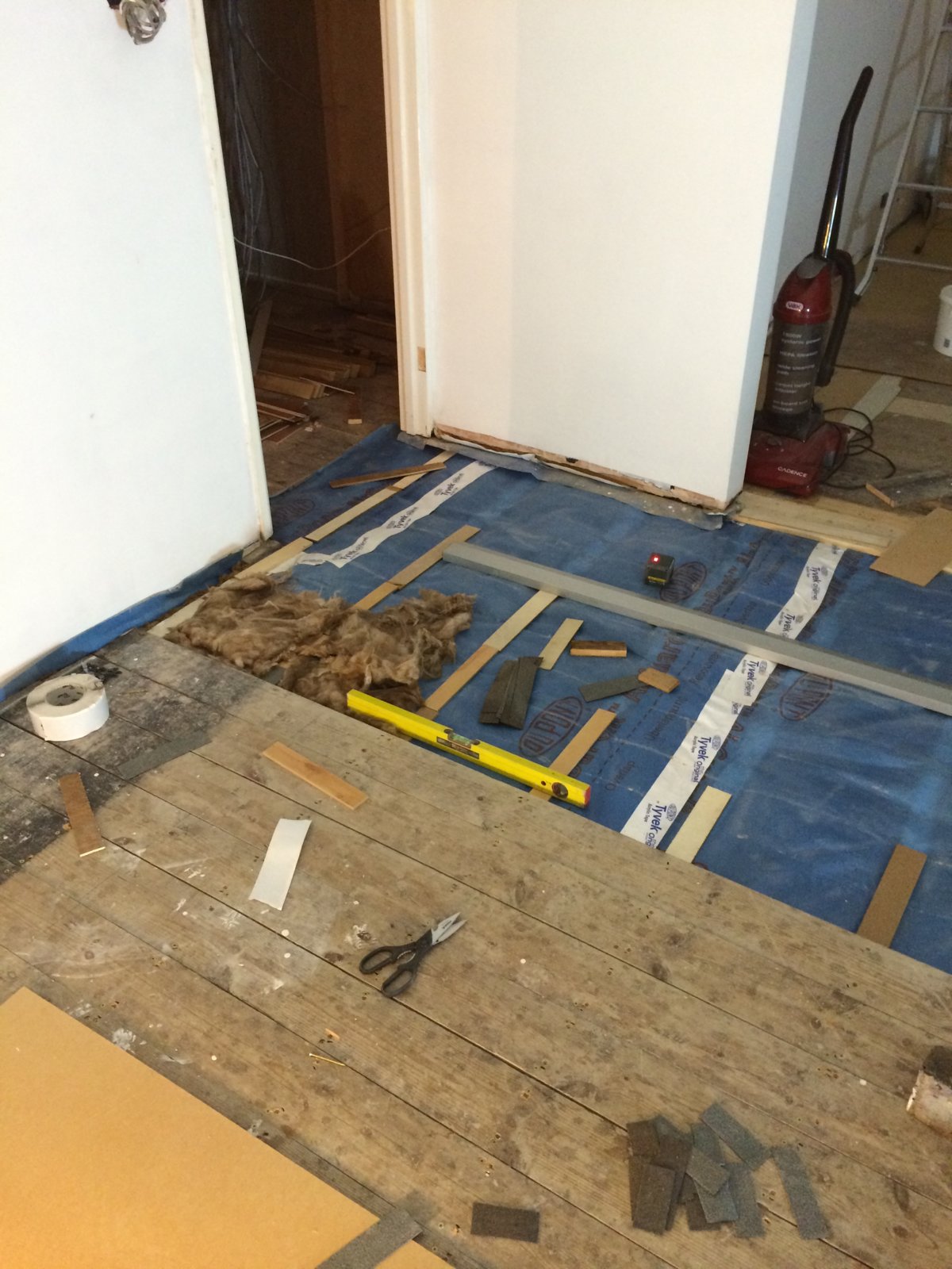

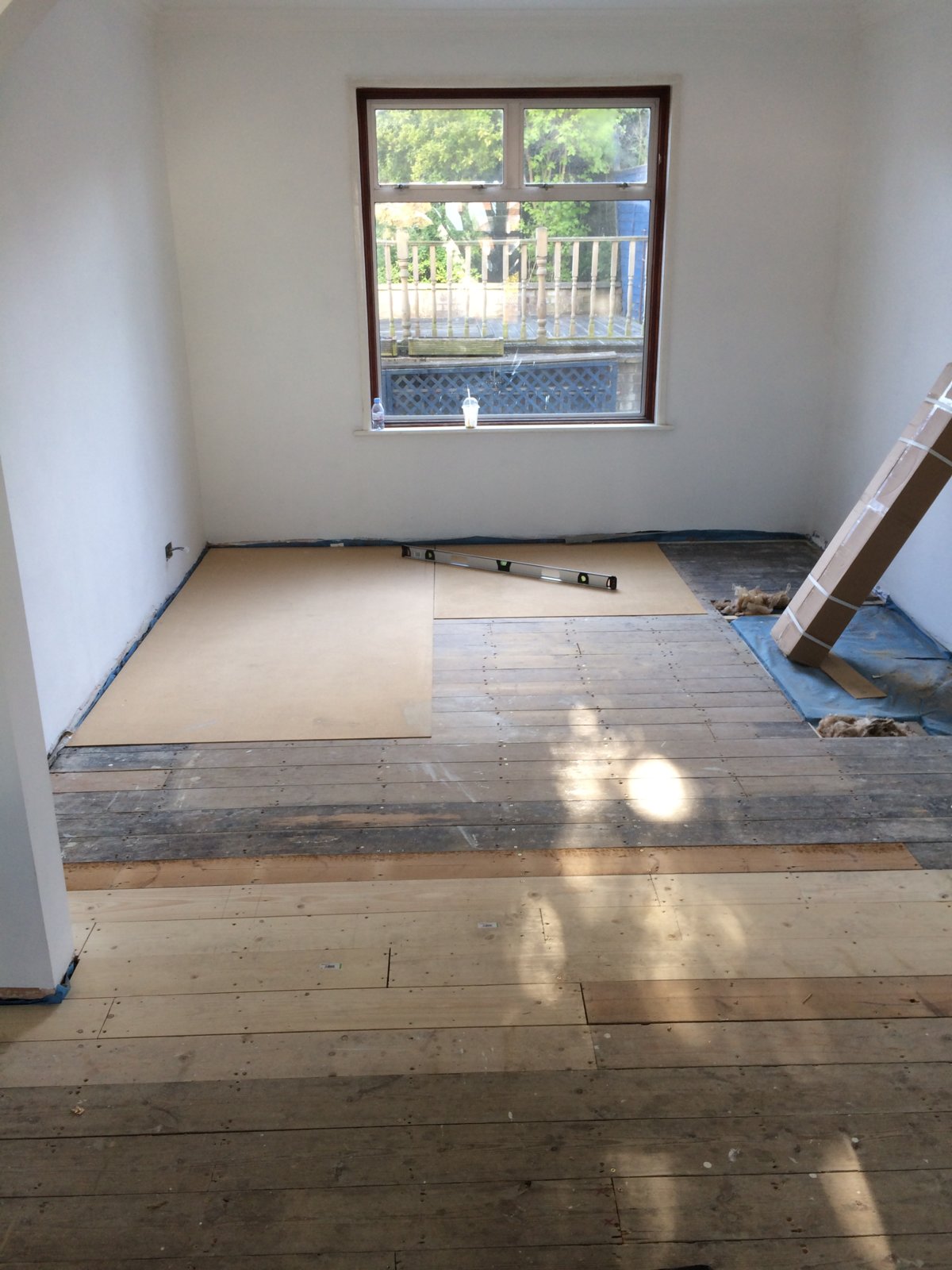

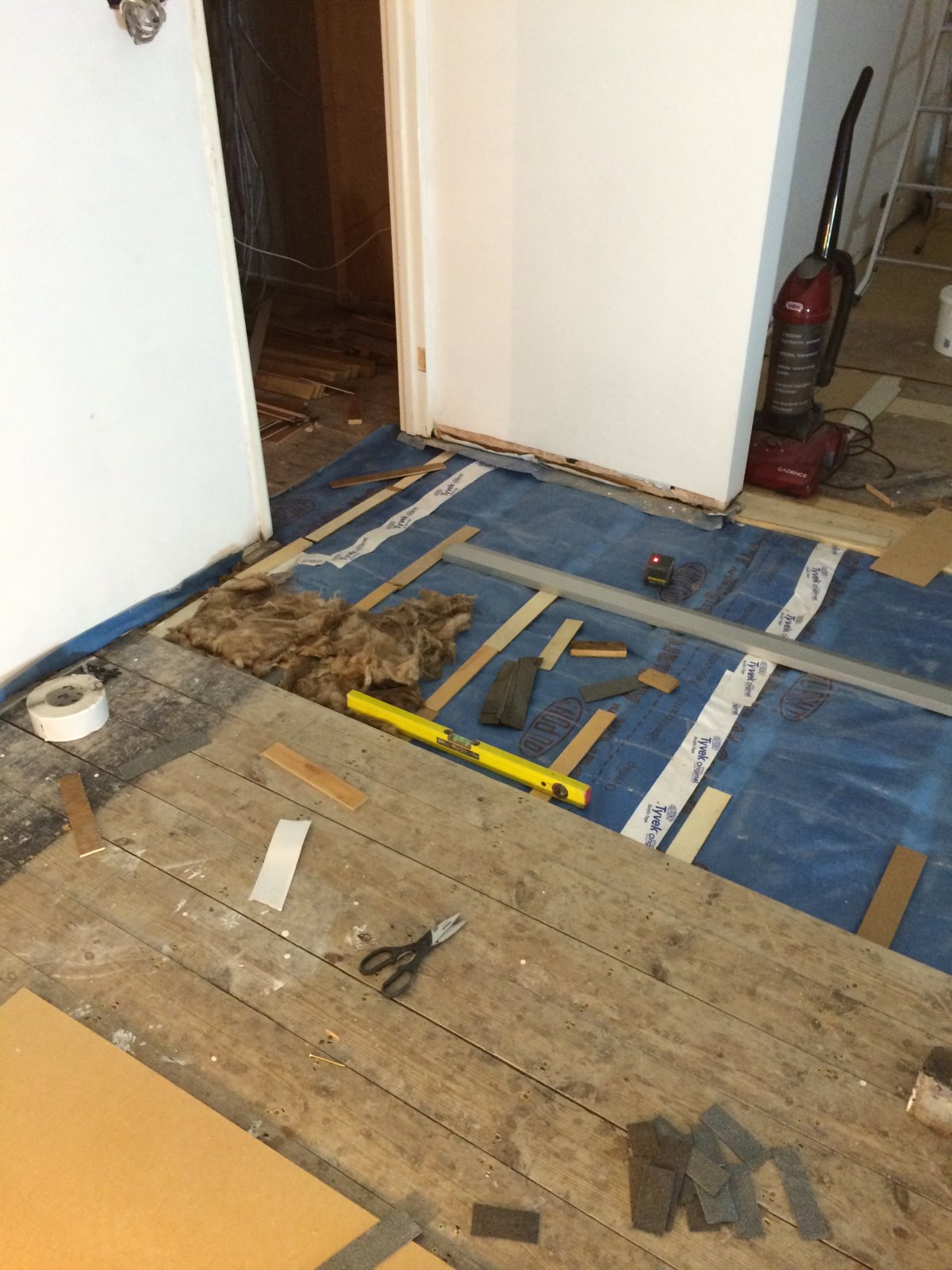

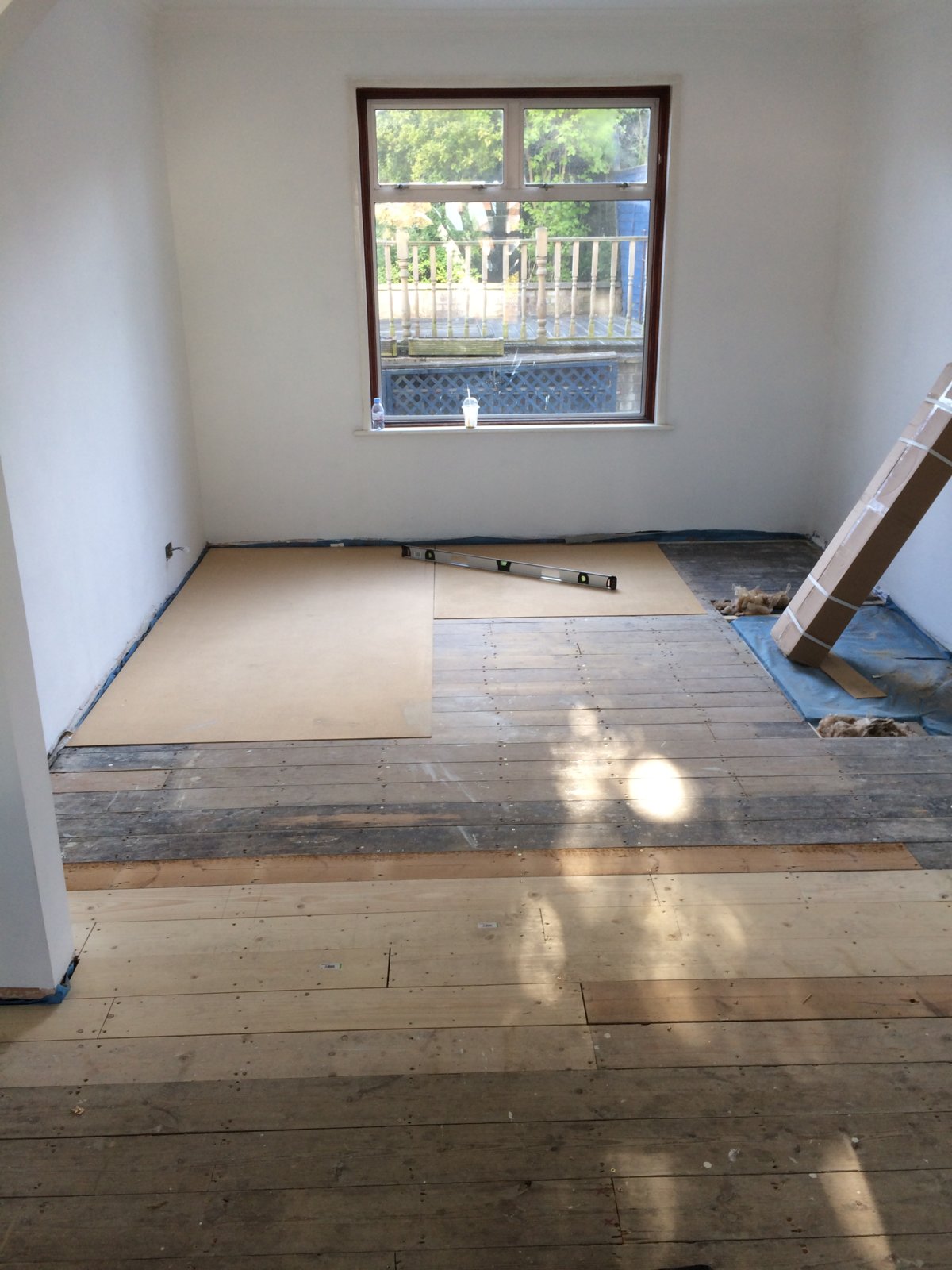

My 1930s house had unlevel floors. They were low at the sides of the room and high in the middle.
I ended up levelling my floor joists by tacking on shim cut from scrap wood. then putting the timber floorboards back in. This gave me a level floor to install over floor underfloor heating boards.
Attached are some photos. This was done about 5 yrs ago and I’m not yet aware of any problems :D (fingers crossed)
