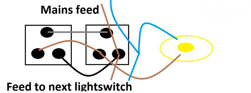

not new to electrics so this is somewhat confusing me, basically have a new build extension with lots of spot lights everywhere, myself and a mate are doing the electrics (hes a qualified sparky, im on a course to become one)
anyway, all first fix done, coming to do some of the second fix (mates on holiday atm :mad:) and the two way lighting is confusing me, i know how to do normal two way lighting with a switch wire. But, this wiring has been done with the live at the switch, maybe its because its gone 2am, and im trying to do this, but i cant work out how to :oops:
for arguments sake, back box one has, 2&E feed, 2&E to first spot, the 3&E to back box two, and this would be the only cable in the box
I know neutral from feed and spots go together, and would be live from feed in common, then live to spots in L1
Just not sure how i use the 3 core to get to the other switch, and for it to work

You use the 3 core & e to exactly connect all switch terminals to the other switch terminals.
So COM to COM.
L1 to L1
L2 to L2
The live then coonects to L1
The light to L2
Does that help?
must be another issue some where:/
have COM to COM
L1 to L1
L2 to L2
The feed live to L1
The light live to L2
doesn't work
dodgy drawing of how ive wired it
lights dont come on at all when wired to the switches. if i wire it "normally" then the switch works, its when i try to add the second switch that they wont come on.
Well could be :
1) That cable between the switches doesn't come out at the switch you think it does.
Are there any other 3 core and E cables about ?
2) switch broken. (unlikely)
memster
cockneykids diagram is not correct.
Your diagram with the fried egg is correct so there must be something else wrong.
memster

i said that to a m8 of mine when i was drawing it XD still not got hold of my sparky mate, how dare he be on holiday when i need to sort summit lol
AndyPRK
Theres a lot, to say the least each switch is a 3g with virtually all of them being 2wayed, but this one was labeled sitting room 2 way. ill get the multi meter out for a check
its the same 3C&E in one box as in the other, and they are brand new switches. really confused now :(
is it worth trying cockneykids diagram?
Scrap that, just been told by my mate what ive done is right(the egg pic), he doesn't know why its not working, so hes gonna bring his tester round tomorrow :D
Update, doesnt make any sense but still; it is now working, disconnected everything at the main switch, reconnected em all. and now it works.
