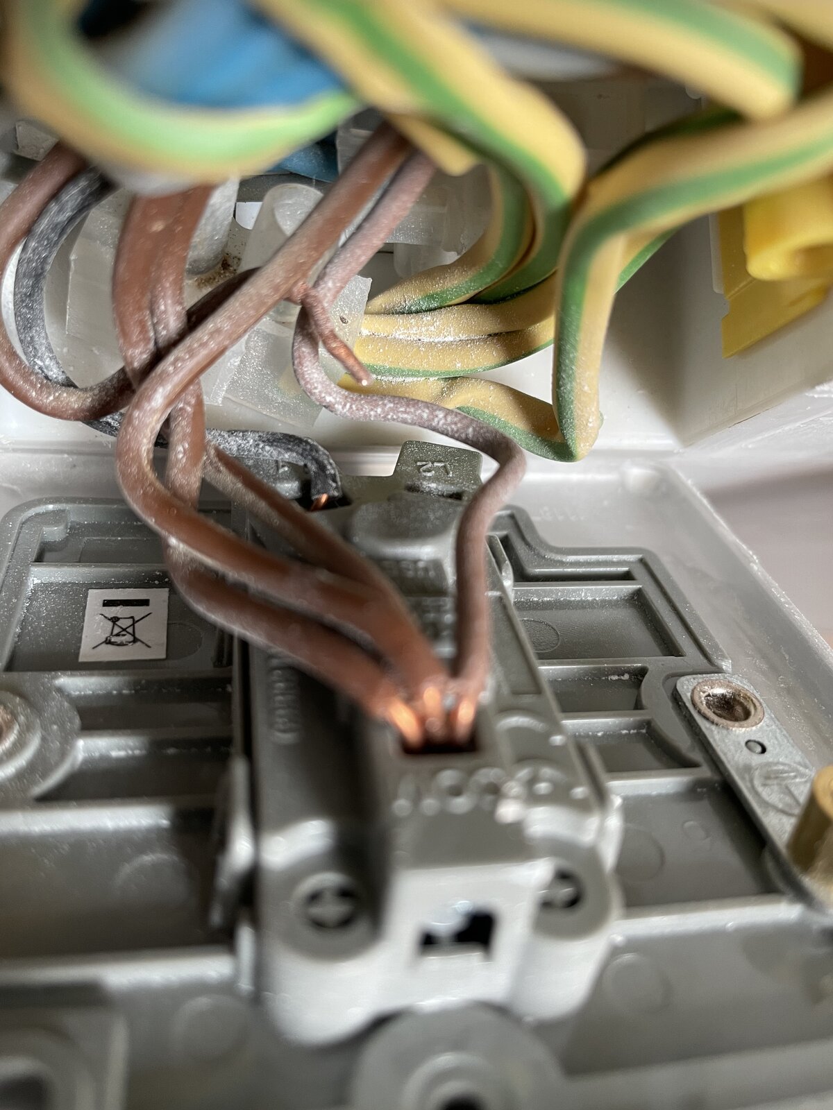

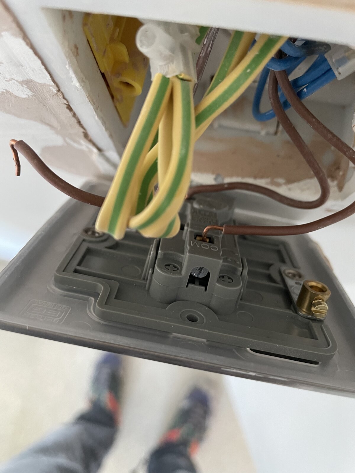

I just unscrewed a few metal faced light switches to paint some walls (after turning off the circuit) and it looks like some wires have come loose, even though I was pretty gentle. The first pic, there is a brown cable near the bottom of the switch, and the second pic there is a loose brown and the top brown cable isn’t properly secured either. Also, despite there being a screw to earth the face plate the earths are’t connected to it. I am not familiar with electrics and am not sure how to wire these up properly. What should I do?

The earth wires must be connected to the faceplate earth terminal.
I would think that in the first picture the loose wire goes in the switch bottom terminal, and
in the second picture the loose wire goes in the top terminal with the other wire
so that both switches are wired the same.
If I am wrong nothing dangerous will happen, the switches just will not work as they should.
Mark the wires first so that they do not get mixed up.

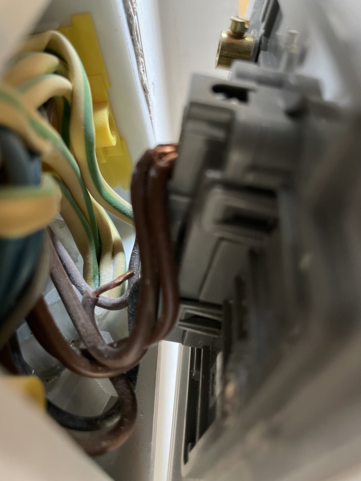

So does the loose wire here go in the free connection to the right? Its marked L2 ( I’m guessing it doesnt go in the same connection as the black)

Well, probably, try it - but
I hadn't realised from the previous picture that there were so many wires.
It is an unusual wiring and colour arrangement so I don't know what it is supposed to do.
Does this switch operate a light also operated by another switch?
it operates several led downlights and a bathroom extractor, but there is only one switch that operates them, there is an isolator for the fan though
In that case, I would think the loose Brown goes in with the Black.
