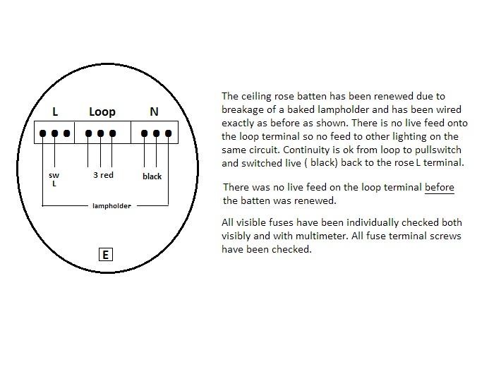

3 light fittings at my sisters house have no Live feed. An attempt to renew a bulb has resulted in breakage of a baked batten bayonet bulb holder and I have gone there to renew it but find that there is no Live on the loop which has 3 red wires. Assuming a blown fuse, I have checked all visible fuses and terminal screws visibly and with continuity test. All are ok, so where can the break in the live be - any suggestions ?
Somewhere between the last position which is working and the first one which is not.
Hopefully it's a simple case of a conductor having come loose in that last light/rose (or an idiot breaking continuity when installing a light with only 3 terminals), and not actually a break in a cable somewhere.

3: Above the ceiling is an outside flat roof. I have no idea of the cable
routing -
(1) + (3) = bad news, I'm afraid.
Check each light position to see if the loop conductor has come adrift, but if you don't find it then you've got a major job on your hands..... :(

Used multimeter for testing, not neon screwdriver.
The property has a kitchen extension with separate fusebox but the failed lighting is in the old part of the house where a shower room has been installed replacing a pantry or something.

The house is about 50 years overdue for a rewire, the main part having old fabric covered wiring and huge china fuse carriers. There are some flush 13A sockets fed from 5A lighting circuit, A nightmare scenario and difficult to diagnose problems. Would be immediately condemned if subjected to a safety inspection - huge fire risk!
If you have 13A sockets on a 5A circuit, could your lighting come off those and there be a loose wire not in a rose or JB but a socket?
Could the socket fuse have gone, esp. with it being 5A, taking the lighting with it?
Are all 3 fittings that are dead in the same part of the building or extension?
