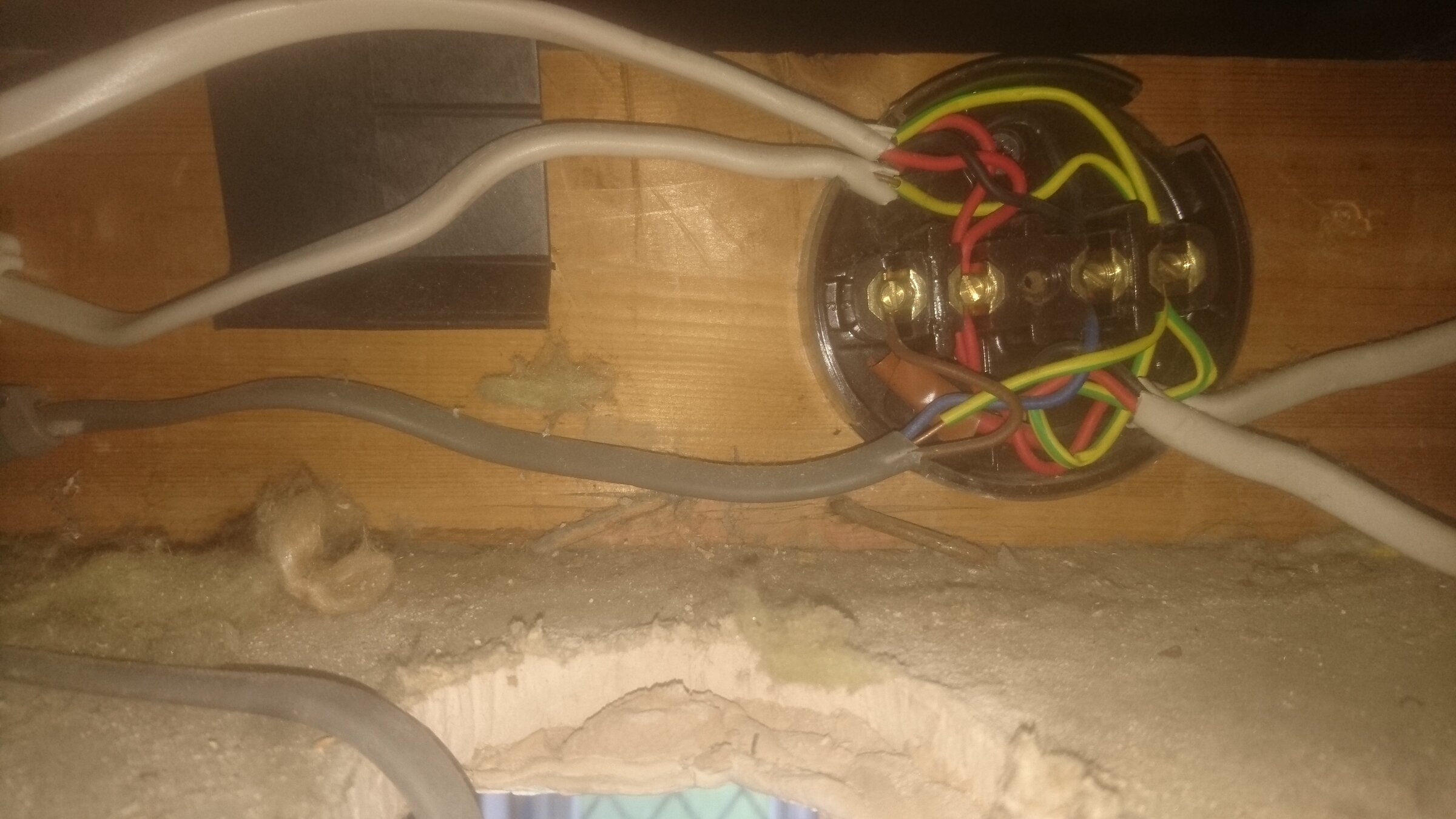

Currently redoing my bathroom and have ripped out all the old hardware/fttings etc.
The junction box in the loft which supplies the ceiling light has additional length of cable which fed a shaving socket(lower cable on the top left)
If i wanted to add a set of additional under wall unit lights controlled off a separate switch from the main light and also keep the feed that was used for the shaving plug to power an illuminated mirror.
Would it be case of wiring in another junction box as described in the electrics guide?
Is there anything else that would need doing?
You don’t need an additional junction box. simply cable the permanent LN&E to the new switch and another cable to the new lights.
Wire it like this. Ignore the cable marked “supply to next light”
It is considered that more than three wires in a terminal can result in a poor connection, so for example one spur from a socket on a ring, however there is no rule that says you can't have 10 wires in same terminal.

I would have thought that the more wires there were in a terminal, the more likely they are to be squashed together satisfactorily.
For example, if you only had two then bending each one double would result in four and better fill the terminal.

Must be protected by an RCD and a Minor works cert issued
