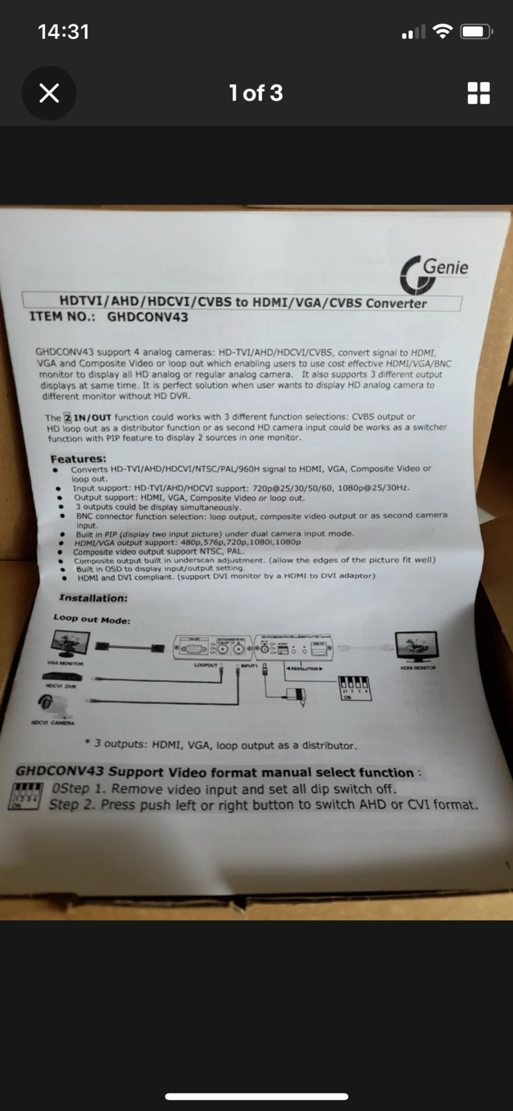

You can get hd cctv to hdmi converter
Eg
