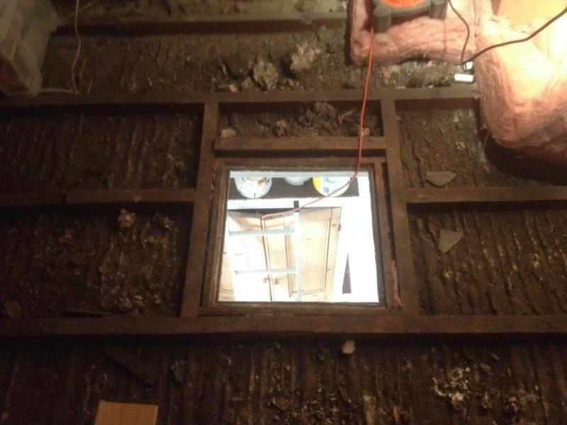

Below is a picture of my current loft hatch. I have a new larger hatch to fit.
I'm planning on having the new hatch run like this so as not to cut through another joist:
This means I'm just shortening the existing cut joist.
Just wanted a second opinion that I'm doing the right thing?
Thanks!
Yes, that should do but frame around the new opening similar to the framing around the old hatch.
You might also sister joists to the long joists on either side - the sistered joists dont have to run the full length of the in-place joists.
Pilot holes and Screw everything - no nailing.
I presume that you are not extending the opening above say a stairwell?
In other words, that its safely accessible?
Thanks of the reply!
Good point! Having marked the new hole on the other side of the ceiling it overhangs the stairwell considerably so I think I need to rethink.
I can put the hatch the other way round like this:
But this cuts a second joist and I though this was a non starter.
The other alternative is to abandon enlarging this hole and make a new one in one of the rooms but I really would prefer to use the existing hole if possible.
