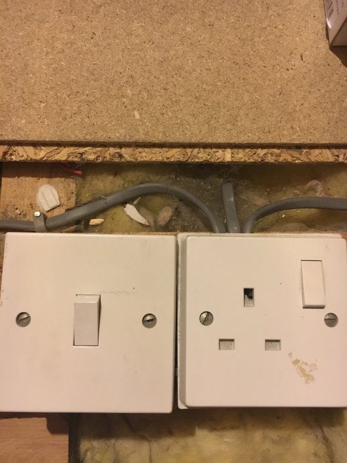

Went in the loft the other day and just thought I'd check how the light switch was wired by the previous owners. There are two surface mounted boxes butted up next to each other, one is a single plug socket (never used it), and the other the single switch in question.
I was intrigued to find no visible wires going into the switch from any side nor underneath, only one going to the light itself. I managed to shine a torch down the tiny gap between both boxes and I can see two red wires going from the plug into the switch.
Now I know this is obviously not right, but how dangerous is this? I haven't opened the light switch to see if there is any fuse protection in there, I suspect not. The plug socket has 3 cables going into it, I am assuming it is connected to the upstairs socket ring but I've not yet checked this either.

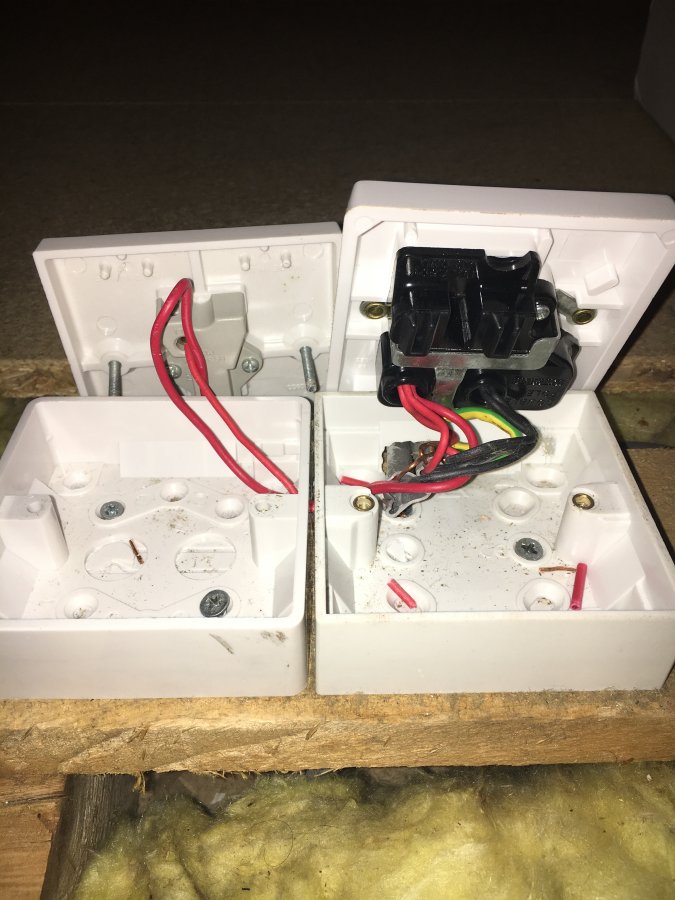

Ok finally got some pictures of this, see attached. The wire to the left coming out of the socket goes to the light. I've also checked and it is connected to the upstairs lighting circuit, not ring main.
So my questions are:
1) is the light switch safe?
2) is the socket safe to use? Not planning on using it but as it's on the lighting circuit what are he restrictions.

Once again you are using wrong terminology. It is a socket.
Don't plug a kettle into it. Or a fan heater.
The light switch is OK but the socket is best rewired on to a power circuit
The socket is safe except that if you plug in something that takes too much current it will trip the MCB and you'll be stuck in the loft in the dark.
The wiring seems OK to me; it looks as if the earths are connected. No doubt someone will spot something that could be done better!
