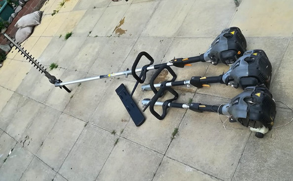

Hi,
I need to purchase a long reach hedge trimmer & 3 options available to me.
I am asking for your help / advice as to which i should get.
PHOTOS ATTACHED
Titan as per photo & seller said it runs but needs carb tuning,two others supplied as shown in photo.
Two Ryobi all working,one straight & one curved.
I need to cut a 8ft hedge which will include the top.
Please advise what i should do,thanks

You haven't said the prices, got a link to the ads?
If seller says carb needs tuning and knows that for certain, why doesn't he do it and command a higher price..
An adjustable head has advantages not just for the top of hedges/trees, but because you can stand away from the hedge and attack it from different angles.
I hired an adjustable 8 foot 2 stroke Stihl which was brilliant, but noted that if you can't see across the top of the hedge you won't get an accurate cut. The length of the head (600mm for the Stihl) also limits the depth of cut when cutting a hedge top at an angle.

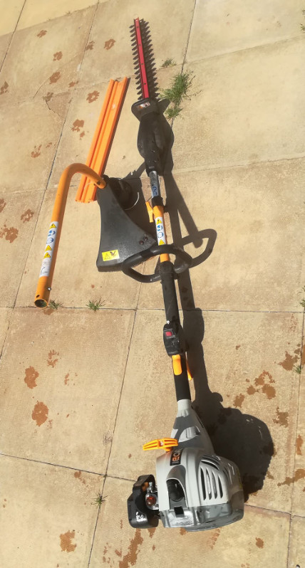

I see a straight shaft & bent shaft.
Which do you advise ?
Am I correct that the heads will not turn through 90 degrees like the Titon.
If not I won’t be able to cut the top of the hedge.
Looking at your pics, one cutter is straight and not adjustable, the other is.
Both have advantages, but in my opinion cutting the top of a high hedge isn’t as obviously simple as you might think - you cant see whats really happening and cutting through a thick branch isnt so easy either.
Give me a pair of steps or a ladder every time, if possible!
If I had to choose between one or the other it would be the adjustable machine, and it would spend much of its working life in the straight position anyway.
You need to make sure the bevel gear mechanism gets regular greasing, similarly the mechanism within the sole plate.
