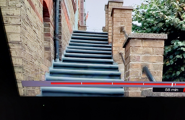

I was watching a Homes Under the Hammer last night. One of the properties featured was an old upstairs flat with external stairs to reach it. Hopefully the pics do it justice, it was quite a height. I noticed the staircase only had two metal balusters running at the same angle as the staircase, one near the top, one near the bottom, meaning a gap between. I couldn't quite believe, given the height, there wasn't at least another baluster between the existing two, or maybe some vertical ones to block the opening off.
Surely in its current form, a toddler could quite easily reach through the gap and then ...
Is it a case of 'that would never be passed today but because it's existing, it's okay' ?

Isn't it the case that BR are not retrospective? Think of all the farmhouses converted from longhouses which had and and still have stone external, unguarded stairs...

Take a closer look, there's nothing historic about that staircase.

Why do some folk on this forum insist on reimagining what people ask? It's almost as if some are desperate to start an argument when that's not the intention of the OP. I'm not suggesting every historic property is updated to current standards. It simply struck me that it's quite exposed. And I wonder if the local council would have anything to say if the new owner intends to rent it out, given all the hoops landlords need to jump through these days to comply with various legislation.
Yeah I did wonder about that. If it has been rebuilt in the relatively recent past, why didn't they slap a middle railing in to close it off a bit more.
Haven't looked but isn't there a "100mm ball" regulation? Inside or out, afaikr. Which vast numbers of houses don't conform to.
Yes A 100mm sphere must not pass through any gap. Height of handrail, balusters, spindles, treads, risers, min headroom, max pitch etc, are all regulated for the installation of NEW stairs.
