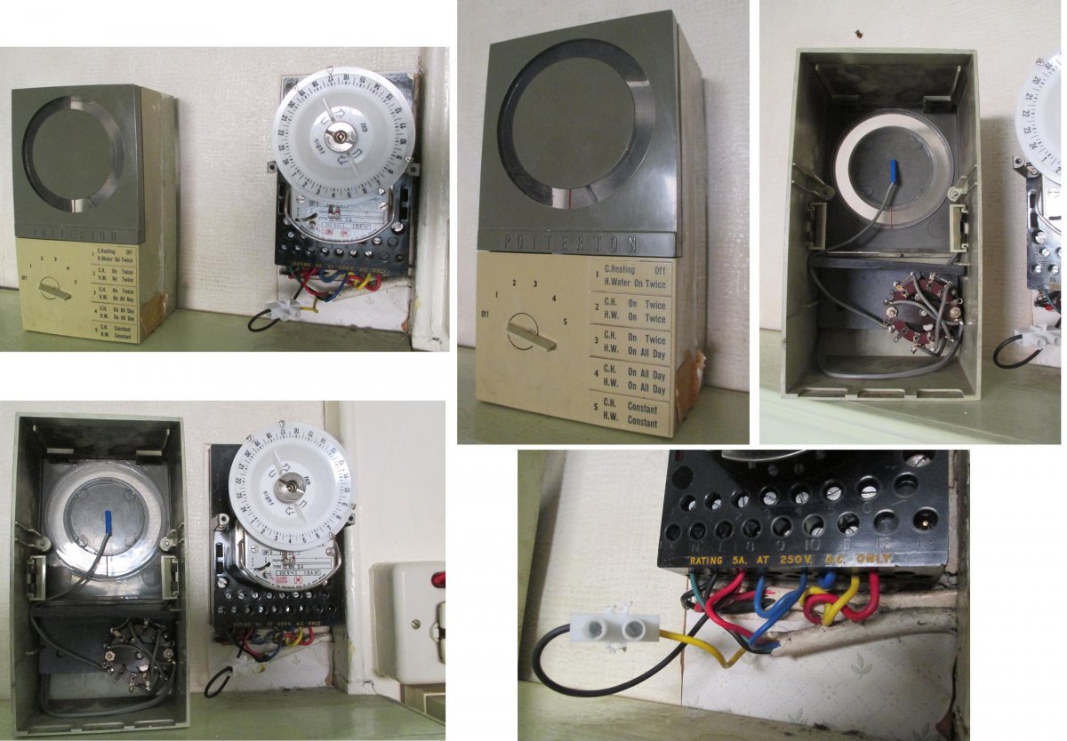

Hi all,
any advice on a replacement for this old Potterton programmer. This is for a gravity feed Boiler (Potterton Kingfisher 2), cylinder and single room thermostat set up.

Any good engineer will be able to make things work with that but you should seriously consider upgrading your system to incorporate proper controls if you are changing this.
Jon
Any single channel clock from horstman , danfoss or siemens honeywell will do it or the own brand plumbcentre one is rebadged honeywell . Basic rewire job
