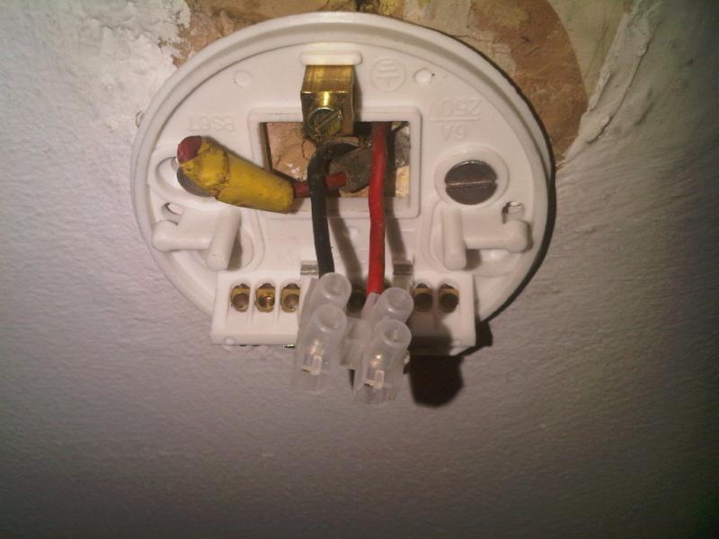

The wiring has been paired off for illustration purposes

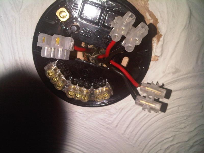

s/bed1 - 4 lots of cabling. Switch cable marked with red tape. One cable only has one red wire and no black wire.
s/bed1 - 3 lots of cabling paired off.

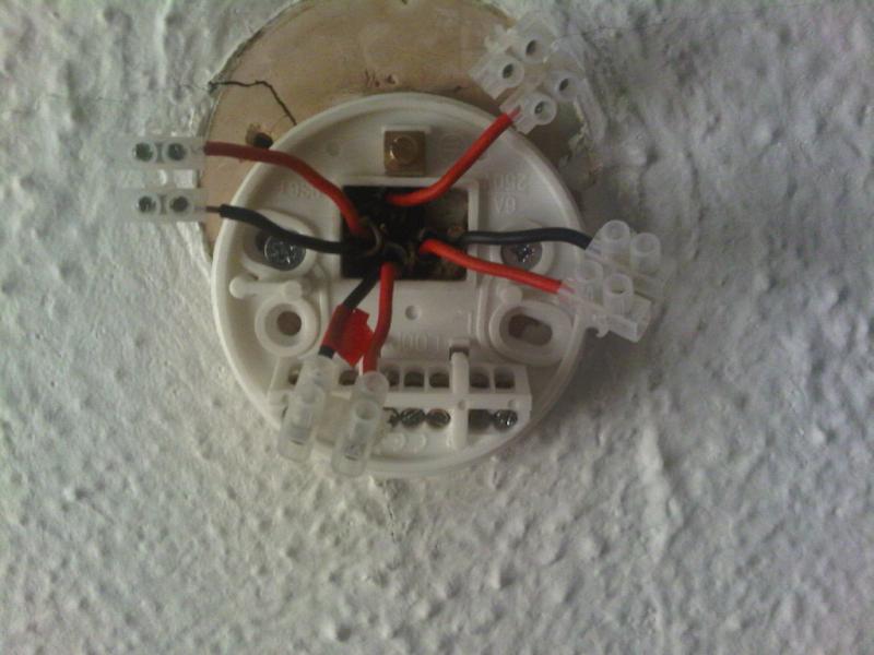

Landing - 1 set of cabling. The wiring here was straight into a block as shown. Note the red wire bent over and taped off. This was already like this and not touched by myself.
Well it all looks relatively basic. In your first photo I would expect all reds to go together in the loop terminals (you'll have to double up on one of the terminals). The black marked with red tape will need to go to one of the two terminals on the right, and the neutrals into the left set of terminals.
In the second picture you'll need to identify the cable that goes to the switch and then wire as per above, minus the extra red.
In the third picture the red and black need to go to the far left and far right terminals. The taped up red should probably stay that way.
It might be a good idea to check that the taped up red doesn't actually end up in the rose in your first picture, as if it does, it would be better not to be connected rather than remaining live but isolated with tape.
P.S. I'm pretty sure I can see some earths twisted together in the ceiling above the rose.
